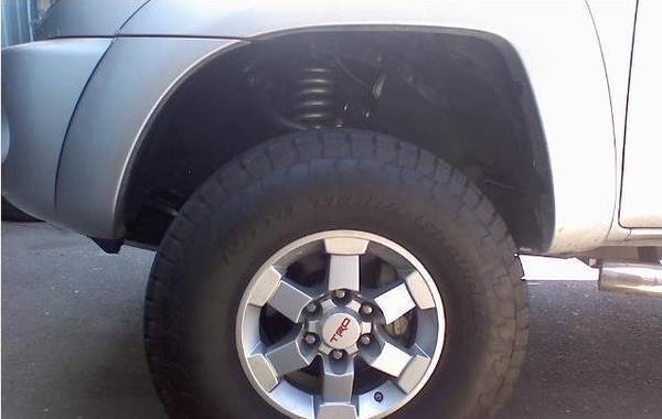

    886 + top plate spacer? wow unless those coils are sagged, I would think that's almost at 4" no?
    This was my truck (granted before armor) with 886s + top plate spacer
    busted a CV boot ON ROAD with that set up. I took off the top plate spacer, added a bunch of armor and winch, and I'm still at 3"

    wow how did the truck drop 1/2" after just adding 135lbs to the ceterline of the truck??? i have the 885's on mine and they didnt budge with all the skids on it? did you add the bumper at the same time?

    maybe its me but something doesnt seem right about 135 lbs dropping the front of an 886 supported truck. esp when the weight wouldnt be solely on the front end. or am i mistaken?

    btw MJonAgs32 did you paint the coils in that pic?

    yeah painted them silver

    thats what i thought. had me thrown off for a second when you said they were 886's but then i thought "he must've painted them"
