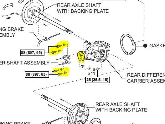

    Here is a pic, there are 4 bolts that hold the driveshaft to the rear axle. Remove these 4 bolts and hang the driveshaft with rope or something, i think they're 14mm. This will disconnect the rear axle from the transmission and allow it to Roll, so someone can pull you out.

    05tacoma4x4
    What about just forcing it . Brut force? Or disconnect the shifting cable under the truck like the mechanic was talking about .? Woild this work as well? Im just not much of a mechanic most i can do it jumpstart a car usually. Im afraid with a axle I'd make it worse.

    2008 dcsb trd offroad 4wd
    Other shit sounds harder than pulling the shaft
