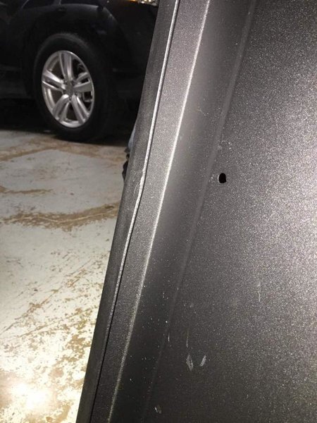

    Clearly powder coating was a waste of money. Got another dent in the front edge. ImageUploadedByTapatalk1419098136.018084.jpg

    A hammer, a block of wood and a pair of really big Chanel Locs appear to have gotten things pretty straight. I tried to protect the coating but the bend was too bad on the corners.

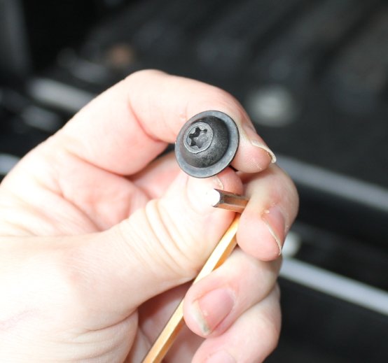

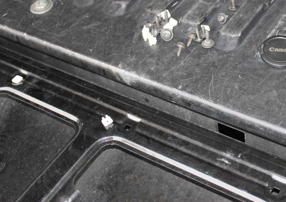

    Okay, I got my plate on yesterday, and came across something odd that I don't recall anyone else mentioning before. I decided to forgo putting the plastic cover back on over the reinforcement plate because I remembered someone else mentioning that they had to get longer bolts to do that.

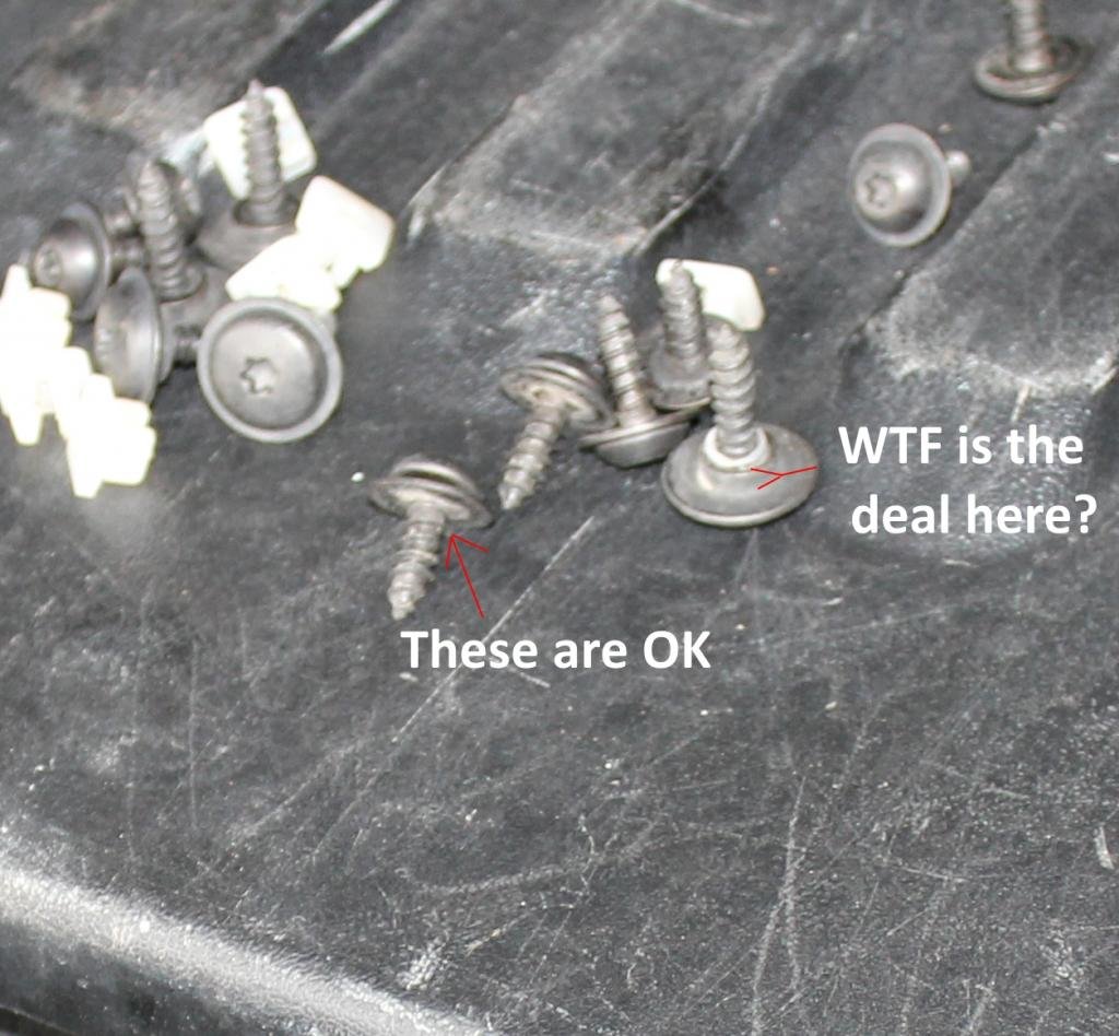

    My problem is that 7 out of the, what, 16 or 18 bolts are different from the rest of them, and have a built in "bushing" that raises it off the surface of the damn plate, so they won't screw down flush. I took a couple of pictures of the plastic clips that I removed from my old tailgate before I popped them into the new one, and cropped out a section so you can see my problem. I ended up putting these PITA bolts on the upper part of the plate near one of the bends until I can get replacements. They stick out enough that I'd be afraid of hurting my dogs' feet or whatever else I try to load in there. It's about a 1/8" or more rise. Anyone else encounter this? I imagine it has something to do with the plastic cover that this plate is replacing, but I'll be damned if I can figure out why they did it.
    Also, these plastic clips are not all that terribly stout. After I stripped the first one out replacing the bolts, I was more than a little nervous about the rest of them. Be careful not to bear down very hard.
    I didn't have this "star" type pattern handy anywhere, but a 4mm allen wrench worked great. Maybe that's what it was meant to take. What the hell do I know.
    I didn't end up having to take off those two screws on the top edge of the tailgate after all. Nearly all of the screw holes lined up when I put the plate on, and so I just left those two, that gave others so much trouble, alone.

    Same here. BTW you never want to screw down the screw with those plastic clips. They are not designed for that much torque. I just hand tighten them down til its tight.
