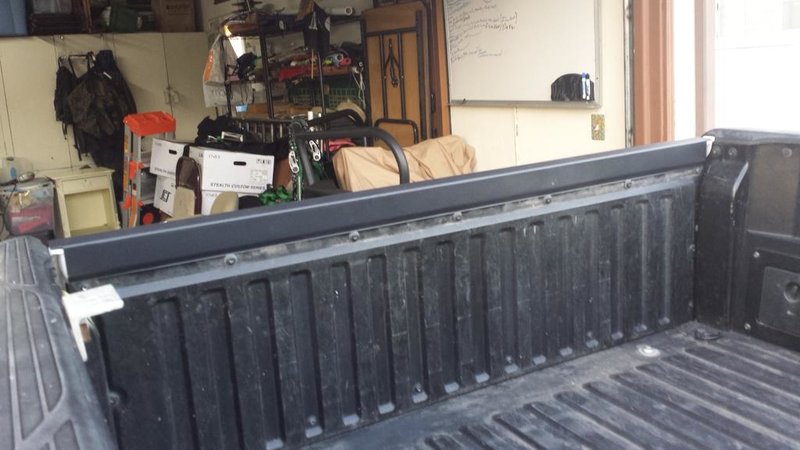

    Finally got around to installing the reinforcement I ordered (aluminum/powder coated). No problems. Fit like a glove. Put two strips of weather-stripping, one on top of the tailgate and another on the inside top edge of the gate. Reinstalled the OEM cover over the new one. Enlarged the holes that run along the top edge of the OEM cover so the torx heads fit flush. Used a dremmel tool to cut down the bump stops on either side of the bed and the gate closes nice and snug. Great product. Thanks Guy!!!!!
