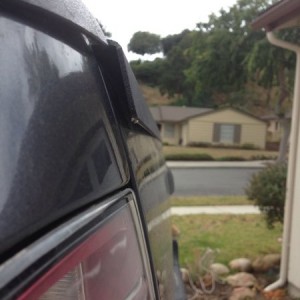

    Got mine installed today. Finished product here. Looks so sharp![​IMG] Crazy how light it is (aluminum) but still offers great strength. Only way to install it is to slide it on, helps to remove one of the cables attaching tailgate to bed. The top of my lip was already jacked from velcro residue baked in the sun so I opted not to protect the paint with any tape. It is a tight fit, as the middle center of the tailgate seems to bed a bit outwards. [​IMG]

    Great photos. My install was identical, with the exception of re-using the composite cover on top of the plate. I'll see if I can get some decent photos of how mine turned out. Been raining for the last two days...
