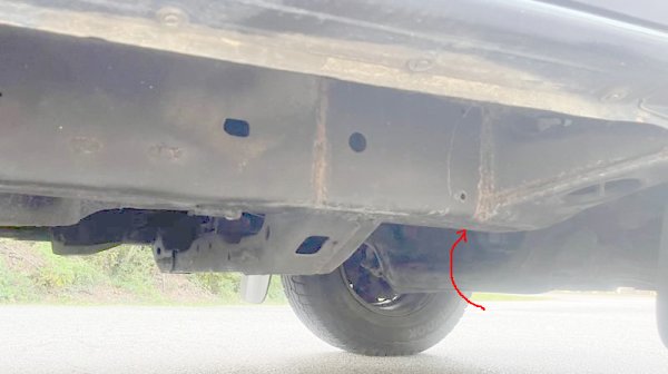

    the frame has clearly been undercoated as shown by the wiring being sprayed over and the underneath of the cab over sprayed black as well.
    The frame rust that IS visible has already come through the undercoating, which would make me run. $10k isn’t bad if the maintenance is up to date and you won’t have to wrench on it. If you do have to wrench on it, the headache of rusted nuts/bolts isn’t worth it to me.

    That frame doesn't look terrible, it looks pretty good for a 18YO tacoma, I've seen trucks with half that age getting new frames on here. That's a decent price for that rig if the rest of it's condition warrants, it'd sell quickly out here barring any serious issues. Stickers and that classic deal means nothing other then the dude wanted to dress up his tacoma a little. The dude could have loved his truck and babied it, stickers have zero bearing on how he treated it and that's what you should be concerned with. That weights the scale far far more then stickers which I'm surprised such a big deal is being made over, it's an 18YO $10K truck with low miles. I doubt that truck will last long if it's advertised.

    Another indication of how rusty the truck is - the exhaust has been replaced with the rusty cat being reused - welded into the new exhaust.

    If you moved from CA, then you are aware of how clean a vehicle's frame should be.
    Don't bother, get yourself a vehicle from CA/AZ when time permits.

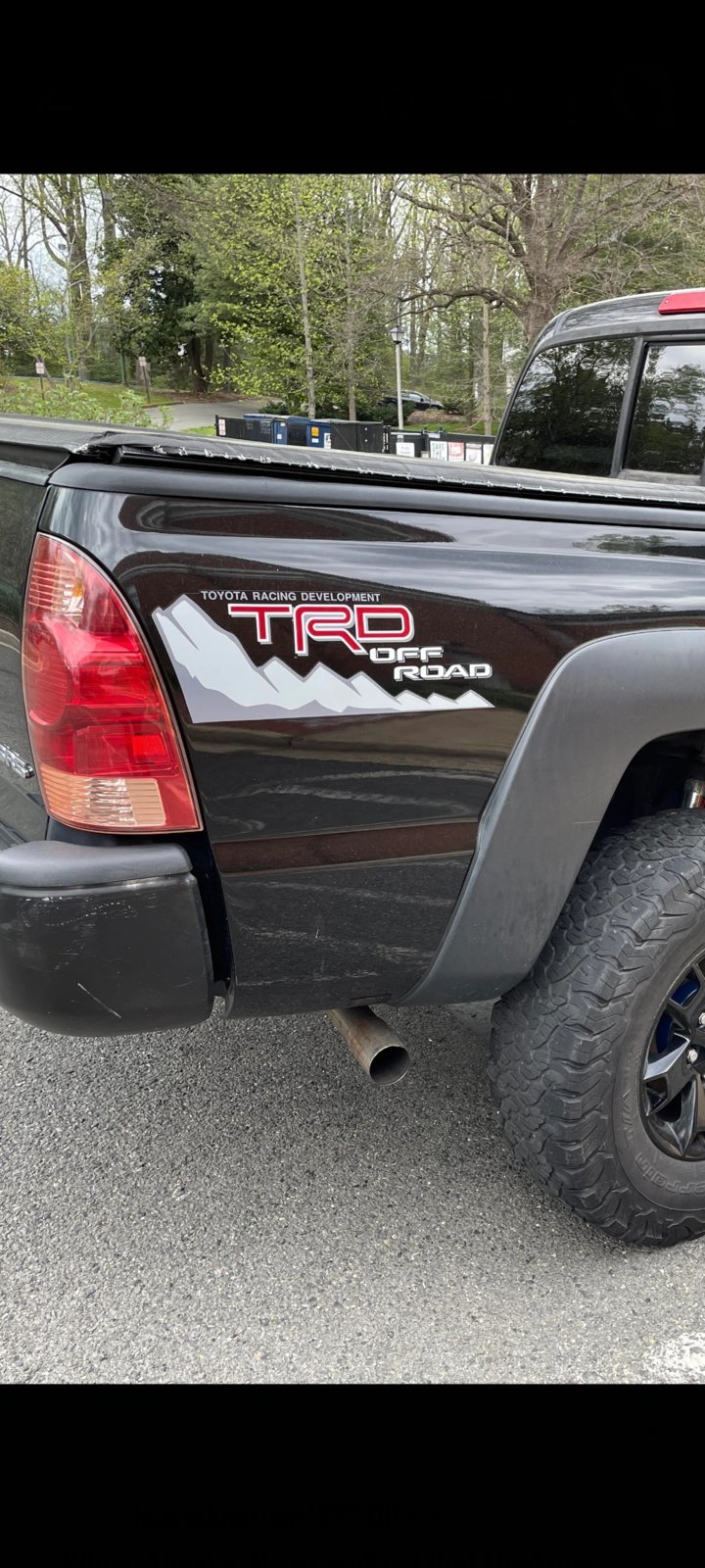

    Why is the seller dishonest, because he added some stickers? Serious question.
    I've not read where the OP mentioned the owner was dishonest. Adding stickers to your truck from another trim level hardly makes you dishonest, dishonest would be mis-representing it as having that trim level.

    I really wouldn’t pay attention to the stickers to be honest with you, it’s an 18 year old vehicle and somebody just found some stickers on Etsy or eBay or wherever and slapped him on the side because they thought they looked cool
    I don’t really see this as deceptive and someone trying to sell you something that it isn’t, since that thing doesn’t really exist anyway; there is no such thing as a sport off-road. Some peoples ideas of mods are stickers, it’s all they really know how to do.
    Good for you for doing your homework, make sure that what you’re buying is what you expect it to be, regardless of labels or stickers.
    Plus plus plus on the frame comments around suspicious looking rust.

    Looks like black paint, not thick enough to be the rubberized undercoating applied by dealers. The previous owner also painted the steel wheels and hub centers. It's an 18 year-old truck. Can't expect virgins here. The dented bumper and broken tail light indicate a truck that's been used as a truck. I see unrepaired dents on the tailgate and drive's side access door. I see an aftermarket rear exhaust pipe and muffler that'll probably rust out in a couple of years but can be replaced again cheaply. The frame looks to be in very good shape for its age. It's possible the frame was replaced under Toyota's campaign 10 years ago.
    @tacoman333 pay attention to the area around the cab mount, on both driver's and passenger sides, particularly on the inboard surface of the frame (facing the transmission). Frames tend to rust out there first due to a convergence of factors (road spray, many welds, water pooling inside frame). You'll likely find rust there, which is fine. Make sure there are no rust holes (beyond tooling holes from the factory!).
    @0xDEADBEEF you can see the transfer case bump in the above picture. No crossover pipe because it's a 4-cyl.

    The truck is 18 years old. That's a long time-line for things to get added or changed. The stickers aren't original of course, but they could have been added by a previous owner. Ask the seller if the stickers were on the truck when he bought it or did he add them? The answer or reaction will tell you a lot. You already know only the 4x4 sticker conveys correct information. It has a nice set of features on it including the Access Cab and the long-wheelbase 6' bed and the stick.

    Frame looks good. Smack it with a hammer by the cats

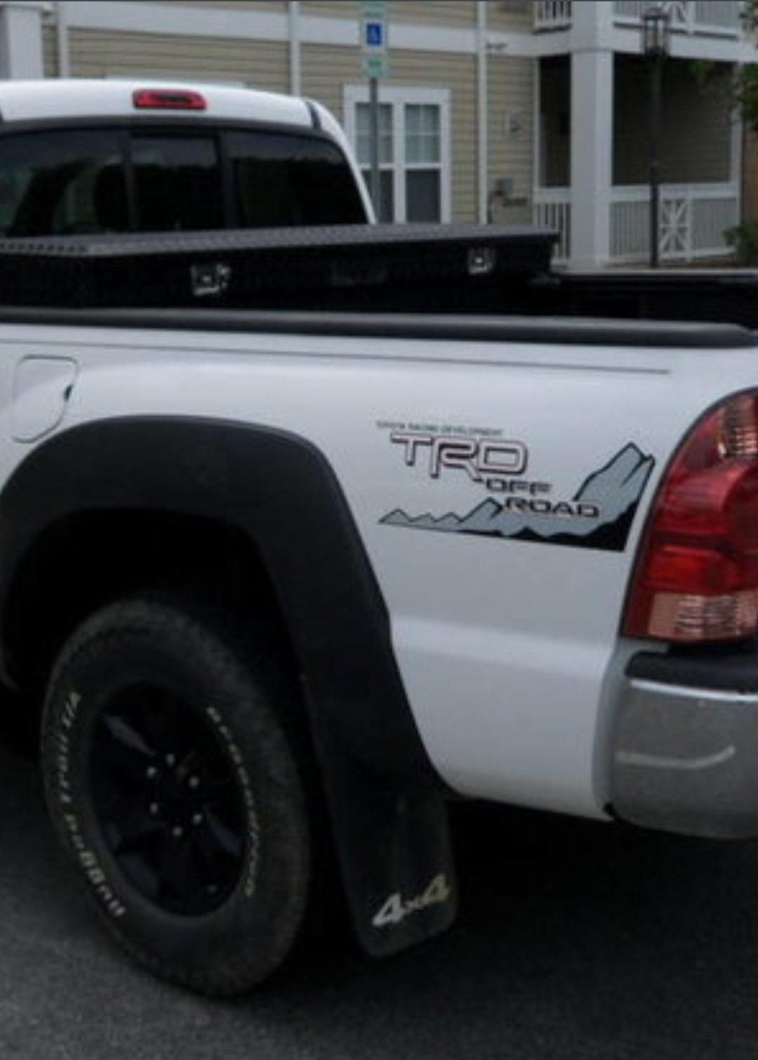

    Once upon a time, Toyota did have a regional package called the Rugged Trail where they did slap mountain decals on the bedside of the 4x4 base package, but the ones on yours are clearly custom fakes.
