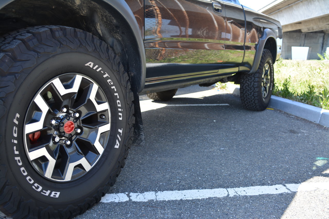

    You mean like this?

    3rd Gen wheels fit too.
    D0D86196-7B2F-43DF-B4F2-32C9E0B2F573.jpg BB963A92-329D-4186-9198-935C13740B3D.jpg

    Yes just like that! What size rubber are you guys running?

    2nd and 3rd gen wheels have less backspacing than the 1st gen does so you may encounter rubbing. I’m running LT265/75R16 BFG KO2’s and my tires rub the upper control arm at full lock.

    Like others said very close to uca. Spacers for sure.

    Spacers made my rubbing worse actually. At 1.25 I rubbed the mud flaps. At 1.75 I rubbed the frame... badly.

    Sounds like too much tire, not enough lift. There are also the spacers that slide over the studs. They defeat the hub centric on the wheel though. Also depends on the truck. My 03 rubbed the frame with 265/ 70s but my 02 no rubbing 265/75s both stock suspension and wheels

    I have a 2.5” lift and new SPC upper control arms going in so hopefully that gets rid of the rubbing. It just barely barely rubs it, and you only notice it when you’re turning hard or parking in tight spaces.

    BFG KO2 LT265/75R16
