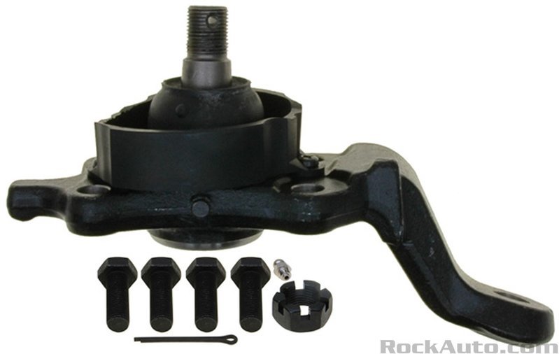

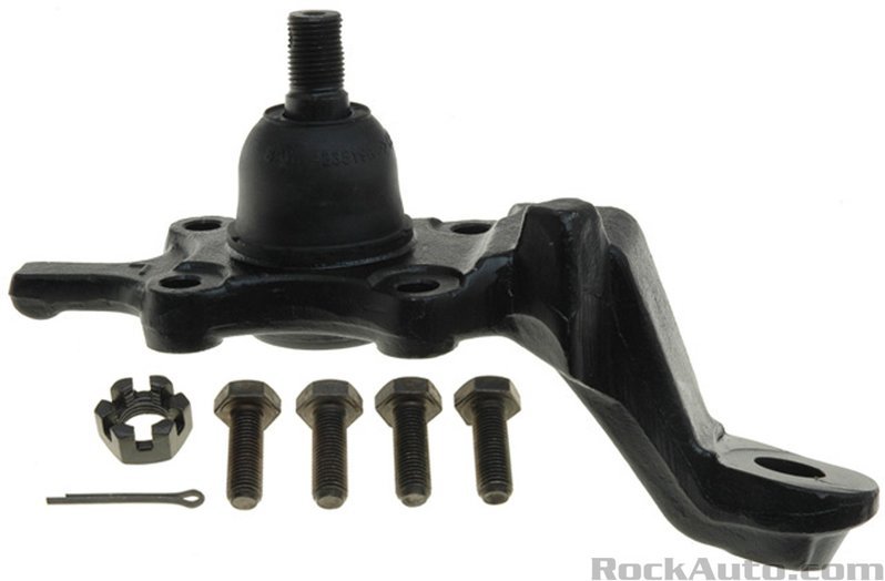

    Ok i'm scratchin my head on this one. It looks like I have 05 Tundra lower ball joints on my 04 Tacoma. Anyone ever heard of this? I do have 240K on original ball joints with a little bit of play.
    Here is what mine look like:
    Here is what i recieved for replacements AC Delco pro's
    I don't care to tear it apart and have wrong joints.
    What do your's look like?

    Wow, that's the first I've heard of this. They appear very close. Pics I've seen are the second pic.

    The top picture has a protective cover. Some trucks have it and some don't. My truck did not it, nor did my oem replacements.

    Also the second joint picture s looks correct.

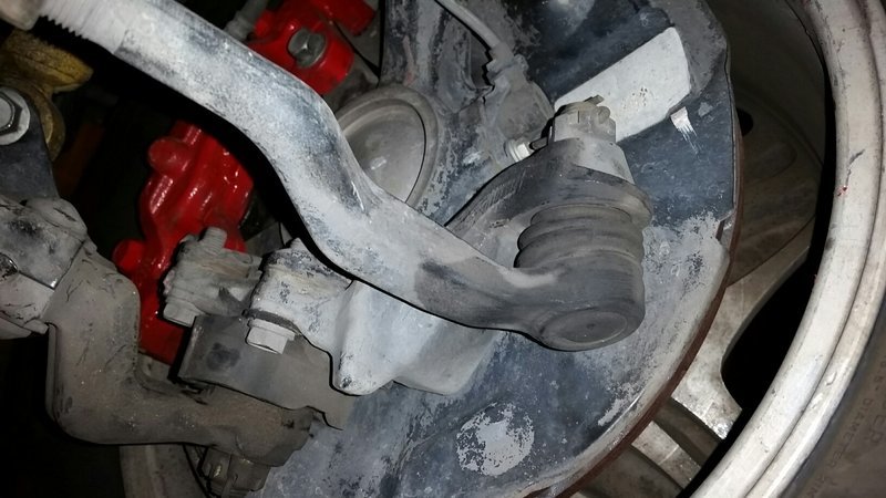

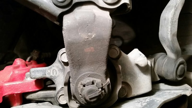

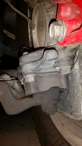

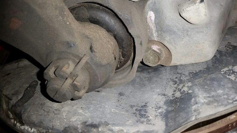

    Well I had to know tonight. Rolled under it and measured joint stud and it appears to be the correct diameter threads. Also the the rod end has the same size stud as the tappererd hole. Bolt pattern apears to be the same. Tomorrow i'll find a parts store and compare them.
    20161213_223310_resized.jpg 20161213_224952_resized.jpg 20161213_225030_resized.jpg 20161213_225657_resized.jpg

    Again, I don't think you have Tundra lbjs, you have OEM Tacoma ball joints with the rare and unexplainably equipped ball joint dust shield things. Apparently those shields were also standards on the Tundra. The 4 bolts would not line up if one attempted to install Tundra lbjs on a Tacoma.
    Look at the spacing of the bolts and the casting around the tre hole. They are not interchangeable.
