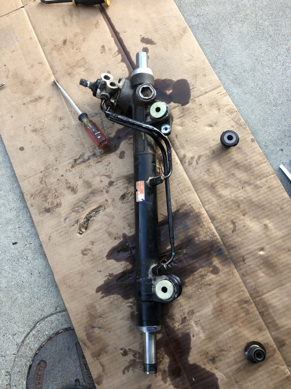

    Glad to have ran into this thread! I just bought the black bushings (8.10106G) and they came in the other day. I can't believe how long it has taken me to figure out what the issue was with my steering. Very happy that there is a fix that doesn't involve replacing the entire steering rack :thumbsup:
    The notes that I've taken away from this thread is to:
    • Apply grease
    • Lock down the steering wheel to avoid destroying the clock spring
    • Use a pickle fork
    • Torque bolts to 68 ft.lbs
    • Be patient
    • Get an alignment after install
    Would any of you recommend that I do anything else maintenance wise while the steering rack is out? Am I missing anything?

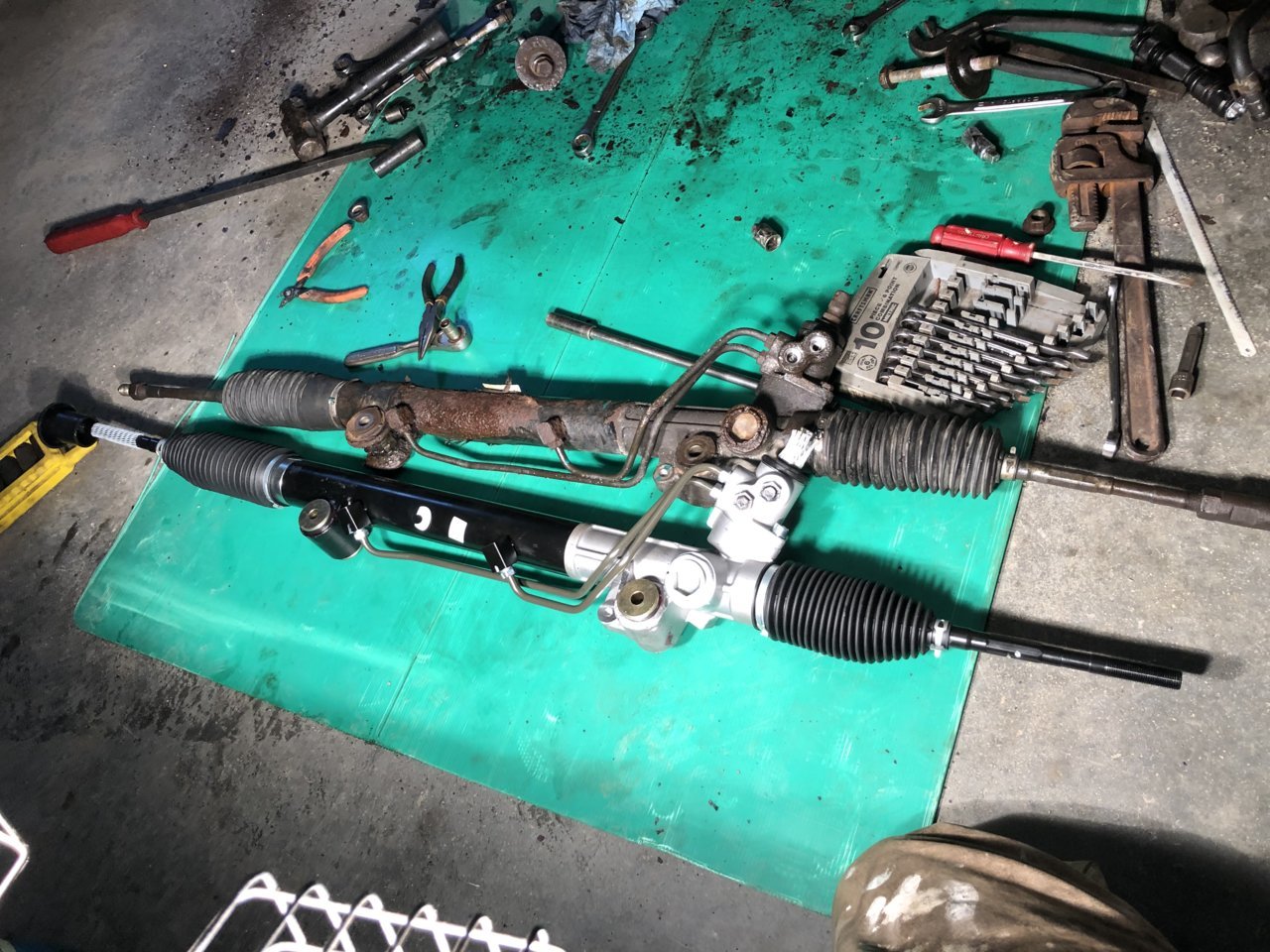

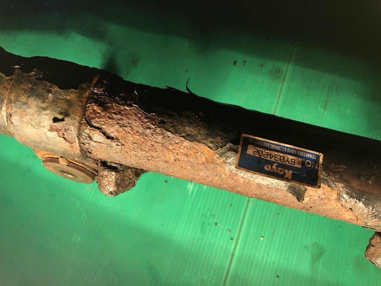

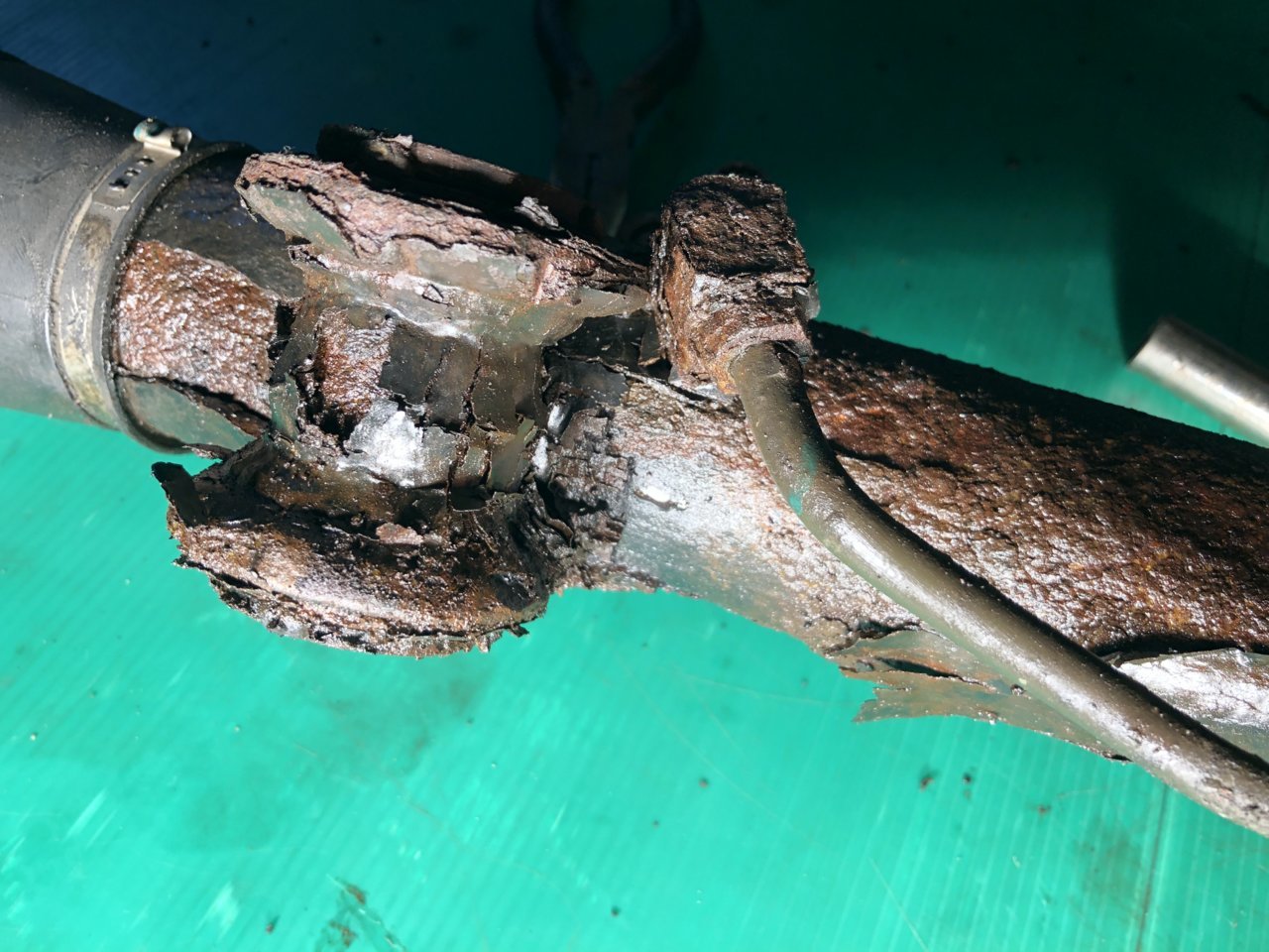

    Carefully check the intermediate steering shaft, now’s a good time to replace it if the u joint is sticky in either direction.
    Just pulled my rack today, what a pain in the ass. Took me from 2pm-5:30pm just to get it out. Intermediate shaft bolts rusted on, main issue was the pressure line on the rack, just couldn’t get it to budge. Have new lines for it anyway so I just used a hacksaw blade to get half way through the line, then a sharp chisel to sheer it.
    Apparently, the line seized to the nut. I turned it out by hand after that. Then had to wrestle the rack out, wasn’t as easy as “slide it to passenger side, then out the driver side”
    Unbolted and slightly bent the AC line up, took the bolts out for the front differential to let it drop and get the nuts out of the way.
    Anyway, my rack is trash, rusted out badly. Hope the new one goes in easier tomorrow. I replaced the new bushings in the reman rack with Energy Suspension bushings, was going to replace the u-joint in the steering shaft too but mine is fine, so it’ll get packed with grease and covered with a bike tube and zip ties.
    This job SUCKS.

    No problem, I wish it was easy as replacing the bushings on my first gen 2.7 truck. That took me 40 minutes including a beer break in the dead of summer heat.
    I’ll post up a pic of my rack after I’m done with it today, I’m in the northeast, road salt is a killer up here. The rest of the truck is rust free (new frame, body is really nice because my brother washed it a lot before I bought it from him).
    That said, he and I both wish that the dealer noticed the rack was rusty during the frame swap, would have saved me a headache now!

    Just to follow up:
    Not sure if I got the rack set just right or not, steering wheel is dead center, but turns a touch further one way than the other. 99% of the time it will be fine. Tie rods are set pretty much identically to each other as they were on the old rack, tires are dead straight but I’ll get an alignment anyway. Tracks straight down the road and wheel stays centered.
    Went back together MUCH easier than it came apart. Had the new rack installed in about 20 minutes. Add another hour working slowly and to put in the new line set I bought, and fought with the driver side tie rod end to get it off the old rack.

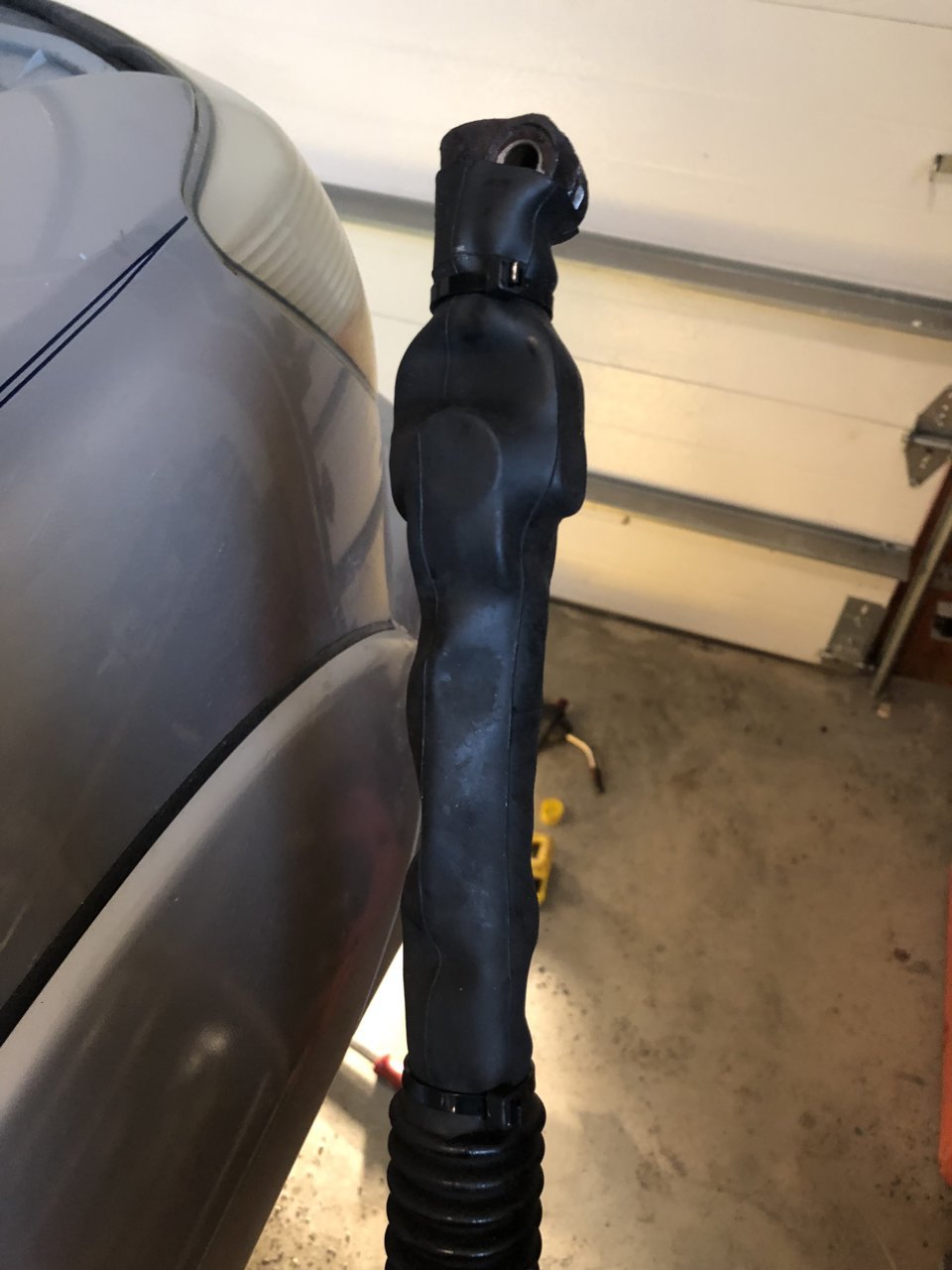

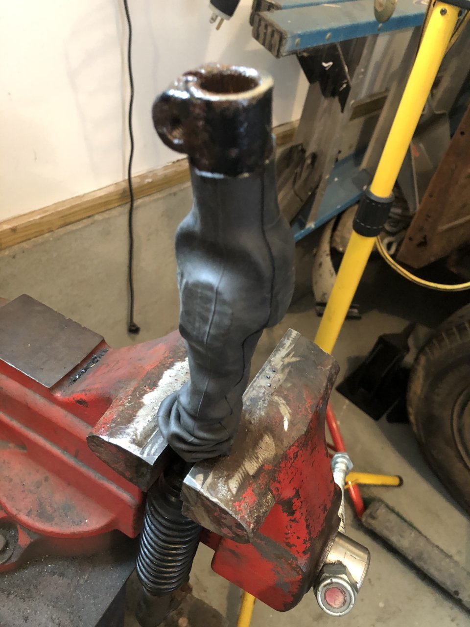

    Installed the lower intermediate shaft, my u-joint is still tight, no play at all. I packed it with grease and stuffed a bicycle inner tube over it, zip tied at both ends. No clue how long that’ll last, but it’s the best I could do for now.
    Tightened up the differential bolts, added some Valvoline MaxLife Dexron, and worked the wheel back and forth with the truck OFF to pre-bleed the system. Fired it up when the fluid level stayed the same, topped it off one last time and rechecked all the nuts and bolts that I removed.
    Steering feels amazing! It never felt so tight and precise, not sure whether it’s the rack, the poly rack bushings, or the combination of the two.
