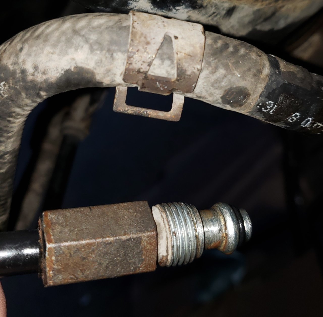

    A mystery O-ring fell to the ground when I removed the oil feed and return lines. Both the feed line and oil return fitting had small o-rings on the tips of each fitting, like shown in the photo below.
    Anyone have an idea where the larger o-ring (maybe 1/2" diameter) might have come from? There's no obvious fit on the steering rack line fittings.

    The high pressure line is the only one with an O ring.

    There was also a small o-ring on the tip of the return line fitting when I removed the fitting. The strange thing is the 3rd, larger o-ring that fell to the ground. I may try to install without it and cross my fingers.
