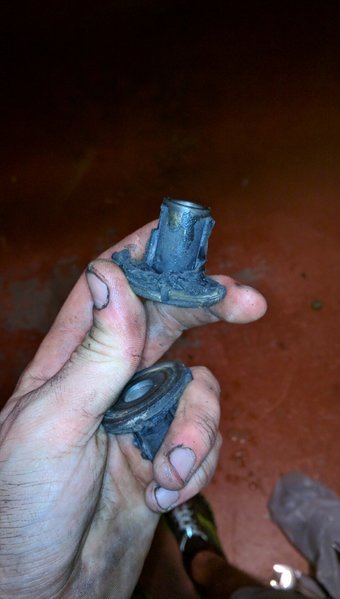

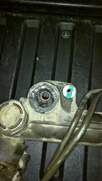

    I currently have my steering rack out and my bushing removal looks just like yours did. How did you get all of the remaining bushing rubber out of the holes?? (What a pain in the a$$!!!)

    Ok, I figured out that the oem bushing has two metal sleeves. I had just pushed out the inner sleeve and not the outer sleeve. The passenger side came out fairly easy with the pickle fork. The Drive side is proving to be a little more challenging!

    Well, I'm having terrible luck, I was able to remove the bushings form the rack and when I went to clean the rack up, I discovered it was leaking from the drive side inner tie rod. I decided to purchase a new OEM rack (as others have said, "Once and done!). Luckily I have another vehicle to drive for the next week until the new rack arrives. My question now is, do I put the Energy Suspension bushings in the new rack since I already have them?
