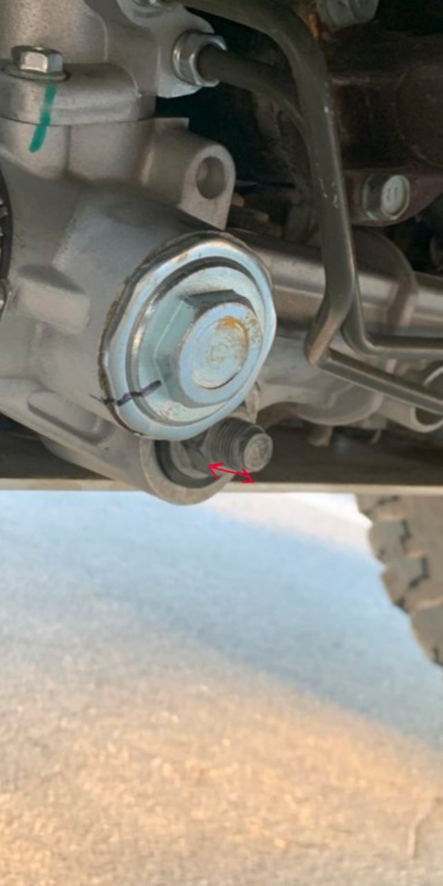

    I've got a quick question for you guys, or a favour if you will.
    Would somebody with the rack reinstalled mind measuring, as precisely as possible, how far the bolt extends past the nut at final torque?
    Like this, top of the nut to end of the bolt.
    (I know this is the wrong rack, just a clear picture)
    Thank you to anyone that can help out!

    I'm running the rack bolts back in from the bottom with a castle nut and cotter pin on top. I need the measurement to drill the hole in the bolt. I already pulled my bolts so I just thought I'd ask.
    We do it all the time on older cars, so much so that my buddy has jigs just for drilling through bolts.
    Loctite is good, cotter pins are better. At least in this scenario.
    EDIT: here it is installed
    Try falling out now. :quickdraw:
