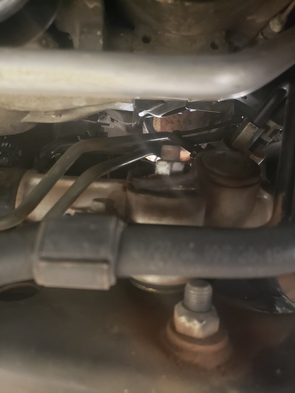

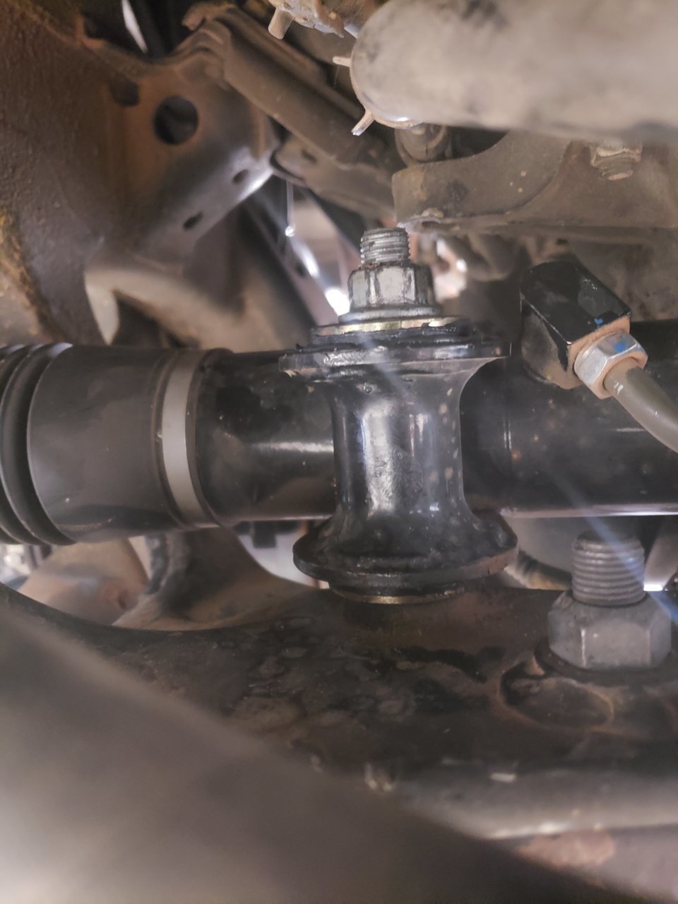

    Thought I would share this and get some suggestions.
    I installed the bushings and flipped the bolt from the bottom up and tightened/torqued fron the head to 68ft lb. Here is what happened.
    The lip of the bushing is ripping away from between the rack and the metal insert. So....I got another set thinking I was under torqued. Torqued to 100ft lb. Same result.
    One other thing to note, I don't have eccentrics anymore. I have Taco Tabs that lock out the alignment. If the truck can not be bumped out of alignment, is all of the steering force going through the rack and into the bushings?

    I have same prob with bushings squeezing out some. Don't sweat it too much. As for bumping force, lca and uca bushings will take the load as well.

    Ok. But the lips are ripped off of mine. This second time the rack isn't moving though. What did you torque to?

    Mine did the same thing, I thought I over torqued it. I still think I may have.
    My other thought is the the bushing slipped out of alignment with the bolt while I was wrestling the rack back in there. I used the Energy Suspension bushes.
    A little bit of squeezing out is not s big deal but mine squished so much it ripped around the top, which is less than ideal.
    I did not replace it and so far I haven't noticed any handling or steering issues. I do plan on replacing them eventually, if nothing else just to make it a clean install.

    Same here. 35s and going offroad probably helped rip the lip off. Still steers fine though
