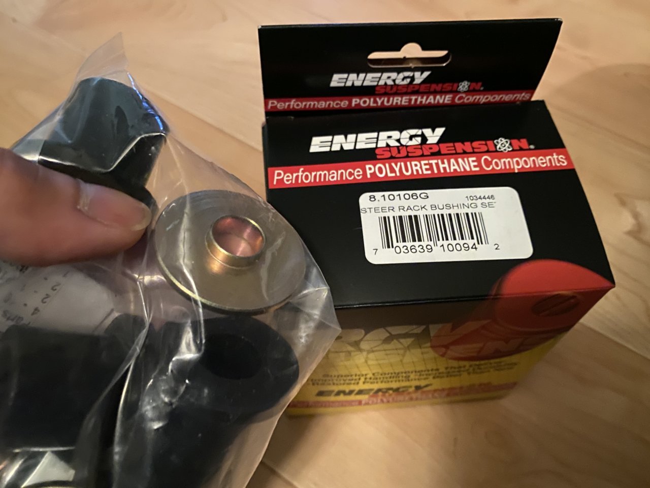

    Got my bushings in today but it doesn’t look like the ones you guys got. The sleeve on the washer is only about 1/8”. The part number on the box is right but I’m thinking the contents inside is not. Guess I need to return them :facepalm:

    Should be a seperate sleeve in there. If you do return them, get whiteline bushings instead.

    I went ahead and bought a set because the ES bushing sleeves seem like I am crushing them when I torque the bolt down. Although the whiteline bushing is a little thinner, the sleeve and washers seem thicker. Hoping my next time I get the opportunity to replace the bushings, I'll have better results with whiteline. It also looks like they have body mount bushings as well.

    PS also should I return the ES bushing and get the whitelines? I did whitelines in the LCAs and they are top notch.

    Do whiteline

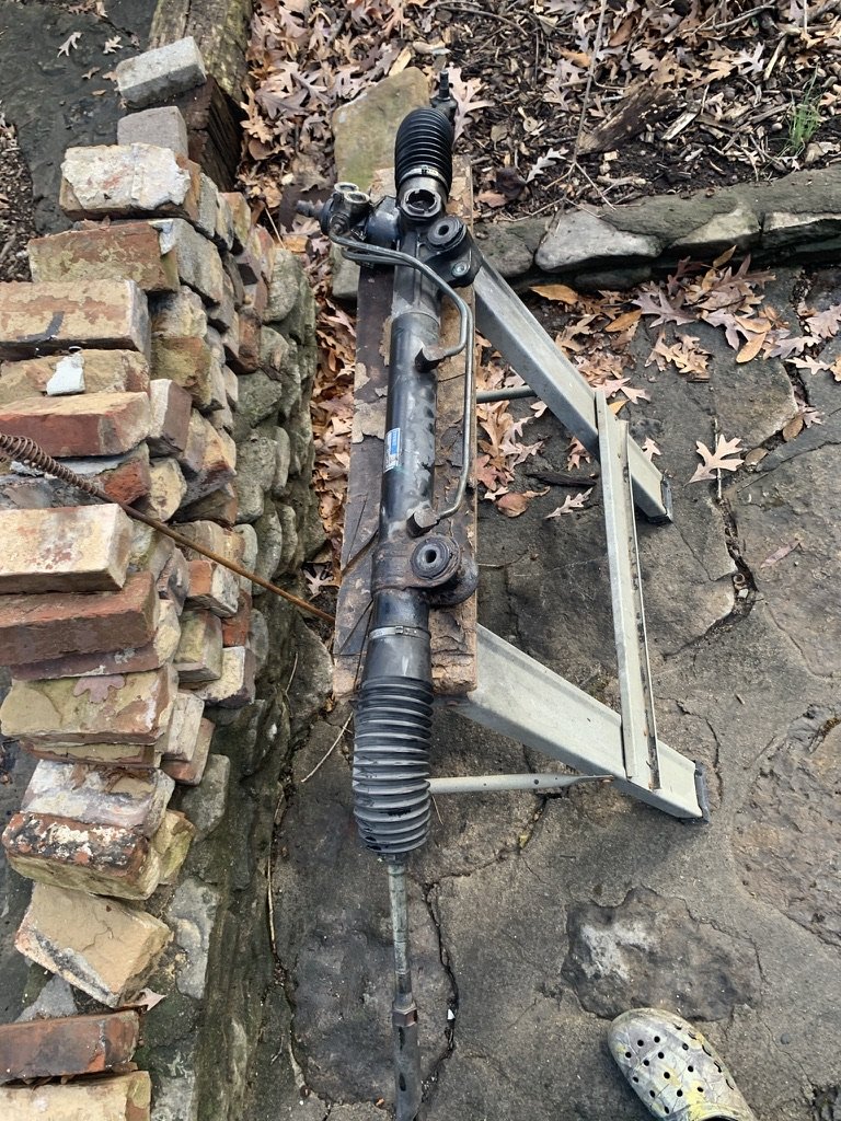

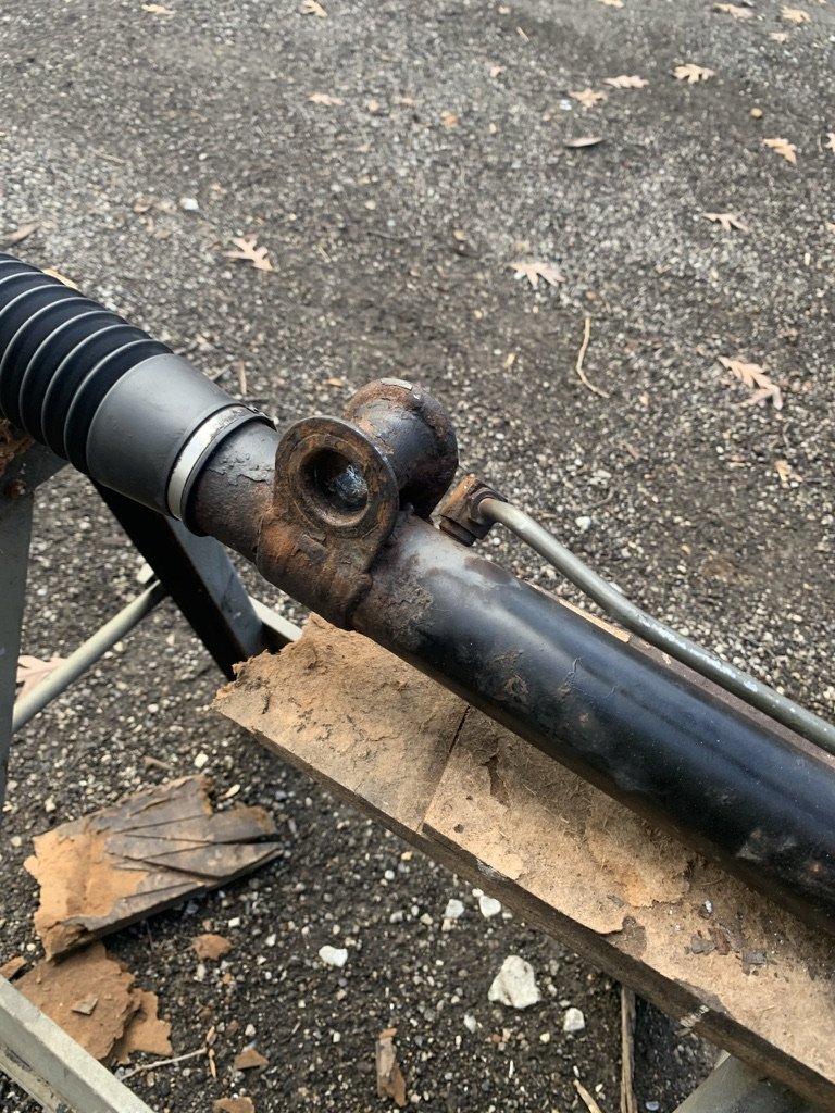

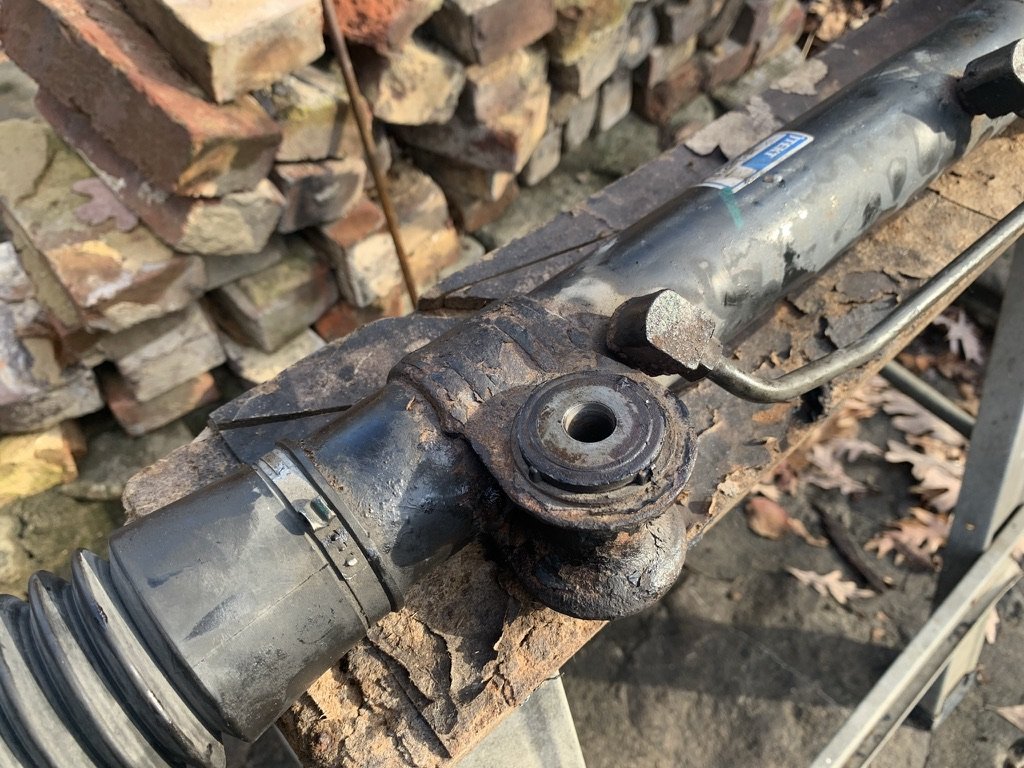

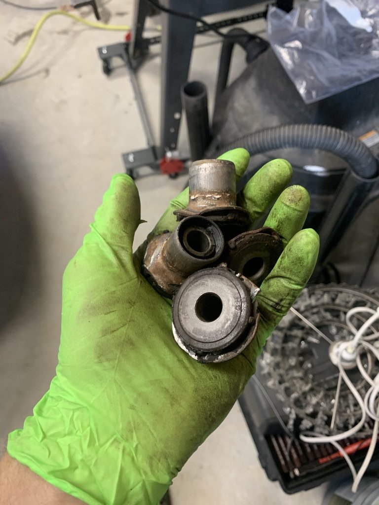

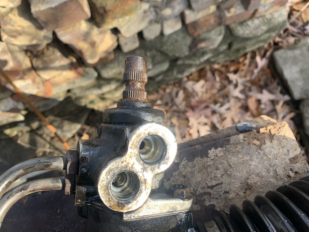

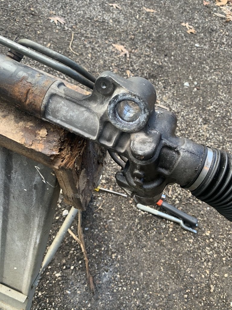

    What a PITA haha, all out, cleaned up, and painted. Going back in tomorrow. Remind me never to buy a truck that has lived anywhere where they salt the roads, jebus! Intermediate shaft removal was by far the hardest part.
    That much corrosion in 8 years is crazy.

    I just swapped out my ES bushings for Whiteline. ES bushings were trashed only after 6 months. We'll see how whiteline does.
