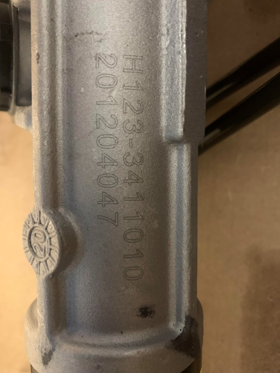

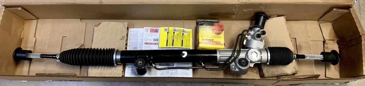

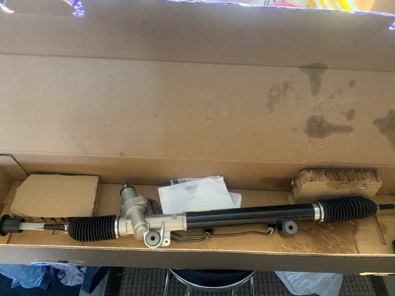

    Getting ready to replace the steering rack and do poly bushings along with new oem LCA’s and white line bushings. Adding taco tabs to keep everything aligned.
    ordered the rack from rock auto ( per a post on TW) here are the pics of what they sent me just making sure this is correct before I get started.
    the numbers on the rack don't match what I ordered 26-2629? But the rack looks correct ?
    I also picked up two new bolts and nuts plus tie rod ends from the dealer, a new high pressure linesteering rack order 1.jpg steering rack order 3.jpg steering rack order.jpg

    It’s upside down in the picture, but looks correct to me.

    I have a new OEM one sitting at home, if you need any measurements or anything. Can't help on the part number or visual on the cardone part though unfortunately.

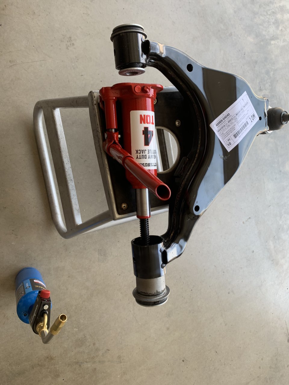

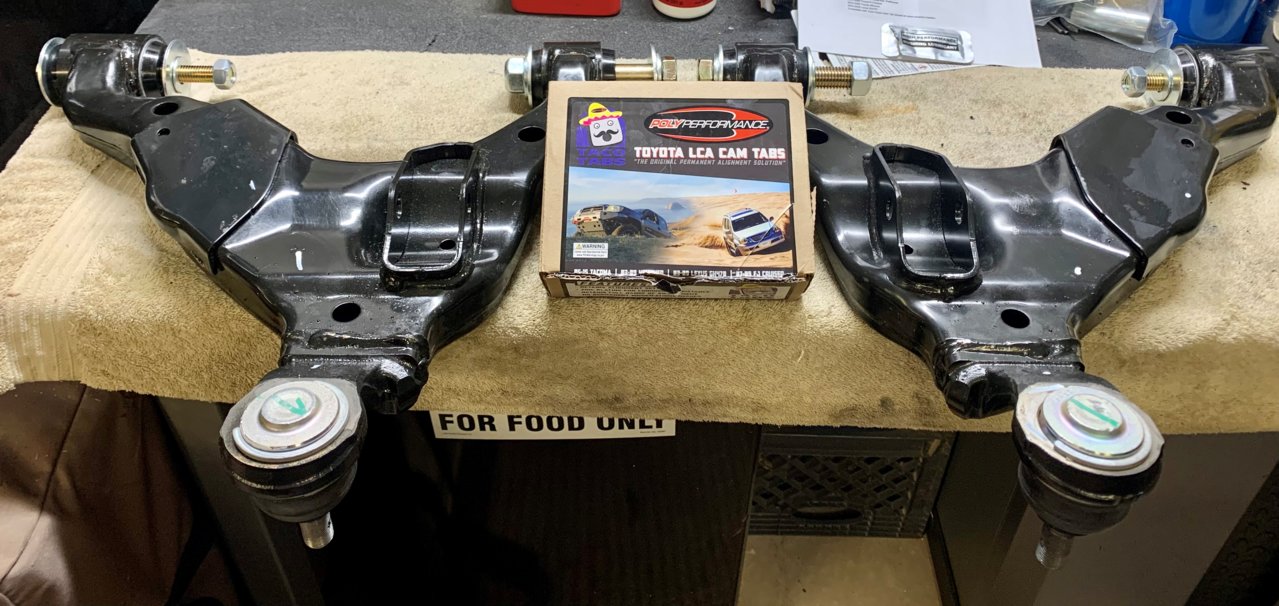

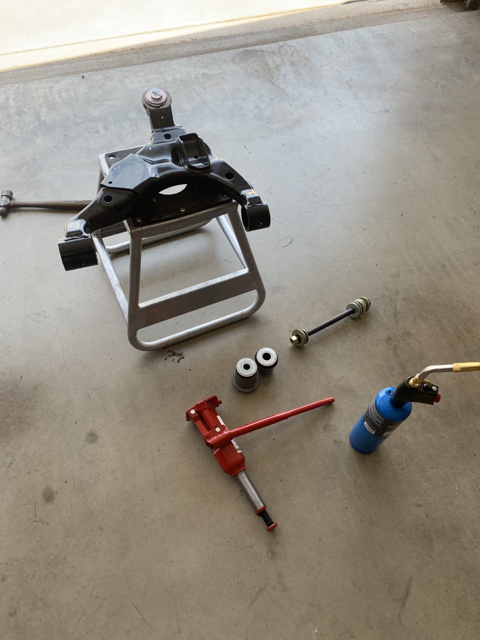

    Just finished the bushing removal and installation of the ES bushings -
    installation will be next Saturday.
    This weekend is all the prep work. Now to remove the oem LCA bushings from a new pair of oem LCA’s and install Whiteline poly bushings
    oem bushings removed - time to press in the whiteline LCA Poly Bushings 84EDF5E5-D038-4E02-B21F-AEB4BA93689A.jpgCD59AEB9-5405-4E72-B1F5-DF613770067C.jpg0B53A055-749C-47B3-A178-6B94A09AAFB5.jpg

    Completed the front end rebuild/upgrade - new steering rack with ES poly bushings ( with new OEM bolts/nuts and tie rod ends and hydraulic lines ) used the carbon paste recommended by another poster (thank you), New OEM LCA 's with Whiteline poly bushings, and installed the Poly performance taco tab (cam replacement) kit. everything has anti seize applied and blue thread locker.
    End result - truck has never driven better! steering is spot on and responsive, tracks straight as an arrow, no play or slop felt anywhere (even with my 35's)
    added benefit is the assurance knowing the OEM cams are gone, and the Taco tabs have the alignment locked in.
    Thank You to all that have posted previously providing much needed/appreciated information that made the positive end result to a 2gen known issue.

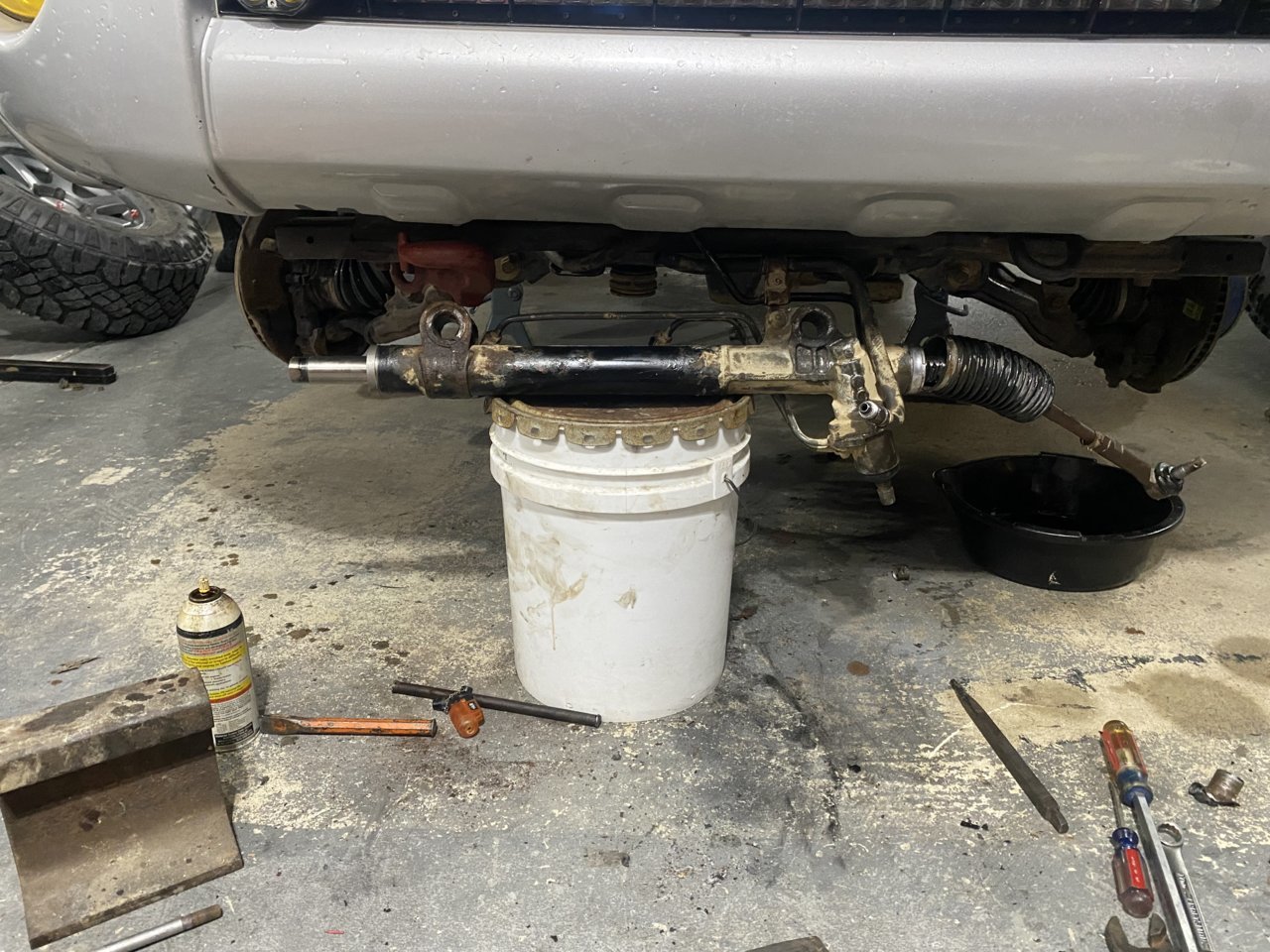

    The same shit everyone else has.
    Holy fuck.
    I just did my rack this weekend.
    Ended up being a 9+ hour job. 180k miles of salt really made this a pain in the dick.
    I couldn’t unbolt the high pressure hose from the rack so I had to fight the whole thing out still connected to the truck.
    Talk about a pain in the ass having to hammer out the bushings with the rack sitting on the bucket.
