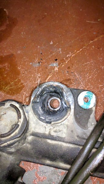

    HELP... after 6 hours of getting the rack out (power steering line couplers were trouble..)..
    I can't seem to get that "sleeve" to come out.. I tried pulling just the bushing.. and this is all that came out? Rack is left like this now... not sure where to go... clock is ticking for monday too...

    This doesn't look very good, the rubber part is still in the hole....others will chime in here....you need to remove the rubber bushing, clean up the hole, then install the new bushing and center sleeve...be careful not to fubar the outer sleeve when removing the bushing proper as a smooth surface will make inserting the new bushing much easier....
    a hacksaw or sawsall tool will help with cutting the rubber....you can use a socket of the right diameter to bang it out, or a chisel...it will be a biatch at best....good luck...

    I'm not really getting how that inner rubber is supposed to slide cleanly out of that outer sleeve... and that outer sleeve is getting destroyed as I'm trying to pickle fork it out... it's like it's cemented in there...

    Heres where I'm at now... doing a number on my rack too...

    You need to get some help, it seems your understanding of what is needed to complete the job properly is lacking....there are times when I screwed up a repair, simply because it was the first time and I forged on without regard to the outcome, ended up buying a whole new part rather than an easy fix....
    Maybe when the sun rises others will chime in with some helpful advise....hoping for the best...BTW, where in California do you live?

    Im just not understanding that outer metal sleeve.... if your bending it to pickle fork it out... and it takes the rubber with it... what allows you to remove the inner rubber from it? Am I just being dumb and you dont put that outer metal sleeve back in?

    You gotta get that sleeve out. I'd hit it under the lip with a flat tipped screwdriver. Try penetrating oil too.
    If you can bring the rack somewhere, go to E&M Auto in El Cajon. They can help you.

    Do you re-insert the sleeve?
  17. Jul 23, 2016 at 12:11 PM

    No. Goes into trash. That's my understanding based on OP's pics.

    thank you! because im definitely destroying it trying to get it out...
    getting worried that im doing a number on the rack as well flipping it and banging it and stuff...

    :D rack is done!
    However..does anyone have the part number for the new Toyota bolt? I threw a home depot one in there FOR NOW.....
