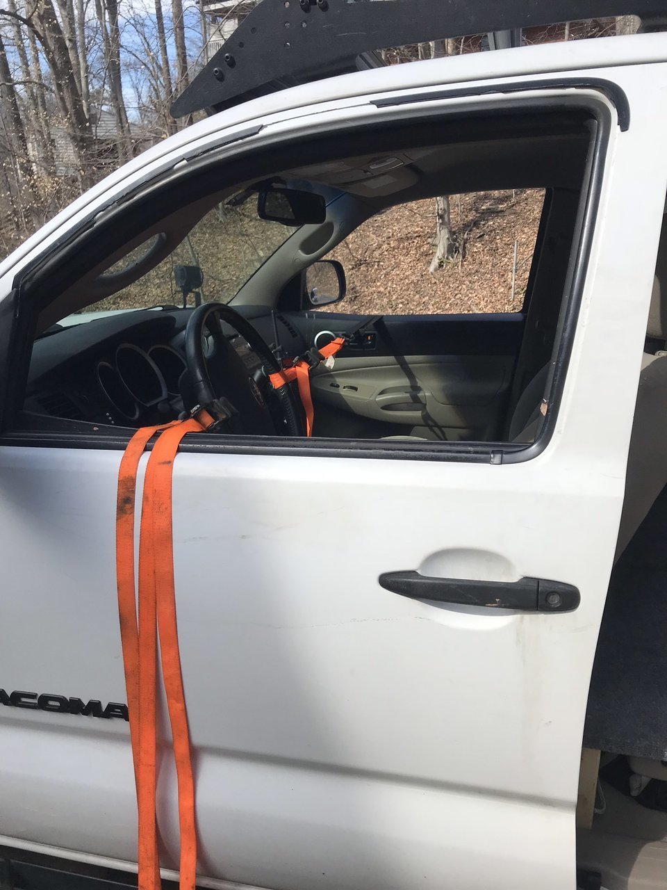

    What did you guys do to lock the steering wheel?
  5. Jun 12, 2018 at 7:26 PM
    #165
    EatSleepTacos
    Mar 24, 2015
    #151688
    59,841
    Randy
    West Valley, AZ
    2017 4Runner
    You can just use the regular steering lock, or feed a seat belt through it, or go nuts and use tie down straps.

    2005 TRD OR Access Cab
    3" 33s, UCAs, Hurst Short Throw, JL 12 500 Watts
    so you turn it all the way to one side? then lock it down?
  7. Jun 12, 2018 at 7:28 PM
    #167
    EatSleepTacos
    Mar 24, 2015
    #151688
    59,841
    Randy
    West Valley, AZ
    2017 4Runner
    Really the main reason to lock it down is so it doesn't just spin free like crazy and break your clock spring. I just turned it so all the bolts were accessible on the intermediate shaft, then locked it down.

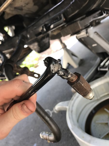

    Well started the job today got the rack out then called it a night.... wasn't too bad the hardest part was unbolting the power steering pressure lines couldn't get a good angle... will install new bushings tomorrow with new tie rod ends and sway bar bushings... will keep updated

    I had trouble with that too. Ended up mangling the shit out of the line.

    One word you guys. Line wrench... okay maybe two... and since I went over... heat is your friend

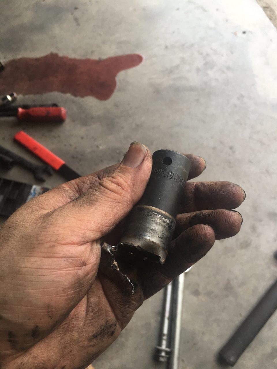

    Here’s a tip
    If you mess up the bushing casing where it won’t pop out. Take out the other side, use a 15mm socket and a big fn hammer to knock it out.
    If that doesn’t work or both are messed up get a hole saw and make a cut all the way through the casing, then use a flat head to pry it up till it comes loose on both ends.
