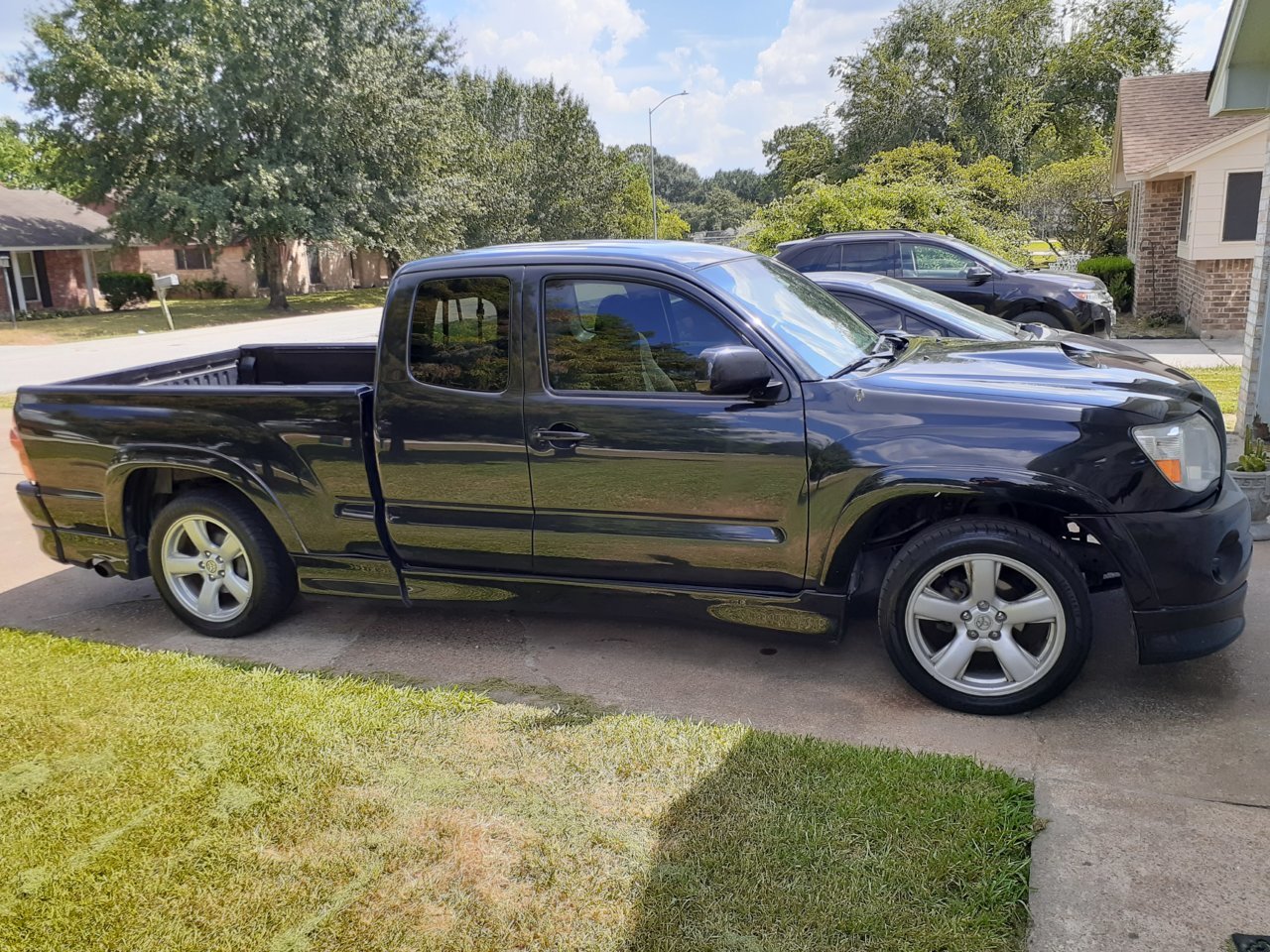

    Looking for locals that could point me in the right direction for modding my truck. Wanting it to handle a road course good and just be a better truck all around. I plan on doing a lightweight flywheel and solid motor mounts but may just do the t56 swap with a linked rear end. Wish I could do the irs rear but want to keep things in a reasonable price range as I go.

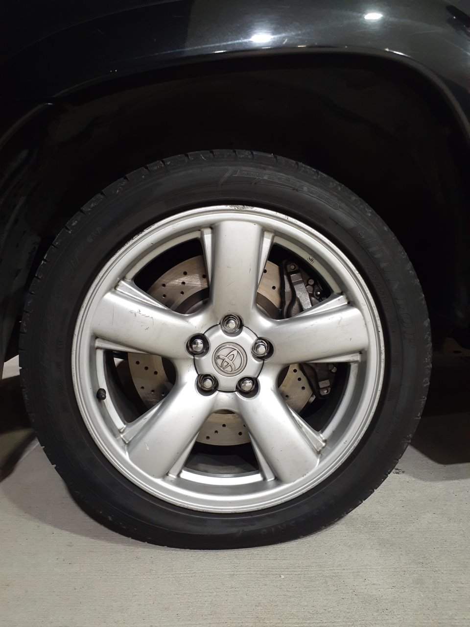

    Yes. The tundra caliper, with the lexus isf rotor and stop teck brake lines. Wanting sway bars and coil overs all the way around. Not sure how that will work as I do carry motorcycles alot to get to the tracks. Wanting to do a track day in the x runner as I've never done a car track day.
