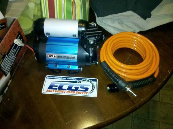

    One more wish with a check by it. Only way to much to go

    Who can point me in the right direction on a fuse block? Need one I can add too. Only need to run the ARB as of now but there will be more to come.

    Lights is probably all I will add. As of now I don't plan on a winch
