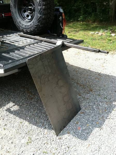

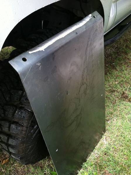

  4. Jun 17, 2011 at 3:11 PM
    #704
    05tacoSPORT
    05tacoSPORT [OP] Well-Known Member
    Jan 16, 2010
    #29449
    2,144
    Tennessee
    TRD SPORT
    Geared and Locked

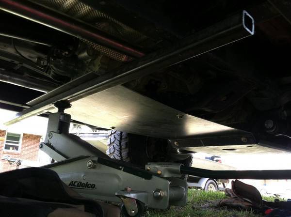

    [​IMG]. 3/16" plate 23x40. 1.5" square 3/16" wall. L brackets. If all goes well I will get started this weekend

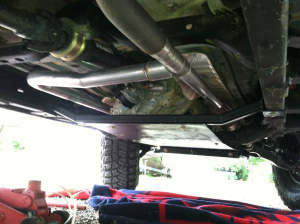

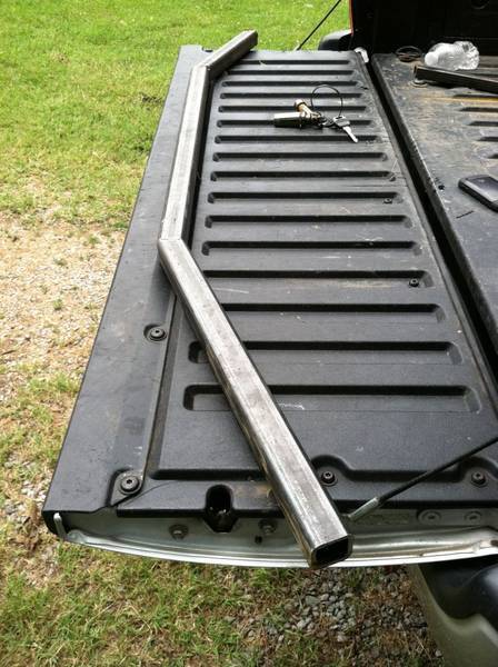

  8. Jun 18, 2011 at 9:23 AM
    #708
    05tacoSPORT
    Jan 16, 2010
    #29449
    2,144
    Tennessee
    TRD SPORT
    Geared and Locked

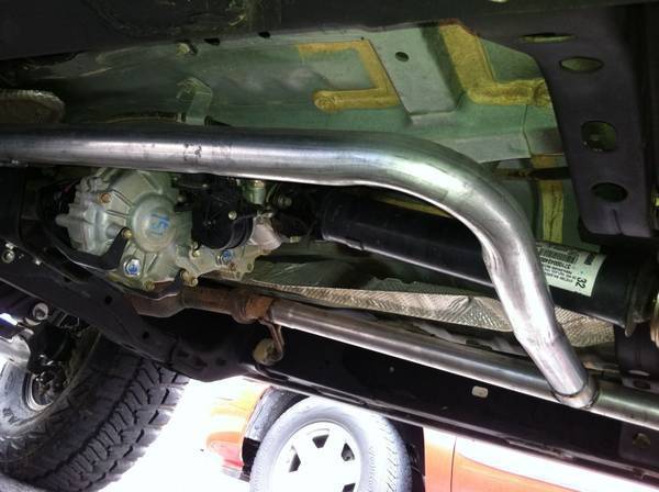

    [​IMG][​IMG][​IMG] 15 min. with a torch and bent:D[​IMG][​IMG][​IMG]
  9. Jun 18, 2011 at 9:30 AM
    #709
    05tacoSPORT
    Jan 16, 2010
    #29449
    2,144
    Tennessee
    TRD SPORT
    Geared and Locked
    Now to make the cross member

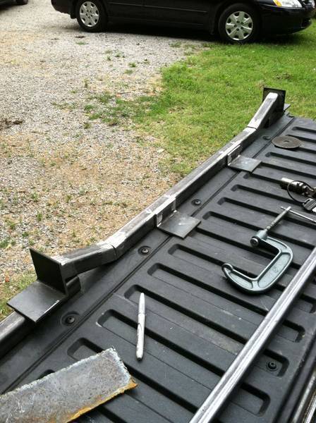

  11. Jun 18, 2011 at 3:43 PM
    #711
    05tacoSPORT
    Jan 16, 2010
    #29449
    2,144
    Tennessee
    TRD SPORT
    Geared and Locked
    [​IMG] 2 more holes and some black paint and DONE:bananadance:

    Thanks. Took most of the day without the proper tools for the job. And I had to find a buddy to let me use his welder

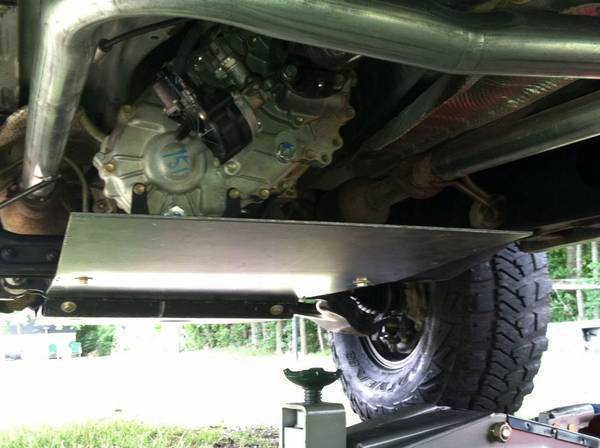

  17. Jun 24, 2011 at 7:52 PM
    #717
    05tacoSPORT
    Jan 16, 2010
    #29449
    2,144
    Tennessee
    TRD SPORT
    Geared and Locked
    Thanks for telling me. Good friend right there

    A few bolts are different.
    Drug my stock crossover through 4 rock fields today. Gotta get this done.
  19. Jun 24, 2011 at 7:59 PM
    #719
    jandrews
    jandrews Hootin' and Hollerin'
    Jun 7, 2009
    #18122
    16,432
    '09 FourDubDee TRD OR
    A-TRUCK, Fat Kid in the Bed, Custom Pinstriping, Ported and Polished Muffler Bearing, Hi-Performance Bed Mat
    Need to get me one of them CVs...
  20. Jun 24, 2011 at 8:02 PM
    #720
    05tacoSPORT
    Jan 16, 2010
    #29449
    2,144
    Tennessee
    TRD SPORT
    Geared and Locked
    ^^^^ yes. Last trip I made the exhaust was the only metal that saved my t-case. One pointed rock played hell on the 1/4 skid, crossover pipe, and added a few nice designs on my drive shaft.
