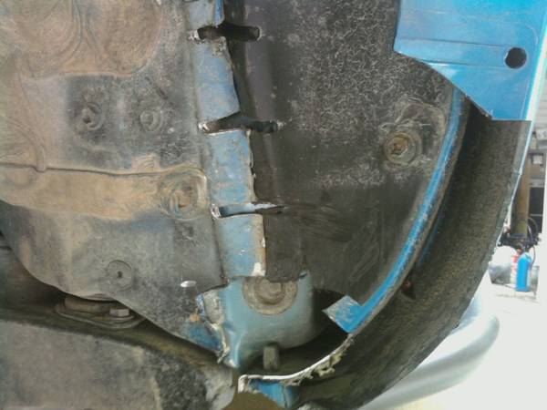

    I didn't plan on any further use, so I just pulled the inner liner out.

    If you removed all the plastic inner lining would you replace it with something at least to try and keep water away from the engine? Or would it not be that necessary to worry about.

    By bending the weld to the outside of the truck you run a risk of cutting the tire. With 35's

    + your gonna have to take flairs off and cut into fenders.

    I used a 4" grinder, Use new blades, cut slowly or paint will burn and bubble. And when done wash the truck well. If not, it will rust like crazy from the cutting wheels.
