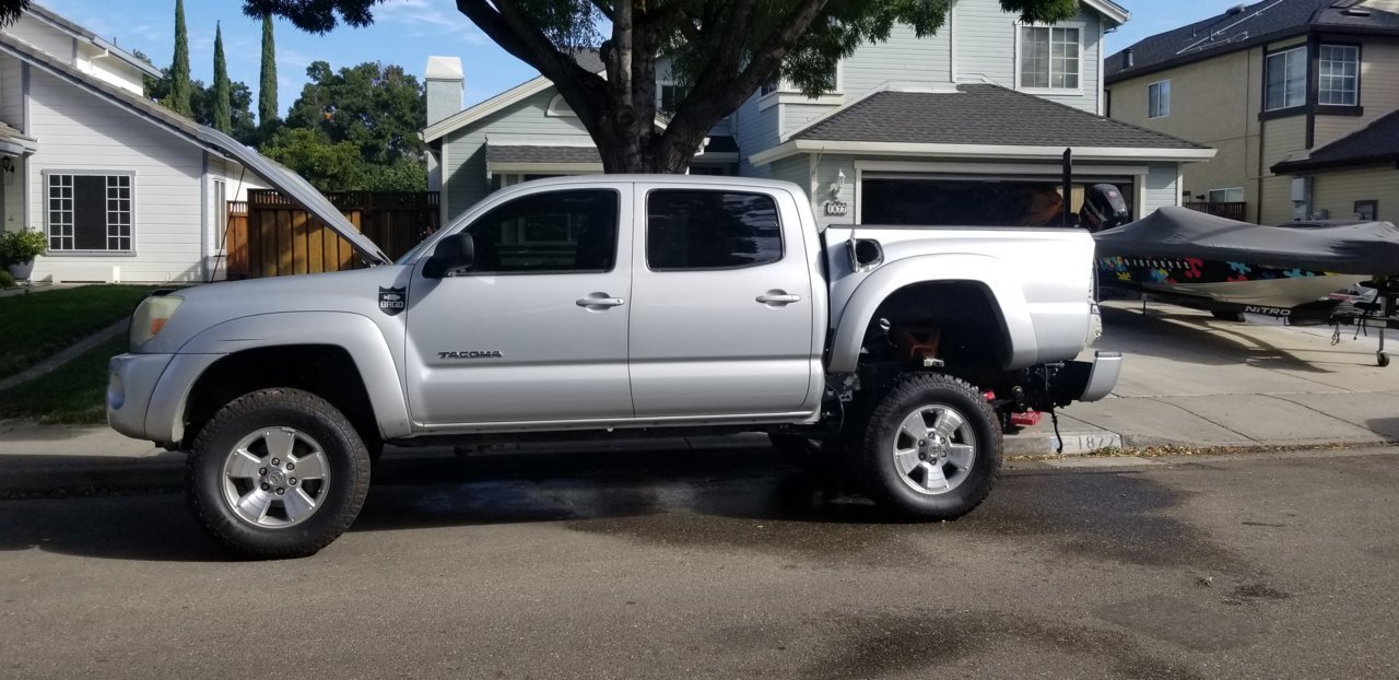

    So I've looked around for instructions or videos on replacing a Fuel Pump in a 2006 Tacoma 4.0L double cab, short bed.
    Everywhere I've read said to just lift the bed.
    So I did.

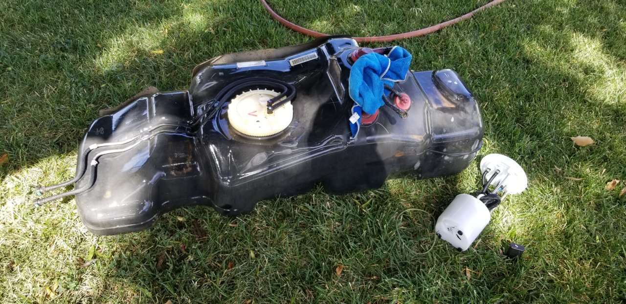

    Found out the fuel pump location is under the cab so I had to drop the tank.
    Was not bad what so ever.
    I replaced my fuel pump.

    Yea it honestly wasnt bad to drop the tank.

    OP - did having the bed lifted help any with dropping the tank?

    It actually helped alot. Sprayed all the hard to get mud and the gas fill nozzle was easier to move out of the way. I just lifted 1 side. Loosened bolts on passenger side.
