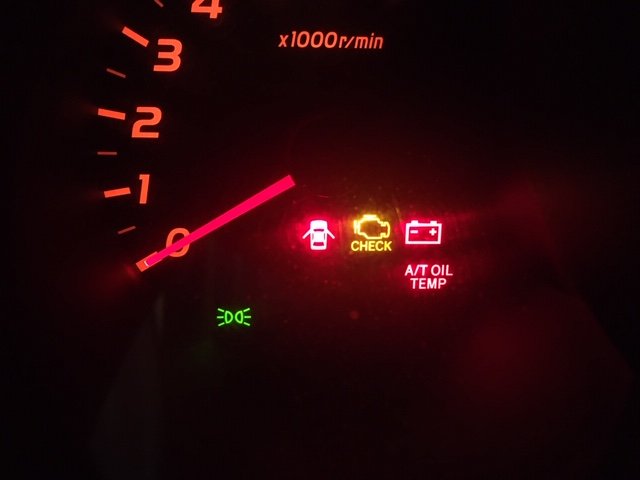

    IMG_4372.jpg Have been looking to put a gauge for A/T TEMP, does anyone know if this light that shows up on dash has a sensor that can be replace with an actual gauge. Not a big fan of lights !!

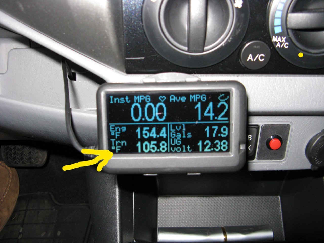

    ultra gauge.jpg You can add either a scan gauge or ultra gauge to the OBD port to read trans temps and a number of other engine functions. Others will likely add additional OBD options using phone apps -
