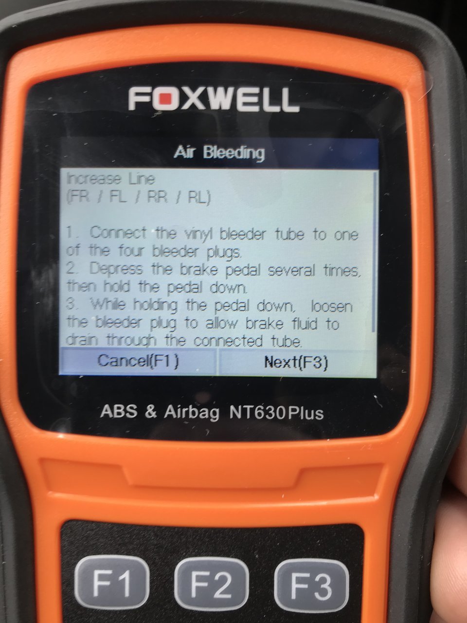

    I purchased this scanner, which is supposed to be able to cycle/bleed the ABS. I haven’t received it yet so I can’t attest to its functionality. before I purchased the scanner I emailed their customer support and they said it’s able to bleed my Tacoma’s abs.

    Update: Above scanner was delivered today and hooked it up to my 2nd Gen. Although I didn’t proceed with the procedure by pushing “Next(F3)” (See below), it does look like it has the capability to bleed the ABS, as is listed in the product description.
