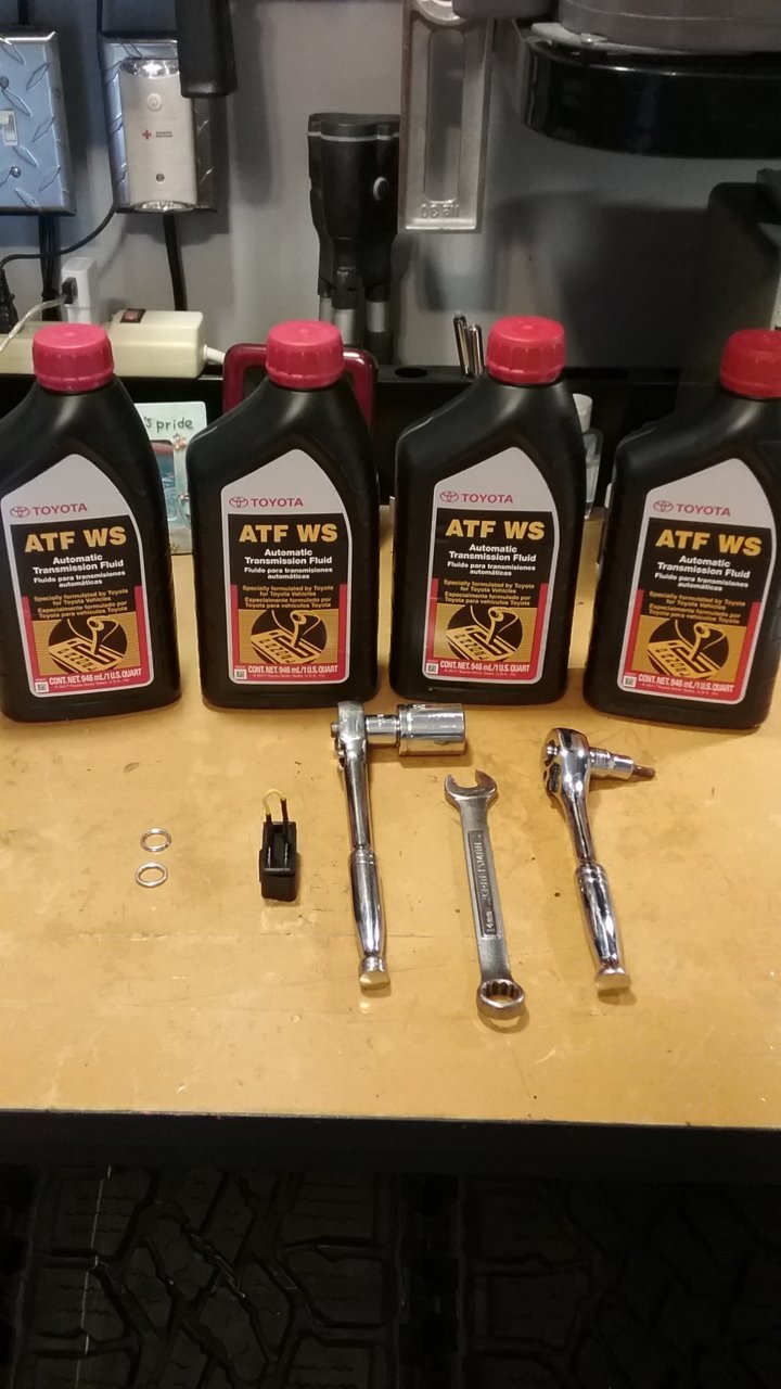

    Don't be scared of this folks. Do 3 or 4 DAFs over the course of a couple of weeks with WS of Maxlife.
    People get really spooked when it comes to transmission services
    BillsSR5 likes this.

    I wouldn’t hesitate do a drain n fill x3 times now and once every 30k miles. I would be more concerned about stripping the drain plug lol.

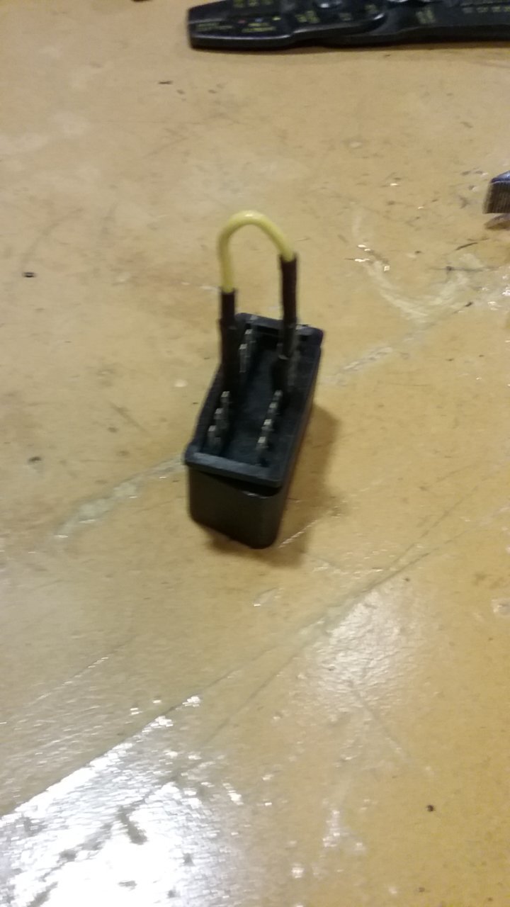

    If you’re referring to the transmission temp check mode, it's pins #4 and #13. Another way to figure it out is that it's always the 4th pin over from the left no matter which way the connector is turned.
    I marked the pins with a green Sharpie before jumping them.
