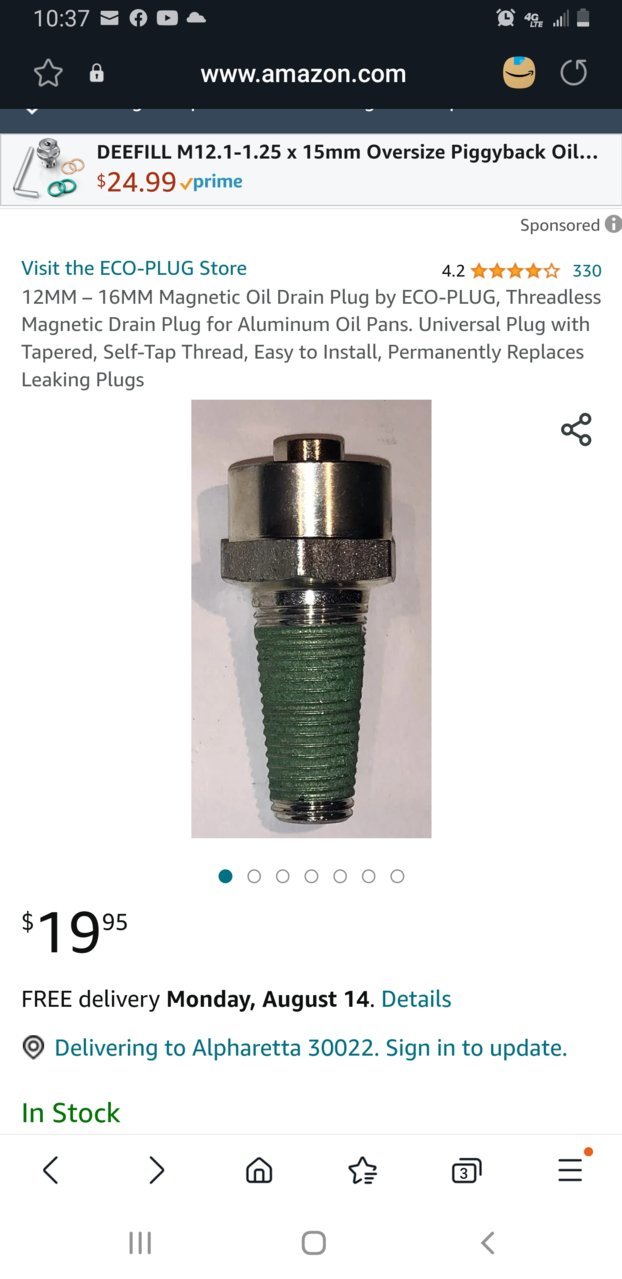

    That looks interesting, but I'd be afraid of metal shavings in the case.

    Anybody try one of these

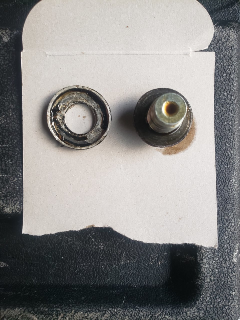

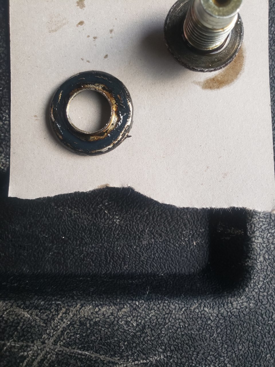

    This was the drain pan washer with blue RTV around the hole. Swapped the plug and washer. Can't be any worse. That was done by a shop he never did anything to the truck. I'm a hack but Jesus its a $2 part.
