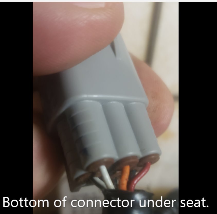

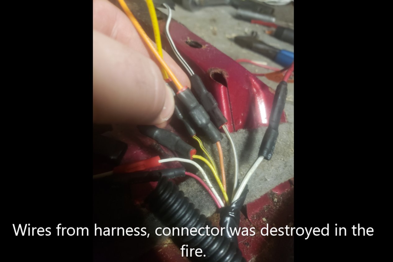

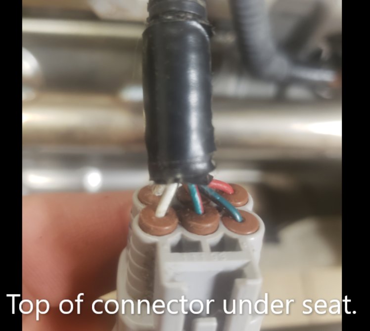

    Hoping for some help on my son's '06 Double Cab/TRD/4.0L. He may have accidentally tossed a lit torch onto the front passenger seat. This caused some unwanted burning of the seat the carpet and the wires under the seat. I have replaced/repaired most of the wiring and my son has cleaned up most of the burned items. Anyway down to the last connections and need some help. The wires coming from the harness under the cover on the door step do not match the colors of the wires in the 6Pin connector on the seat. I have not been able to find a pinout of a 6pin connector.
    Wires from the harness/fuse panel:
    White, Red, Yellow, Yellow/Black, Orange and White/Black
    Wires on the connector:
    White, Red, Green/Red (maybe Blue/Red), Blue/Black, Orange and White/Black
    So I could assume Red-Red, White-White, Orange-Orange and WB - WB but that leaves me two that do not match. Before I start splicing in wires would like to know that I am not going to set off any Air Bags unintentionally. Have pictures and a not so good drawing I made if needed. Does anyone happen to know how these should go? I believe the seat was from an '09 but will try to confirm.

    A picture of both connectors and where they are in the truck will help.

    Only one connector - the other one was sacrificed in the fire. Here are some pictures with some labels that I hope will help.

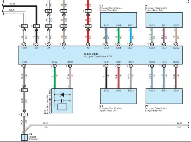

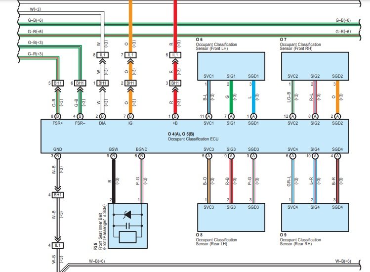

    Best I can tell that is connector BH1 but some of your colors don't match unless you got them wrong, OE diagrams below from 06 and 09.
    BH1
    06
    09

    Thanks for those diagrams. I will trace the wires back further to make sure the are no other splices I am not aware of. I will also get the year of the seat but I do see what you are saying - not sure why I have yellow and yellow/black. I heard rumors of some MFG's using yellow for Airbags which would make sense but the fact I cannot find a pinout or schematic showing these yellow wires has me puzzled. You help and the schematics are greatly appreciated.

    No problem, I also looked at an 08 and 10 diagram but the colors appear to be the same as 06 on the 08 and 10 appears to be the same as 09. Maybe the seat isn't originally from a Tacoma?
