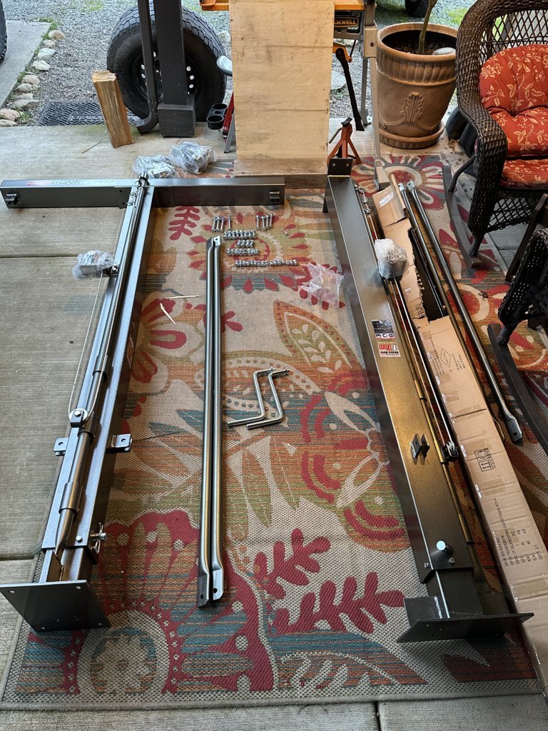

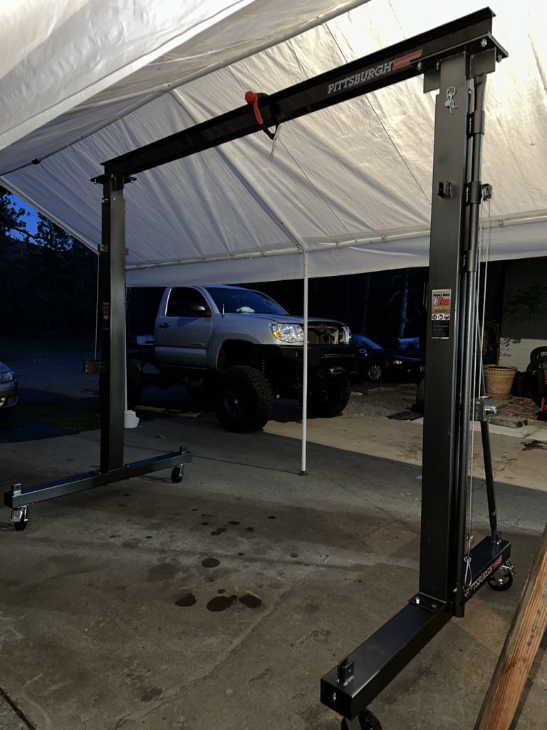

    Setting up the gantry, got dark so I held the phone until I had more time to come back n finish putting it together. In the meantime here’s a few pics of the unboxing. This thing is heavy af..

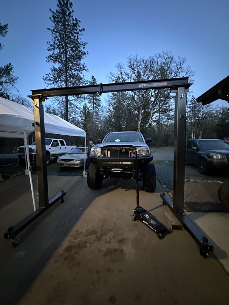

    I’ll get a better pic of it as these are kinda dark but I got it standing up yesterday night. It stands about 8ft tall or so as it is. I still can’t believe I’m taking this on with a full time job lol. But it has to be done. Not a cheap endeavor but it should be a solid outcome and ideally shouldn’t have to worry about it for a long time. Once this is done I’m think brand new 2.7 with OTT tune. A 4.0 would be even cooler but I got a thing for the reliability out of these 2.7s

    I did something like this from my rafters, are you you sure you’ll have enough room to to sit with the crane?..maybe on some rims only when you push it forward?

    *room to slide it out

    Like enough room as in will the crane lift it high enough? I hope so lol otherwise I’ll have to pull the engine first

    You might be able to tip the cab enough with a couple people to roll it out, it is so much easier to pull everything with the body out of the way.. or like I said if your on concrete you could just bolt on some old rims and roll it out on the rims

    My dad said i have some old wheels n tires at the house so in a pinch i might be able to do something like that ya
