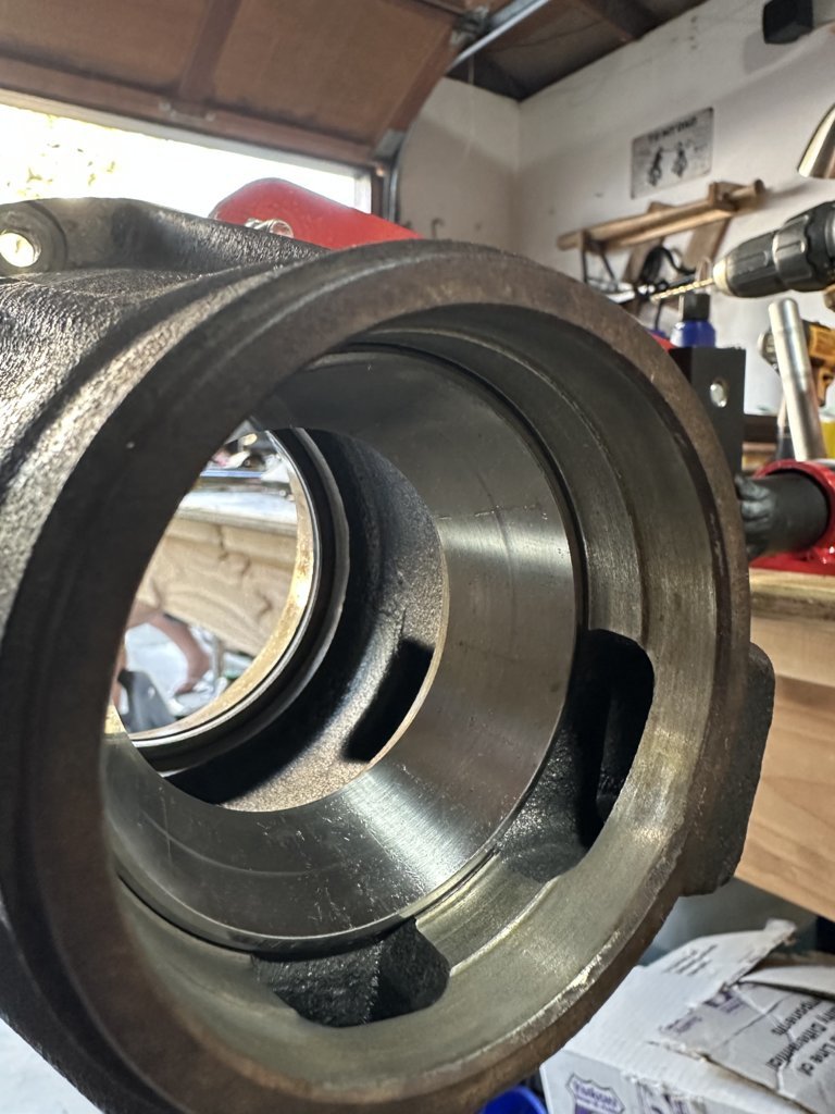

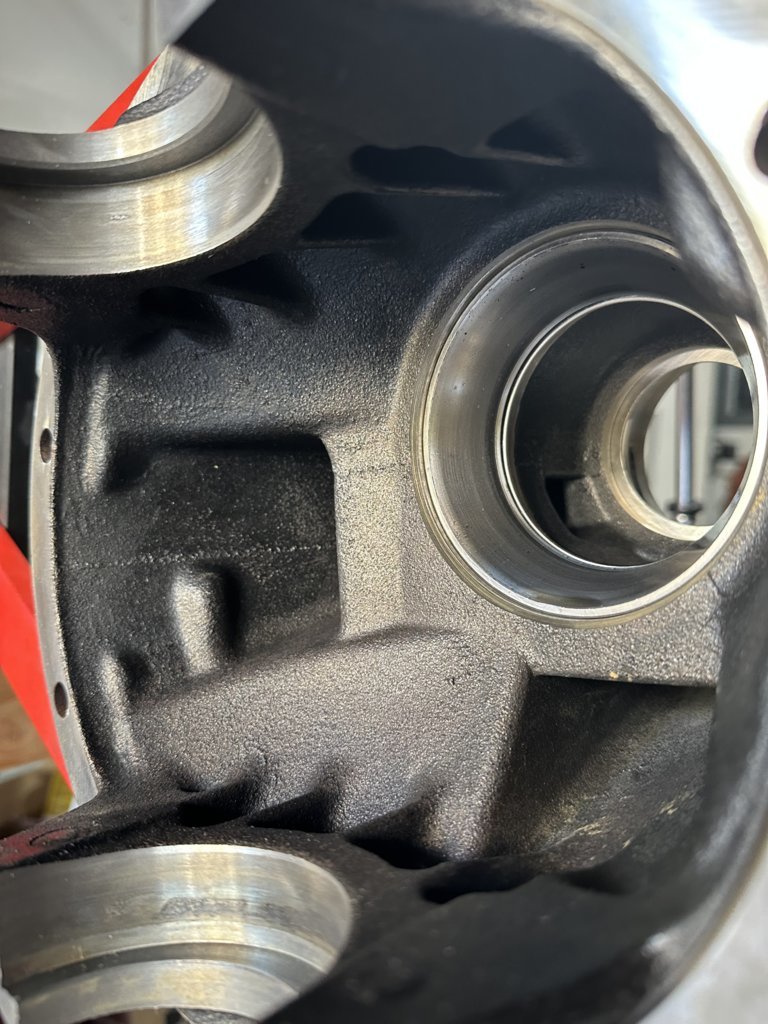

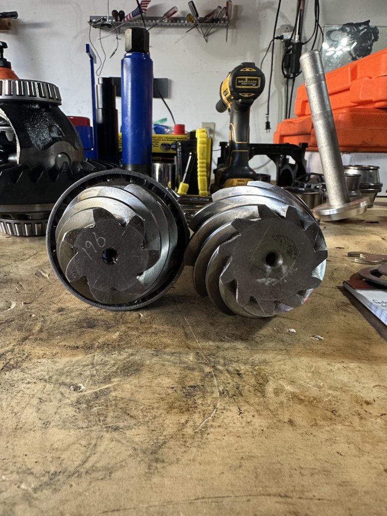

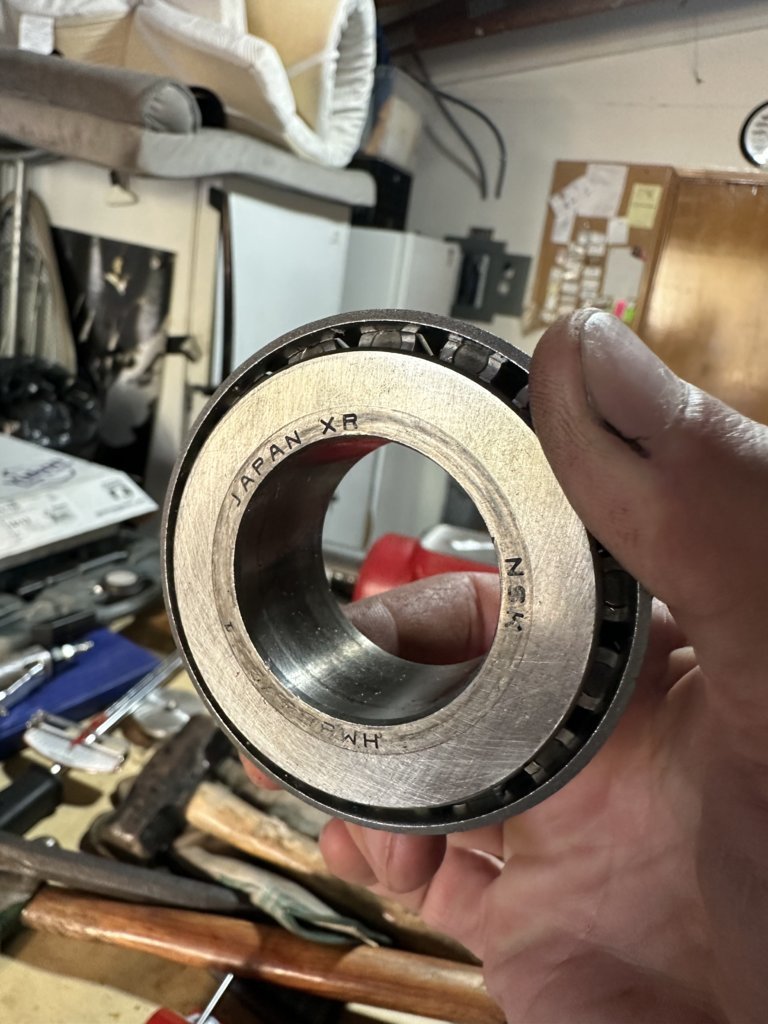

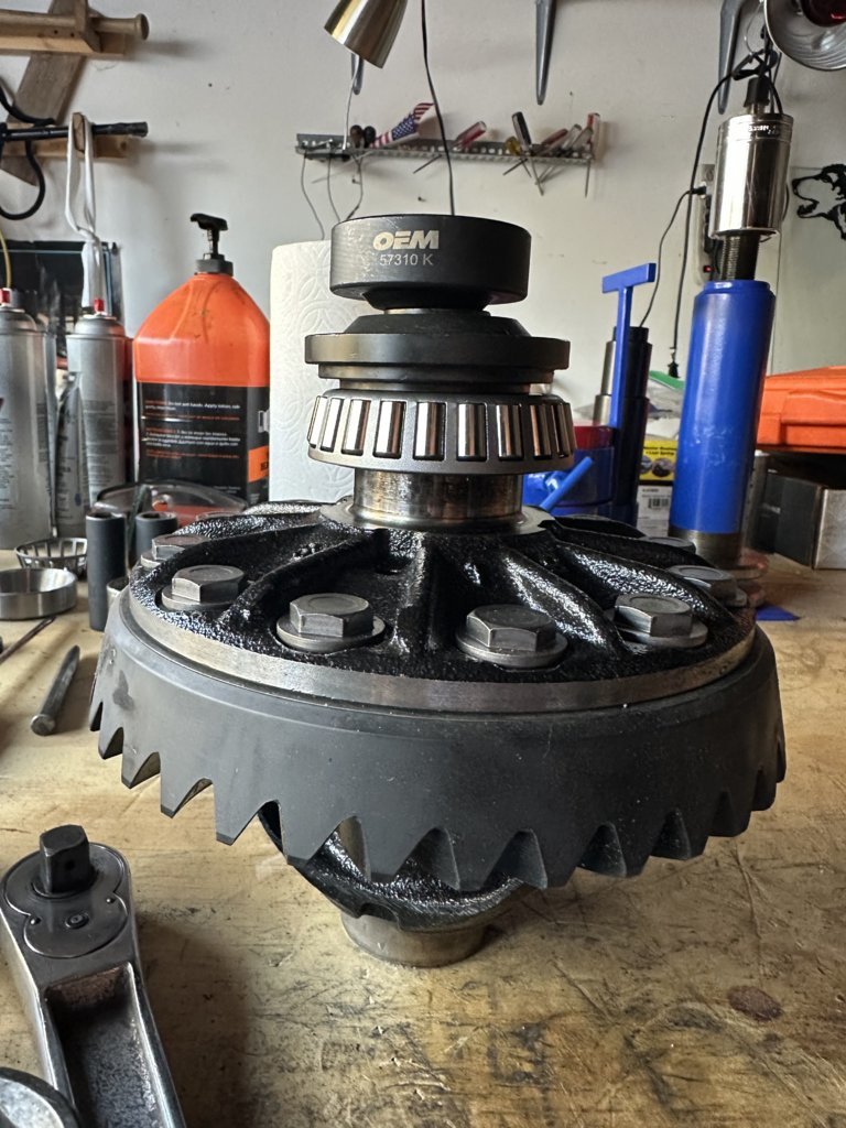

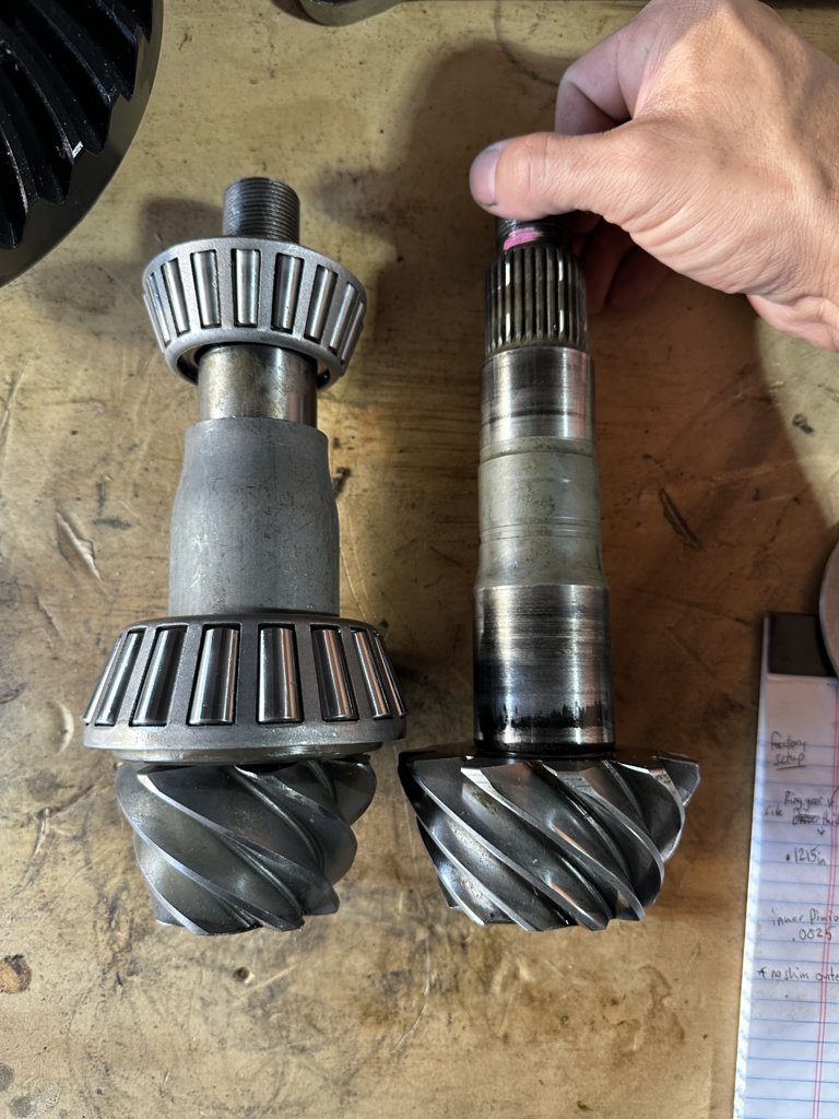

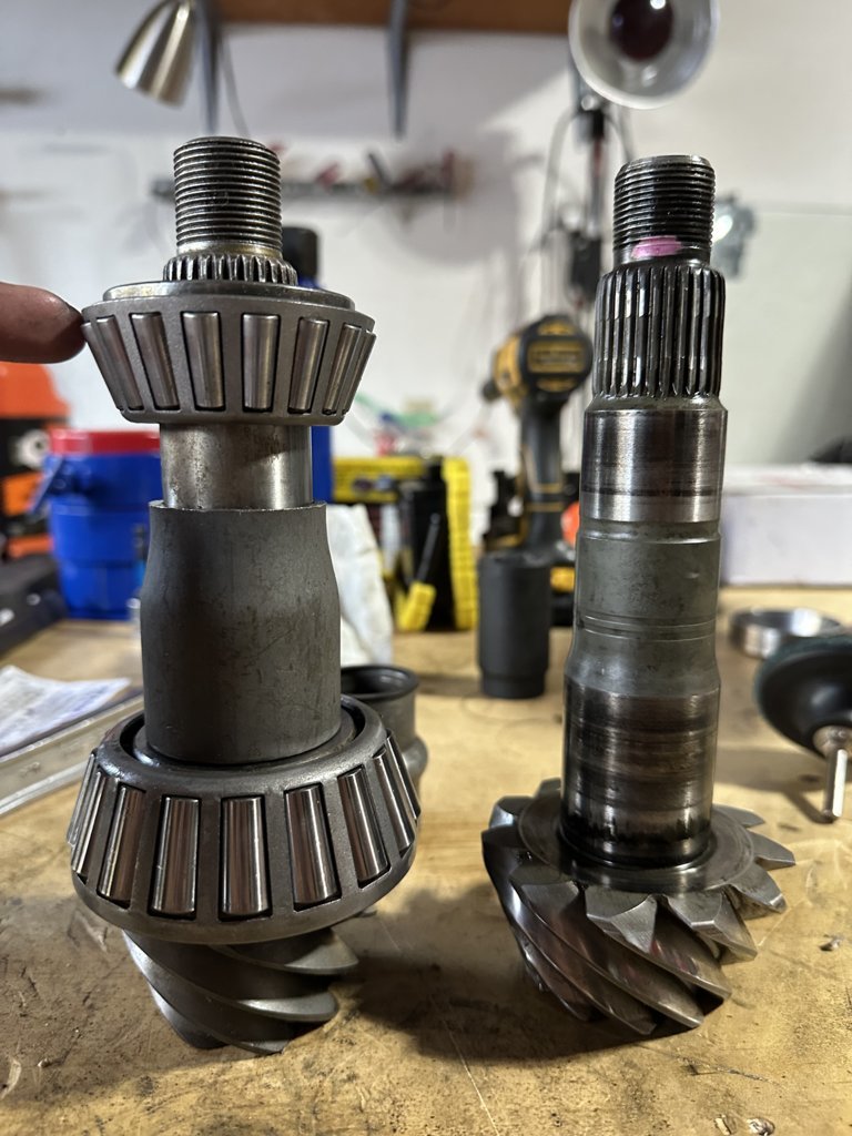

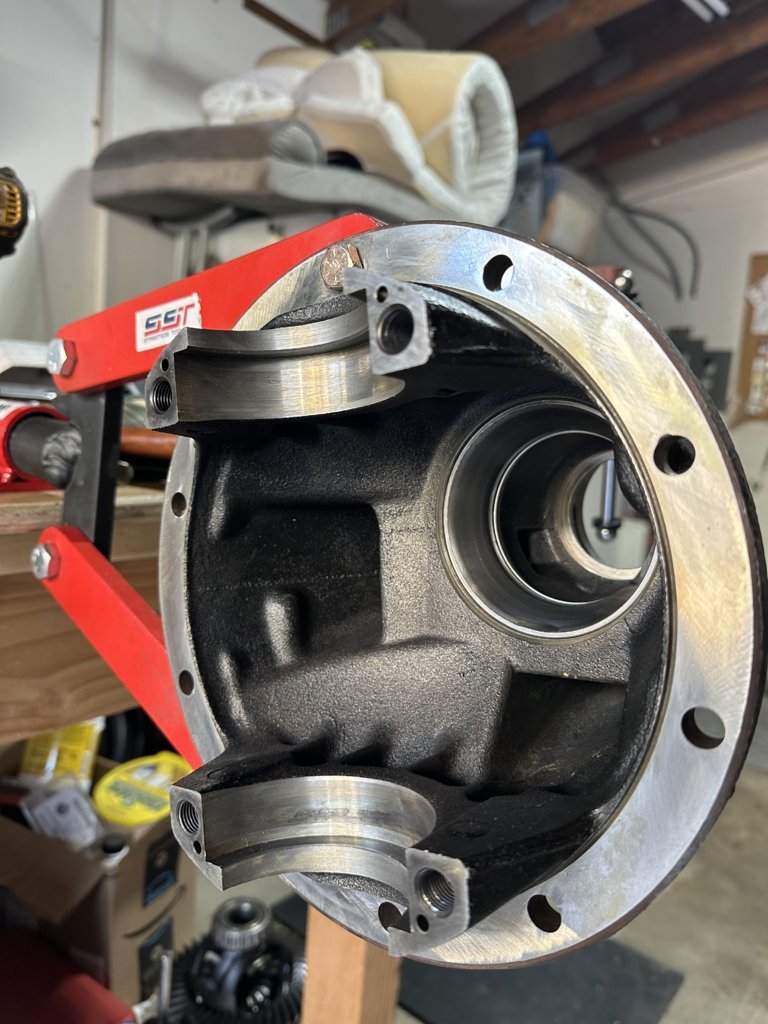

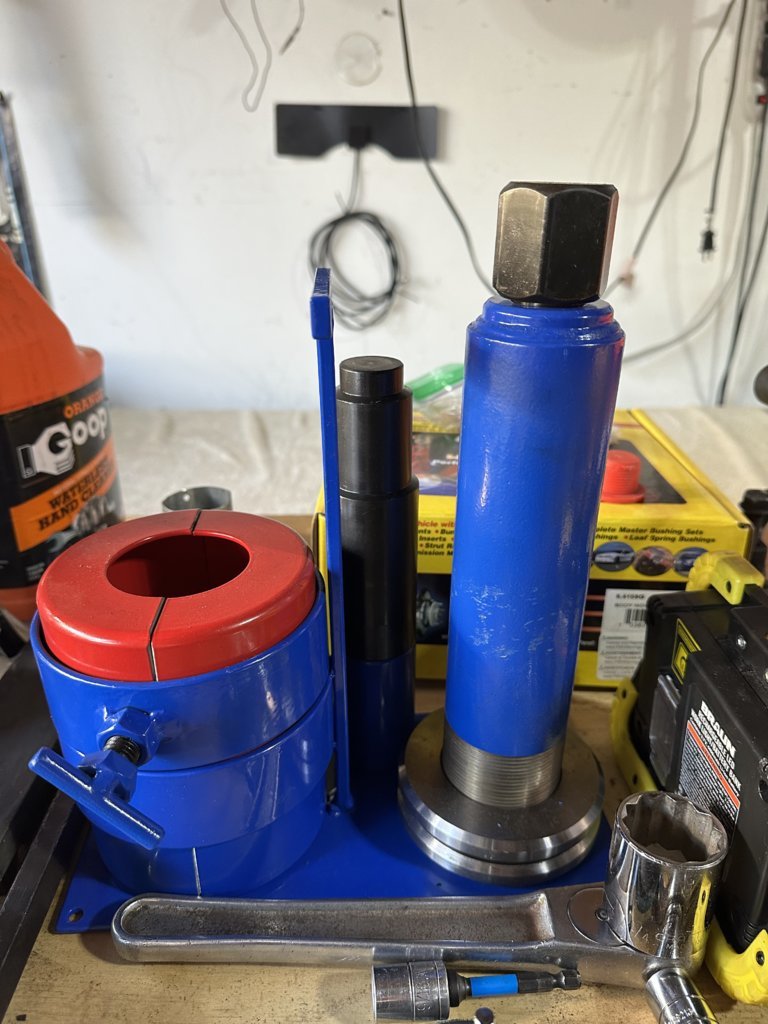

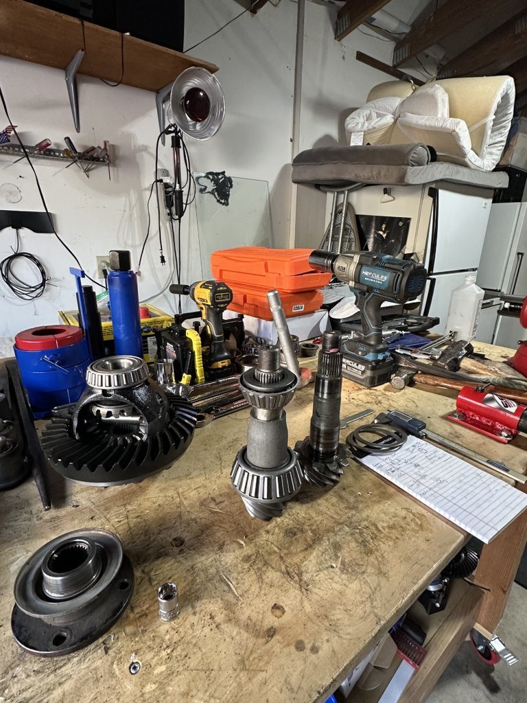

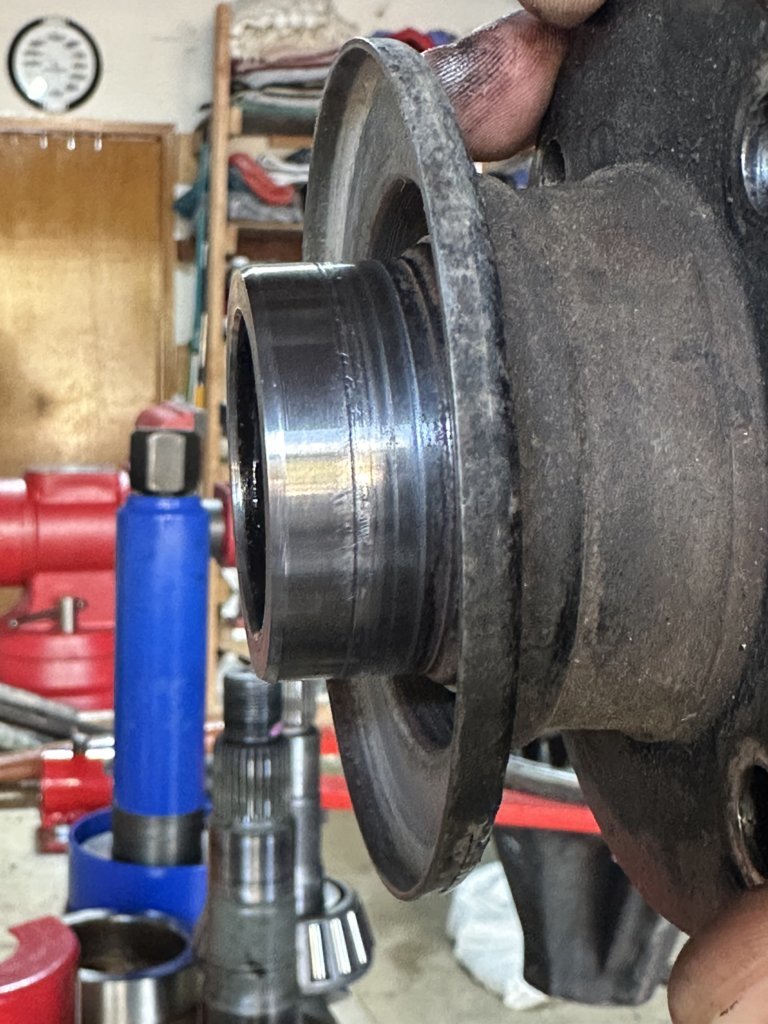

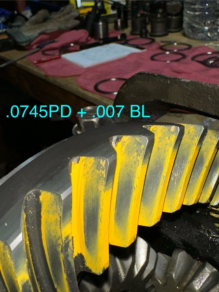

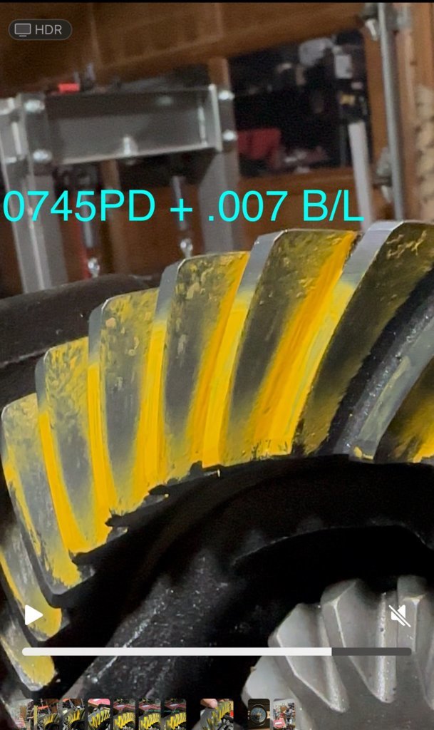

    1st: open carrier prior to pressing carrier bearings
    2nd: toasted pinion flange
    3rd: 5.29 / 4.10 pinion comparison
    4th: outer pinion bearing race
    5th: inner third member housing
    6th: third member in the hand differential holder
    7th: pinion comparison
    8th: war table
    9th: pinion comparison
    10th: yukon bearing puller
    11th: old outer pinion bearing (will be made into a setup bearing)

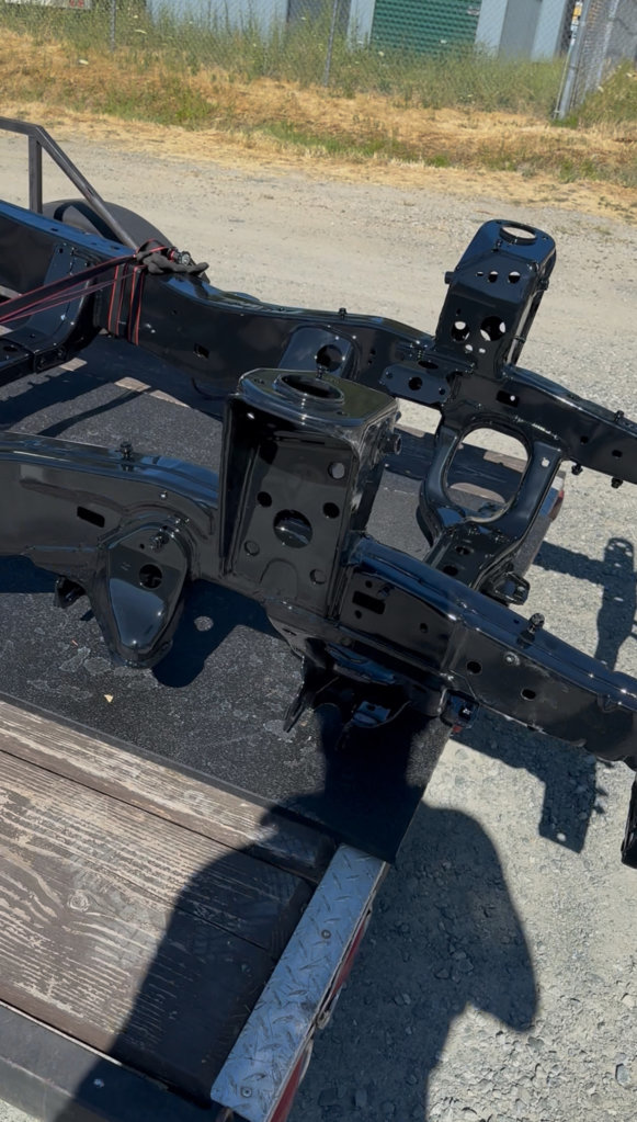

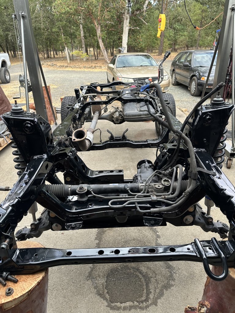

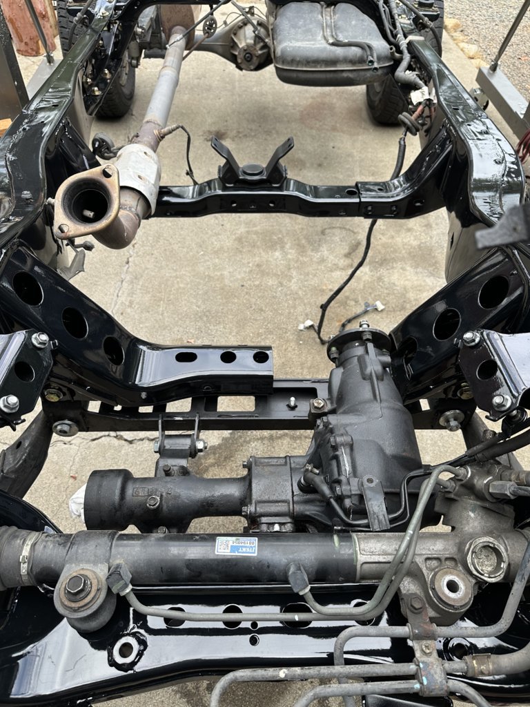

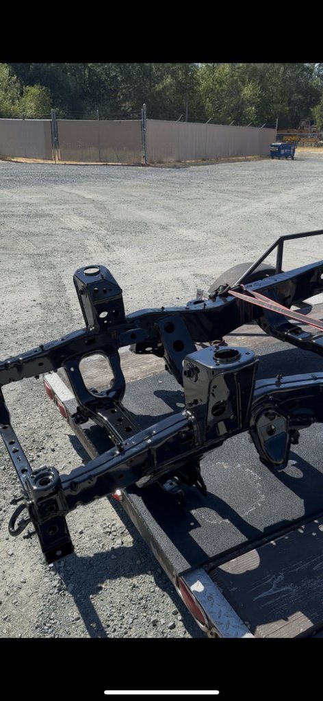

    Alrighty well I worked a couple 12s this week to shave off some of the anxiety from spending as much money as I have on this Toyota. Ended up buying some new coilovers too. Figured it was time since I’d been riding on RC N3 struts for the last few years. Felt like I was riding in a 5 ton unloaded army truck.

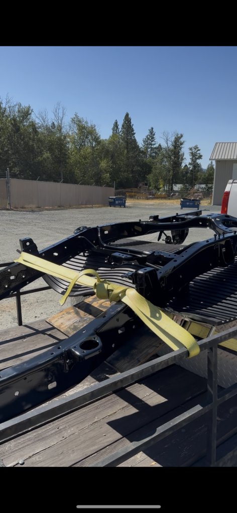

    on a different note here’s a quick snap of the frame I got after I got it loaded up. The picture is a screenshot of a video clip I took of it when picked it up. I’ll get some better pictures soon. I’m super pumped and relieved it’s finally finished. Now I gotta put the sob back together..
    Also, spoke to ECGS and they recommended a new flange but they’re out of them for 6-8 weeks :confused: they gave me a part number though so I might be able to find one elsewhere on the internet.

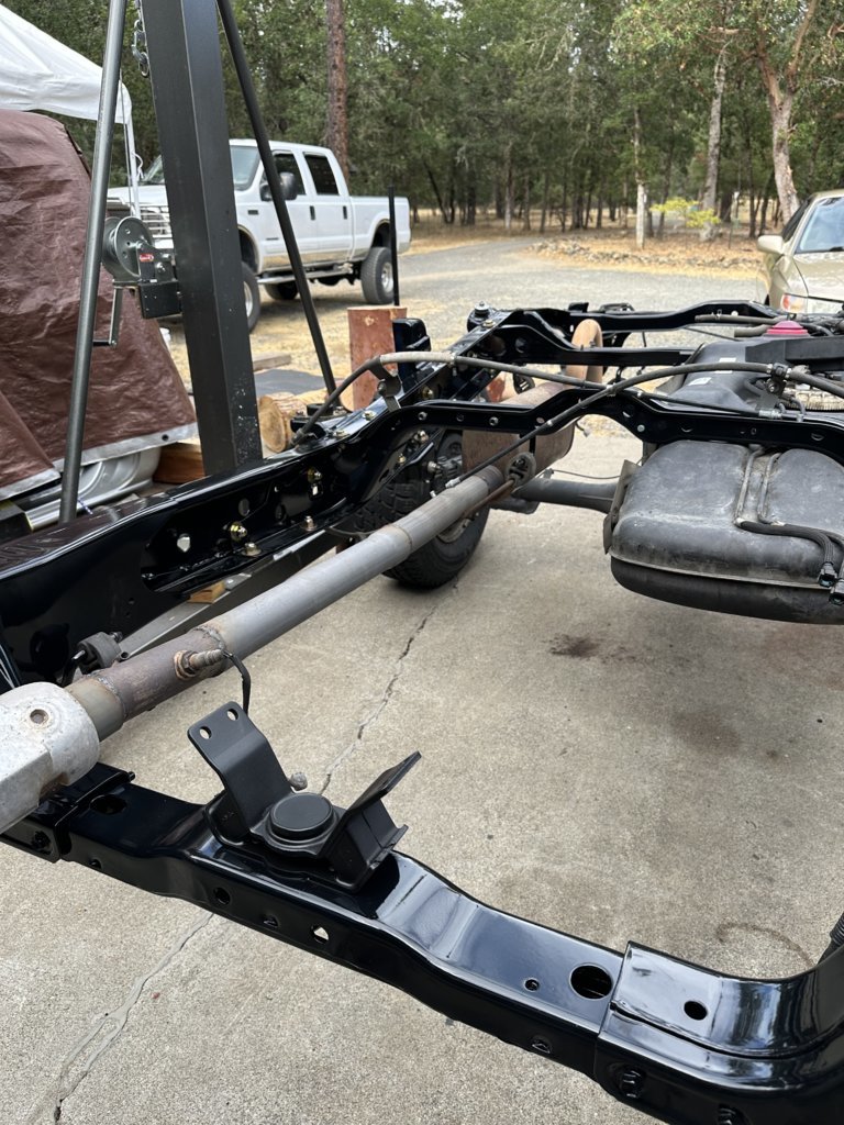

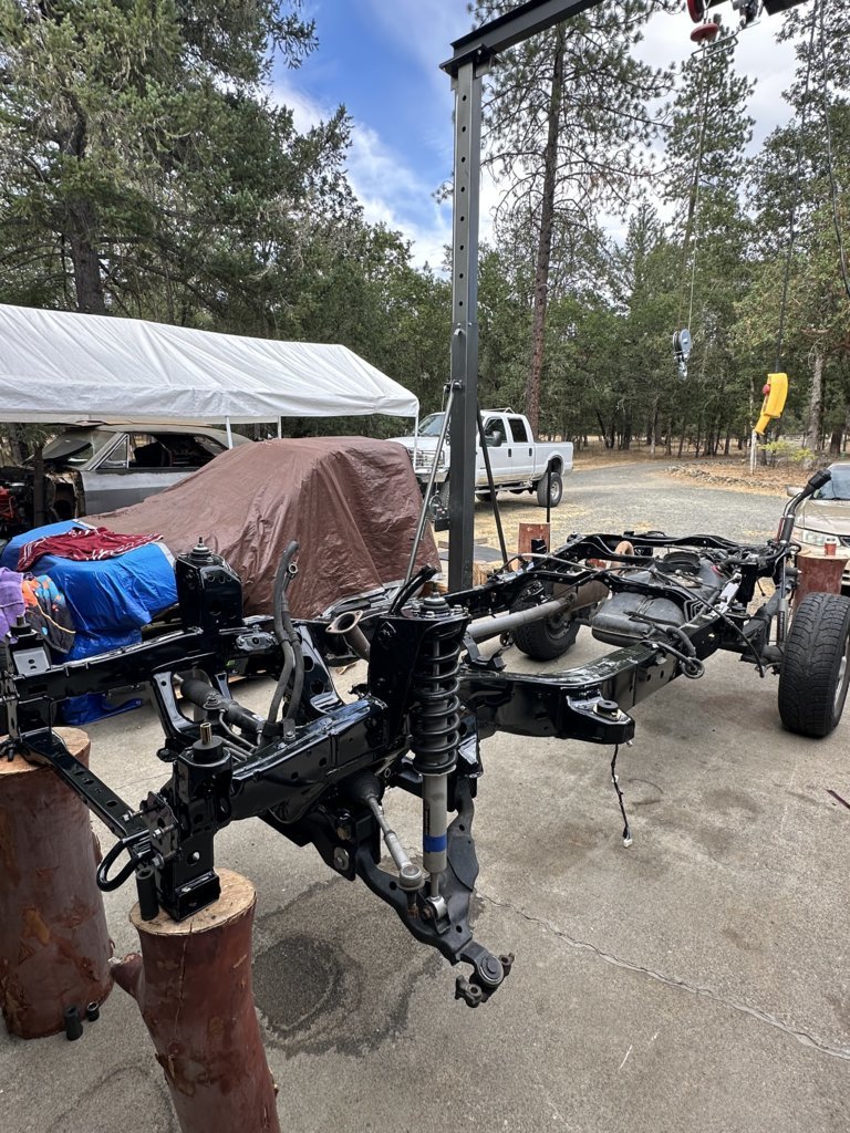

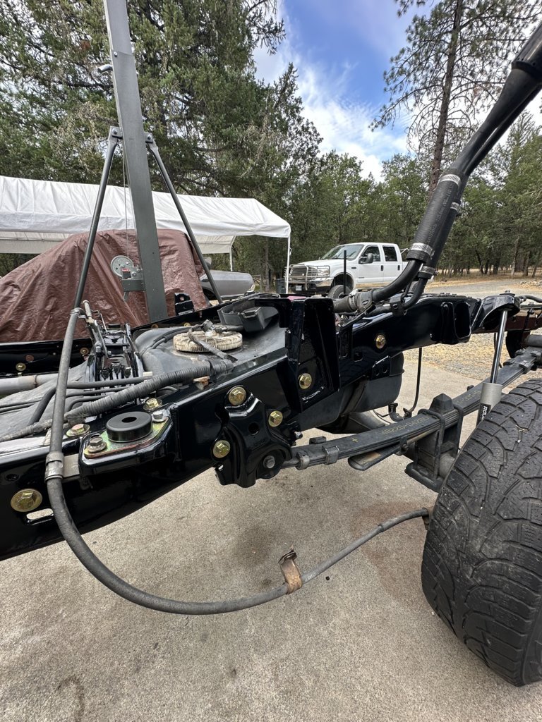

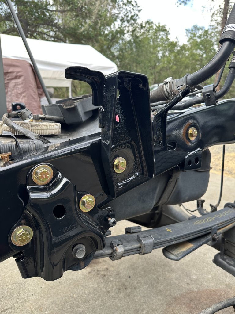

    Here’s a dump of a few other pictures I have. It came out really good. I’m also compiling video clips into a big Timelapse of the disassembly, and some of the work I did to it. I didn’t record the clutch job, nor the cv reboot but no biggy there.
  4. Jul 20, 2025 at 6:13 PM
    #44
    that_06regularcab
    that_06regularcab [OP] 3rd gear wide open in a Toyota
    Nov 4, 2015
    #168631
    310
    Southern Oregon

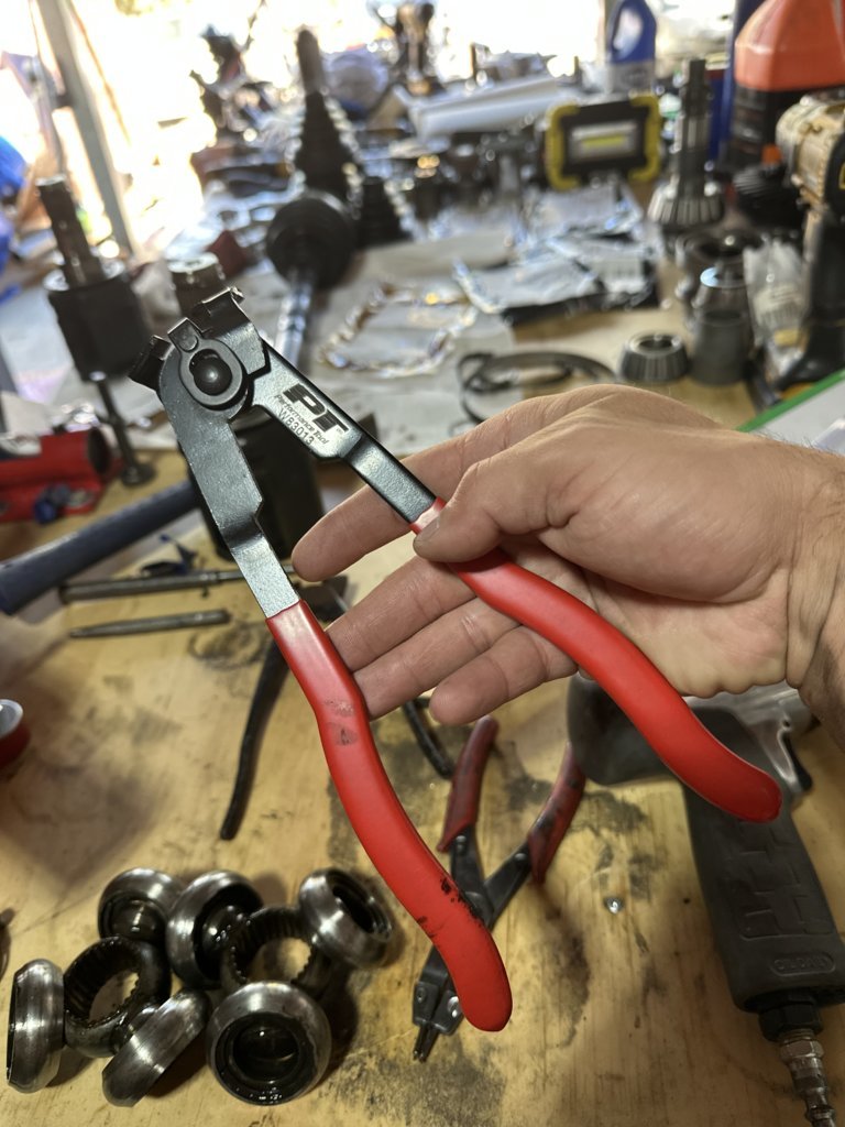

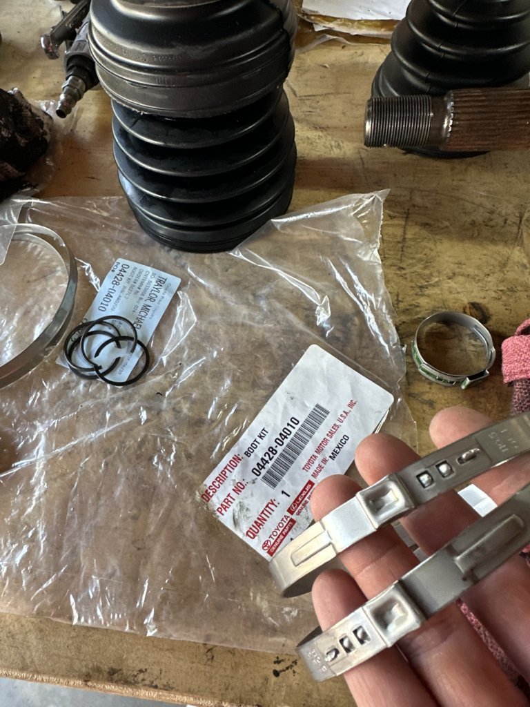

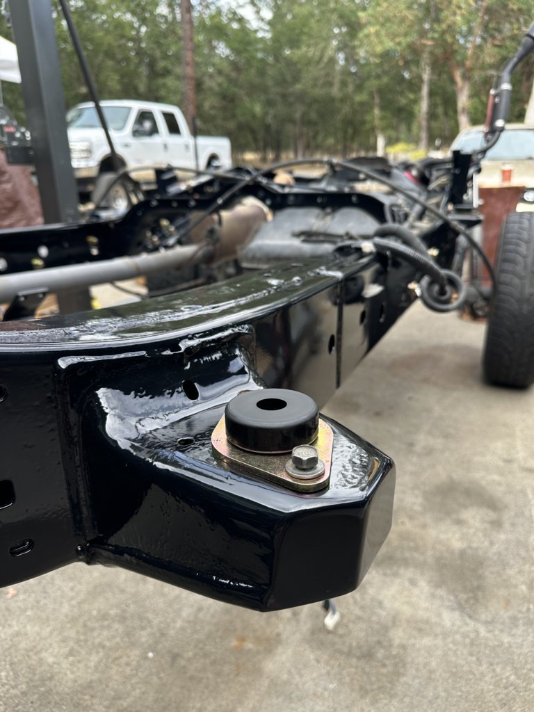

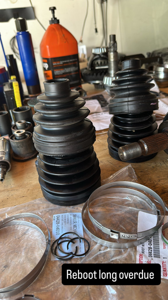

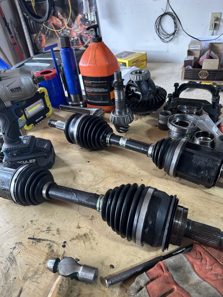

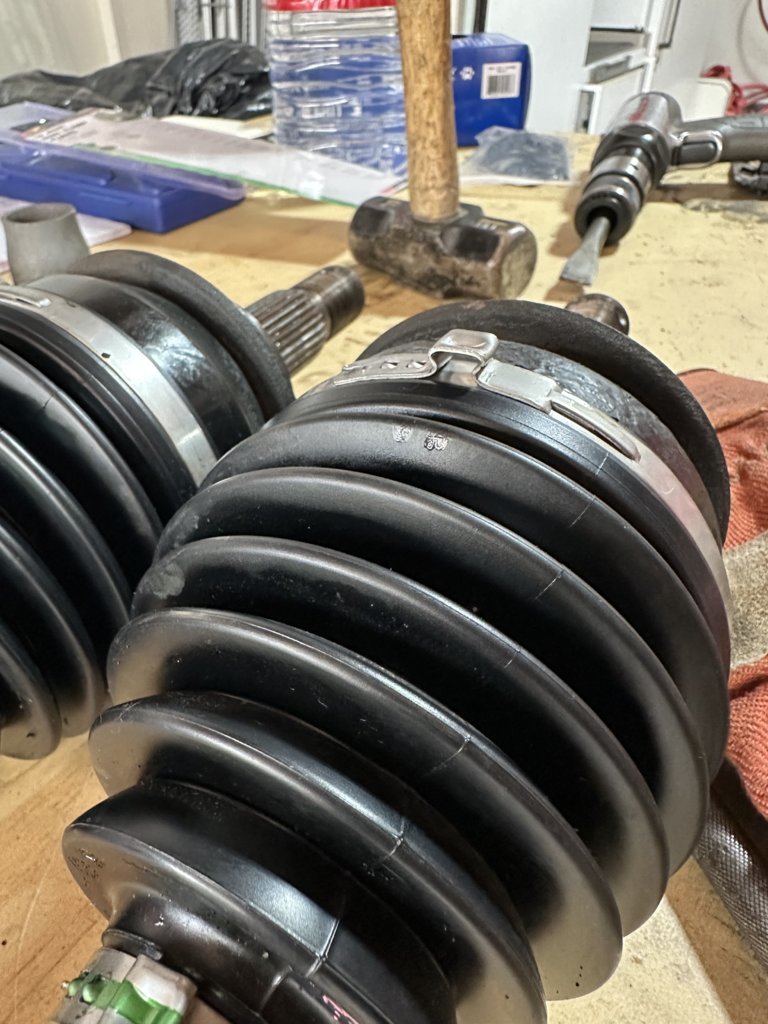

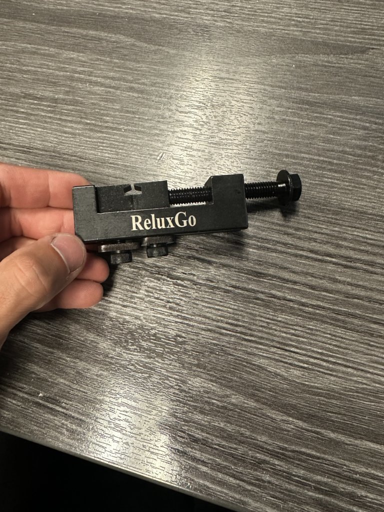

    The cv boot clamp pliers pictured below are worthless as tits on a hog btw. I had to use some snub ended dike plier things I had layin around that didn’t close all the way but they at least helped me get the clamps started. To finish them Im ordering some tool off of Amazon that resembles the actual Toyota tool. Aside from that I also have some updated pics of the frame and it’s current state of assembly.

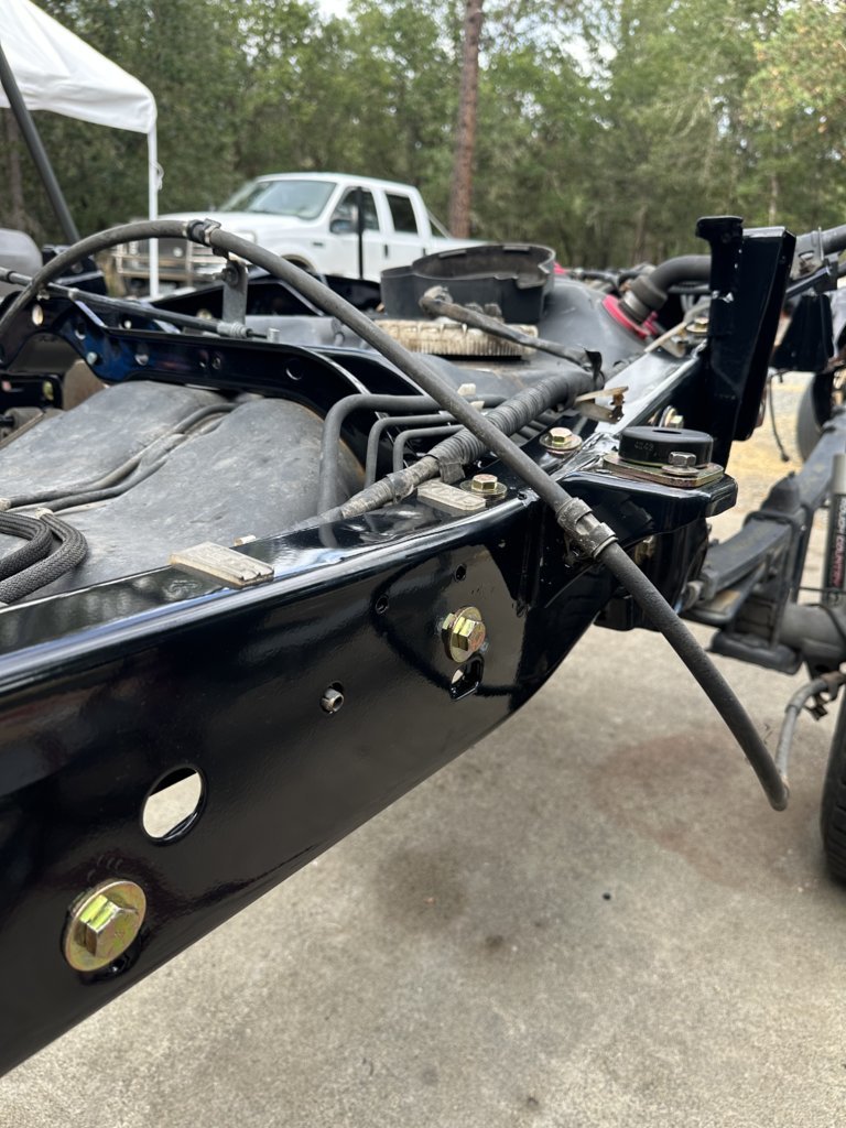

    You’ll notice a decent amount of grade 8 hardware on the frame and this was due to having to remove the laminated sections of the frame so that we could effectively sandlblast and powdercoat not only just the outside faces but behind the backs of the steel as well so that if any moisture was to get back there it wouldn’t be able to rust out from in between the sections.
    I approached this project with the intent and goal to never have an issue with rust ever again because I planned on keeping the truck for a long time. It’s just been to damn reliable to envision selling it.
    another factor in the decision to do the job like this was because there really arent any regular cab frames laying around anymore. So I just wanted to do what with the funding and time frame I wanted to get the job done in.

    Shoulda seen the cv boots before I rebooted em. They looked like hammered cat shit..

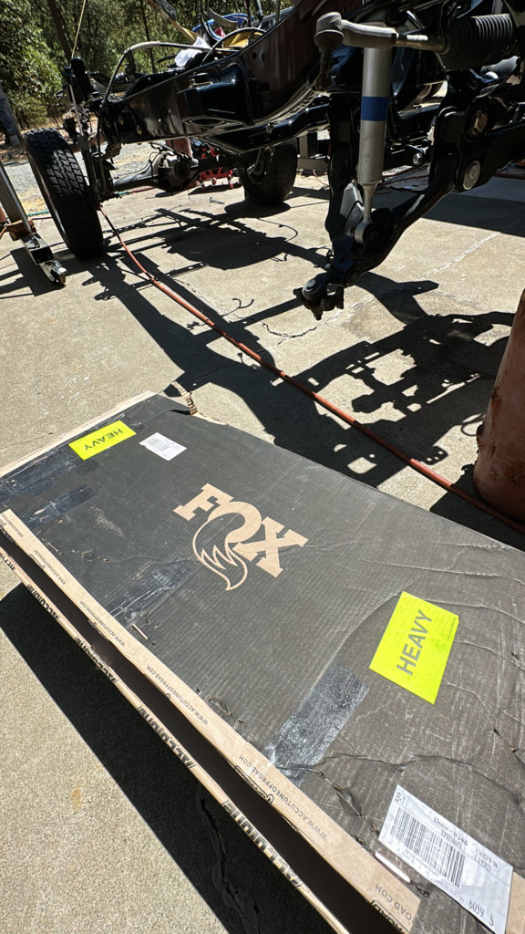

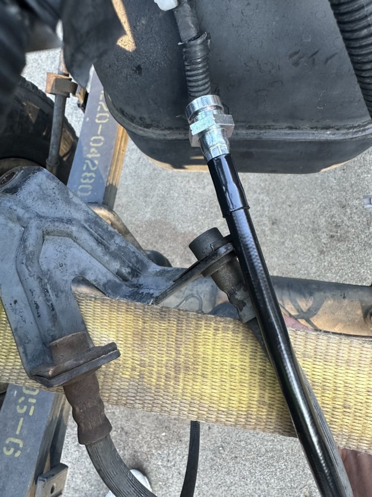

    Quick photo dump. Recently received some more parts and tools for the build.

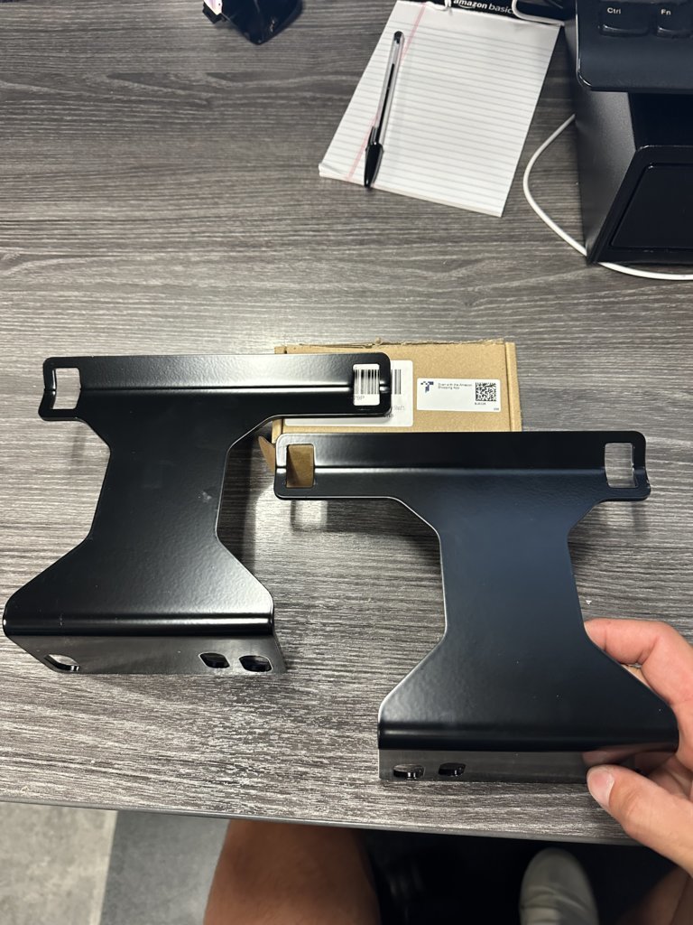

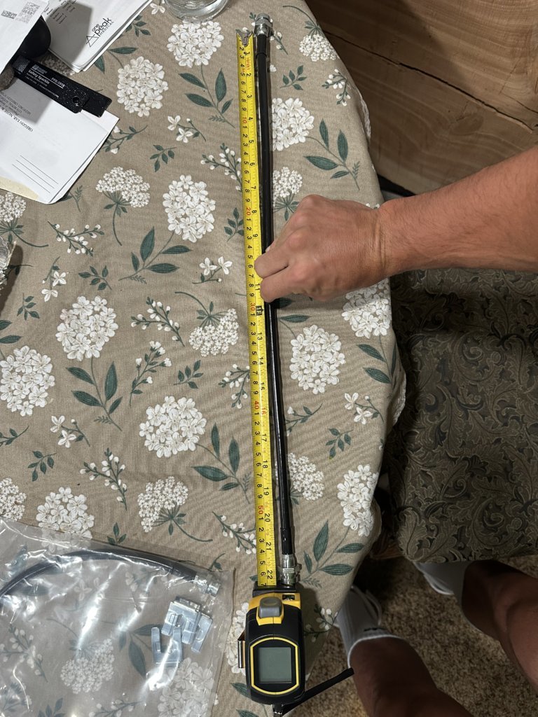

    I received the fox 2.5s from accutune but still waiting on the rear fox 2.0’s. I also ordered the crown performance extended brake lines from Accutune that are marketed as 4” longer than stock for 05-23 model Tacomas (turned out to not be accurate for all models), some hammer hangers, archive garage shackles (3.6”) and some rear shock boots. Was looking at doing a u bolt flip kit when I got around to ordering the leaf springs but opted to hold off until I got to that point.
    wasn’t too thrilled that the brake lines weren’t actually 4” longer than my factory brake lines. They were only just barely under 2” longer than my factory brake lines. I spoke to crown performance and they told me my factory brake lines were 20” so I ended up having to ship them back to accutune. I’m not sure what was so special about my truck but it’s a regular cab so maybe that’s why.
    so if you’re in the market for some brake lines I’d maybe call whichever manufacturer it is who’s lines you’re looking at and see if you can get clarity before purchasing through a distributor and save yourself the extra money in return shipping!

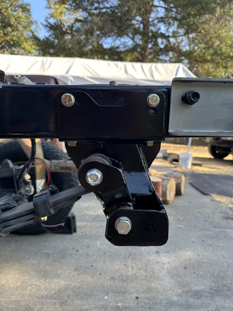

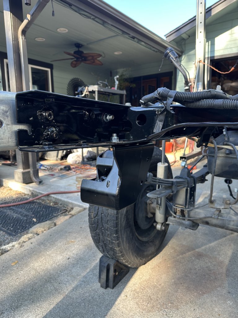

    Aside from that I got some factory race reservoir mounts to mount the resi’s horizontally on the frame and I think I’m just about ready to button up the 529 open diff regear. I was able to get a good pattern with my setup race and setup bearing. Got the pinion preload at about 12in Lb’s. Now I just gotta toss the carrier in and run a pattern again to make sure the pinion depth agrees with the final setup. Then I’ll install the pinion seal and torque er’ down.
    I’ll get some pictures of the hammer hangers tomorrow too— those things are stout!
    I’m also ancy to get the motor and trans in the chassis but the powdercoater has my upper control arms held hostage so I’m kind of at a stand still here as far as what I can do. I might actually just install my factory UCA’s with some old 5100 coilovers so I can get the motor and trans bolted up. I can swap the UCA’s and coilovers out for the new stuff later when powder finishes what they need to do so I can continue working towards getting the cab back on.

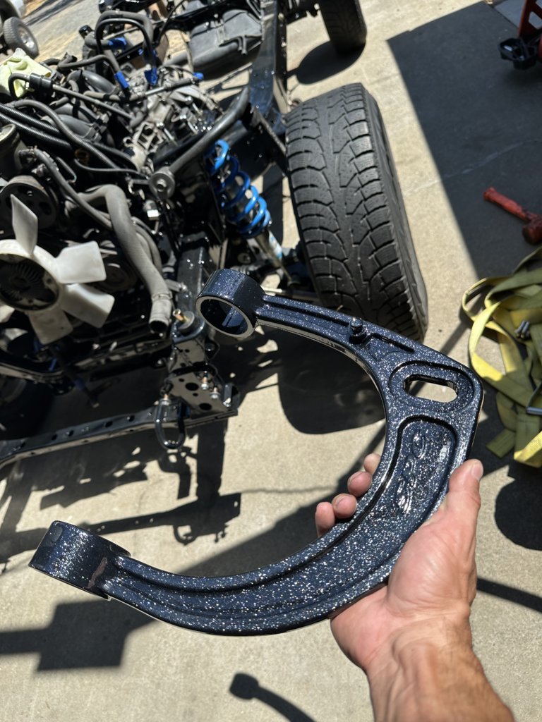

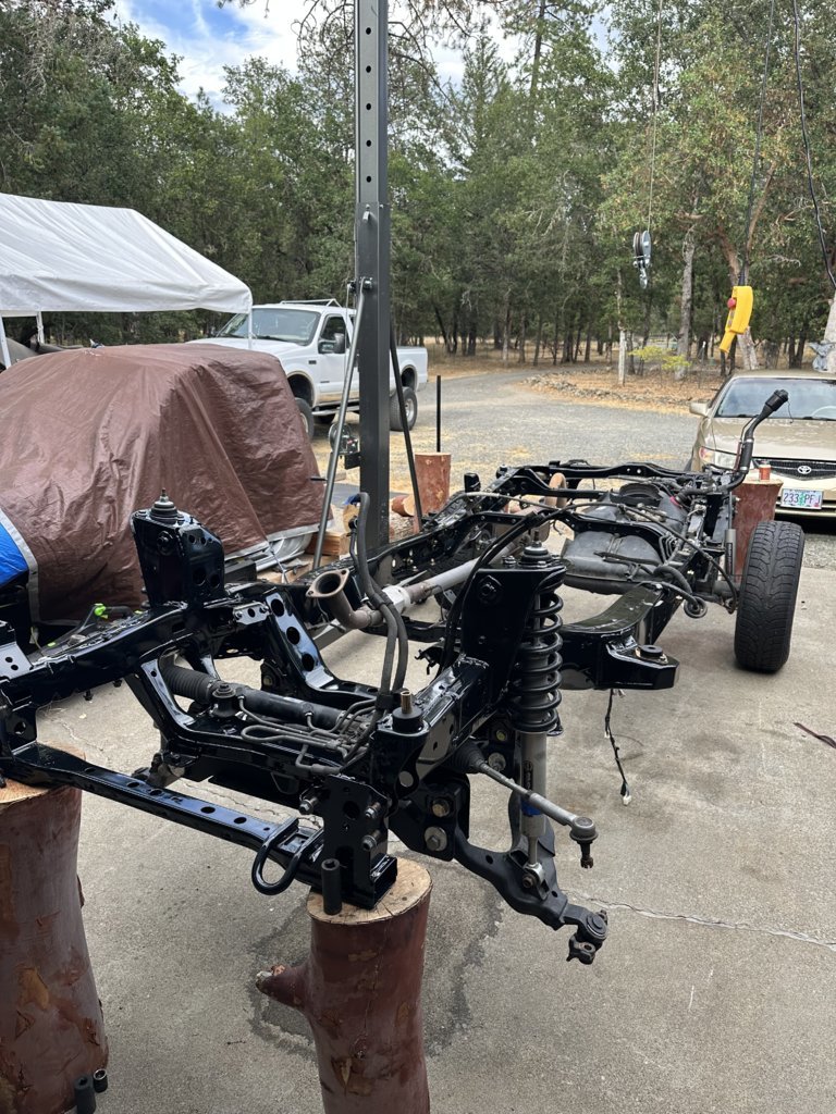

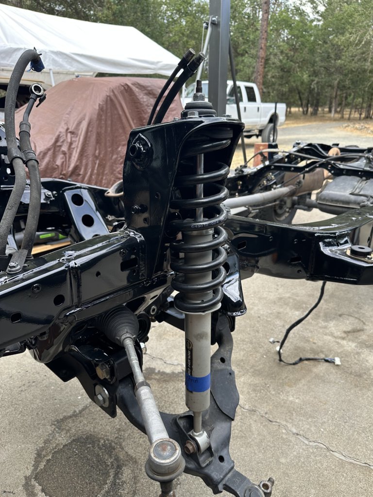

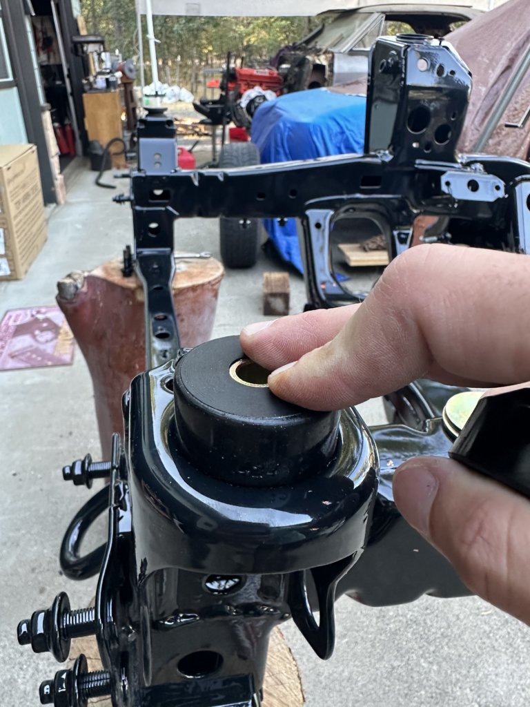

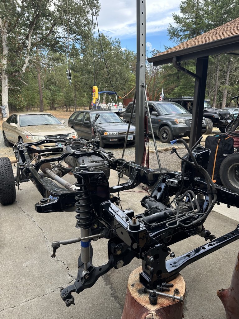

    Picked up my UCA’s + sway bar yesterday. Dropped the motor/trans, pressed in the new uca bushings, and started torquing some bolts.
    I was able to install the new coilovers but they’re so firm that I can’t get the LCA to compress enough to get the UCA connected. So I’m wondering what my next magic trick will be to get those bastrds on. Maybe I’ll drop the cab on the frame with the knuckles free floating to get the suspension to compress an inch or so if I’m lucky lol (smh)

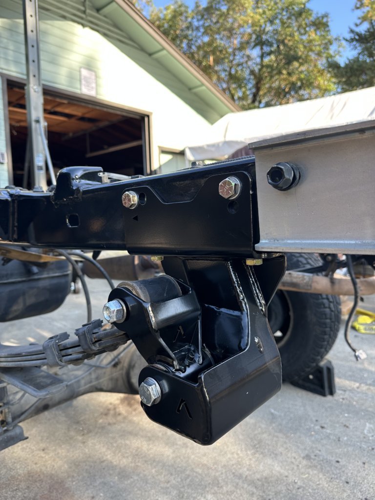

    Couple pics of the hammer hangers that I forgot to post yesterday too oops. Still torquing the bolts I’ll knock that out before I go to work today
