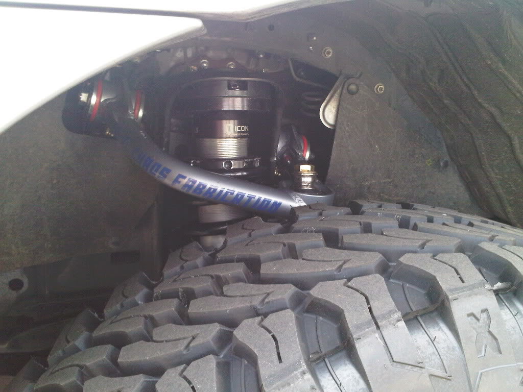

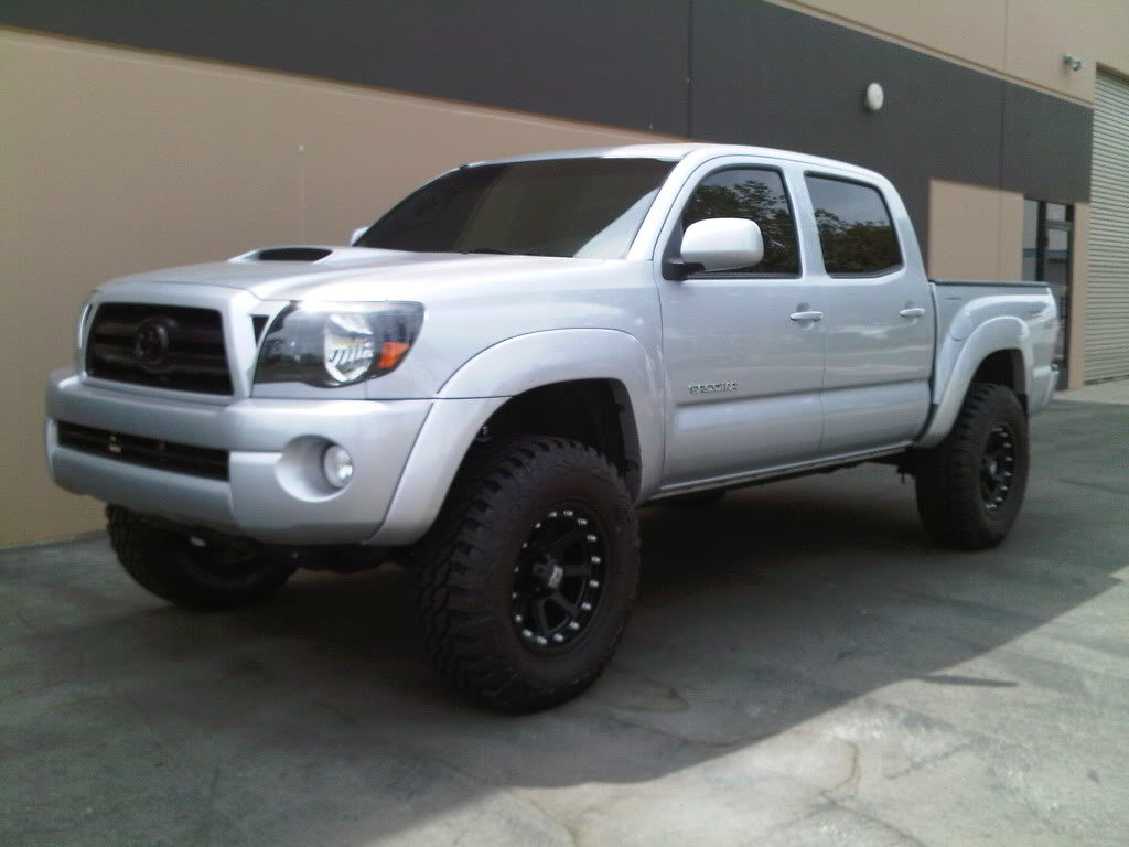

    Hey guys-just wanted to post up a quick pic of my truck that I just did the Icon 2.5 c/o TC uca and 1" billet spacer.. Rides perfect!! Thanks to jeremy @ Icon for the help.. I was in corona at my brothers house and stopped by Icon facility to chit chat-great guys, bitchin product!!!:D

    looks great, what size are your tires?

    pro comp xtreme m/t 285/70/17 true 33"

    what is the height difference between the front and rear with your current setup?

    right at 1/2" higher in front.. a little more sag on the driver rear-must be because of the gas tank being on that side.. I will be cranking the front up about another 1/2" higher to give a little more clearance for my tires..

    How does your set up ride?

    So its almost even all around? Makes me wanna give it a try again on my truck. Any chance I could get you to measure from the ground up till it meets the fender and post your measurements?

    rides awesome, very little change over stock to be honest.. and im sure off road it will be 10 fold nicer..
    as far as height- i never measure wheel well lenghts-very unaccurate.. i measure ground to start of pinch weld front and rear cab.. front 21 1/2 and rear 20 1/2 pass rear 21 driver rear.. keep in mind I will be cranking up more either tomorrow or mon

    reason i think you have no downtravel is because i know you dont have much. stock, the truck has 4" max downtravel. you installed 2.5" lift coilovers AND a 1" spacer on top, which equal ~3.5". its simple math, you have max 1" downtravel. now, if you set your icons w/ 0" lift, then yes, you still have ~3" downtravel and i am wrong and i take back what i said, but if you left the icons as shipped, i am right.
    not my first rodeo either, i have had several setups on my two tacos through the years, from spacers (spring and on top), to coilovers, to bilstein 5100s...this is how i know you have no downtravel.
    how do you figure you have plenty of downtravel?? and whos idea was it to add a spacer on a racing coilover setup?

    Well let me just start off by saying that when I say "plenty" of travel this is vs stock.. This is obviously NOT a long travel kit nor will I treat it like such.. So for what it is, as it may be a race inspired c/o w/out the rest of the goodies to go w/ it would be improper in my eyes to treat the truck like a race prerunner.. So for what it is being used for it has plenty of travel.. And it was my idea to use the spacer, I don't doubt that you have expirimented w/ your truck and that is great.. But I have built full race prerunners at my shop as well as long travel rails.. This is nothing new to me.. Trust me- when its time for me to do what I need it to do I will change it.. But it works perfectly right now and most people would be stoked w/ the setup.. Anyone in the vegas area is welcome to come by and go for a ride.. I'm easy bro- just doing a setup that works for me under the circumstances..
