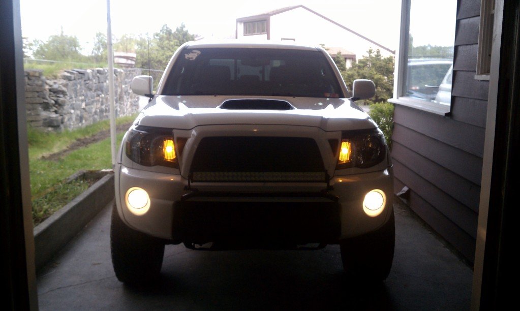

    decided i wanted to have my DTRLs like all the new ones so i just did a little cross wiring (aka tweet work). turned out pretty good

    Are those headlights aftermarket or did you do the mod with some factory ones?

    i did the lighting mod with the stock wiring harness, but i had to get some aftermarket ones cause a yr ago two of brackets on the light shroud were cracked. but i knw most people do the DIY black headlights

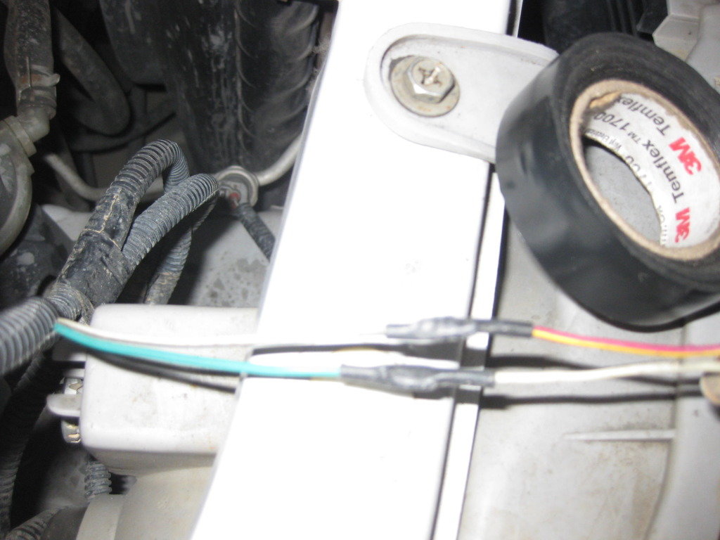

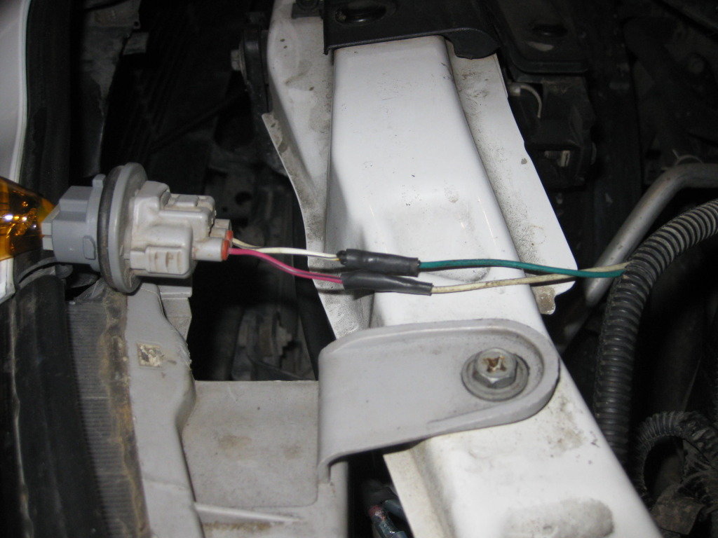

    i just cut the wires about 3 in from the connector to the lights. then spliced the connector from the blinkers to the emergency flashing wires, after that i spliced the wires for the DTRLs/turn signals to the connector that fits in the emergency flashes position. its pretty easy just make sure that your power and ground wires and hooked up to the right wires before you complete everything. i just turned on the blinkers and touched the wires till they worked in the right order. ill put some pics up in a bit so you can see.

    idk if the wiring harness is the same for the access cab as it is for the dbl cab. but this is wat my wires look like. the two connectors both look the same.
    here is wat it looks like on the right side
    and this is wat the wires look like on the left side

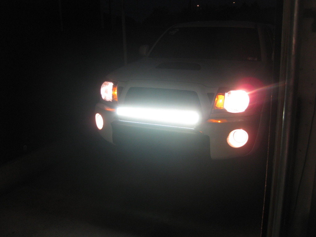

    here are some night shots for ya. i had to wait till midnight for there to be enough darkness to do it and i just turned it on in my garage.
    just DTRLS
    just the light bar
    from the front

    Looks super bright up close. Does it throw light down the road/trail pretty well?

    ya its pretty decent. it doesnt throw as far as the HIDs did but thats ok i have some that im going to put back in my headlights. it has the opposite throw pattern than the Rigid. This one is 60 flood/ 40 spot, the rigid is the opposite. till way better than paying $1000 for a LED light bar this one was around $400.
