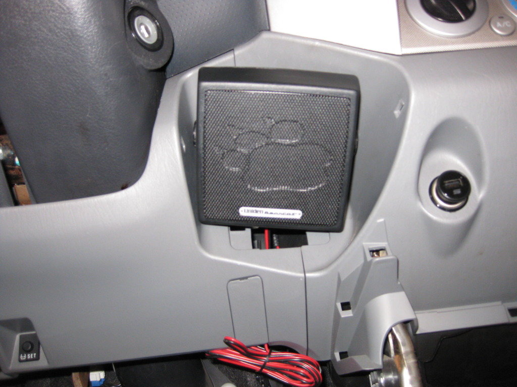

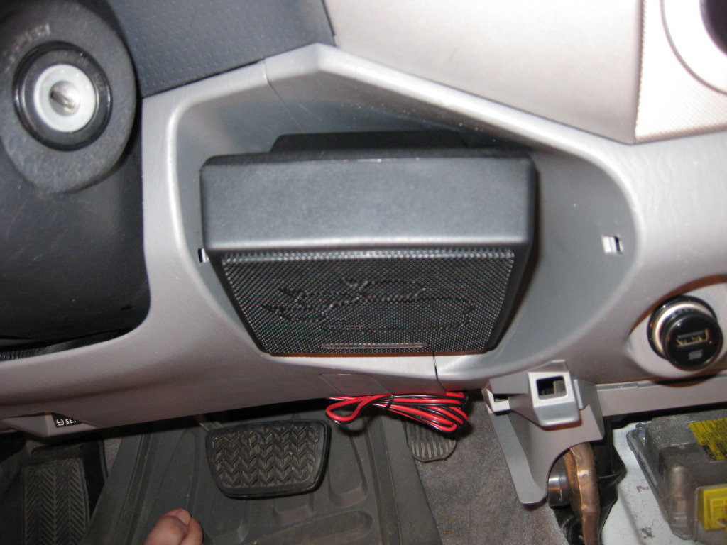

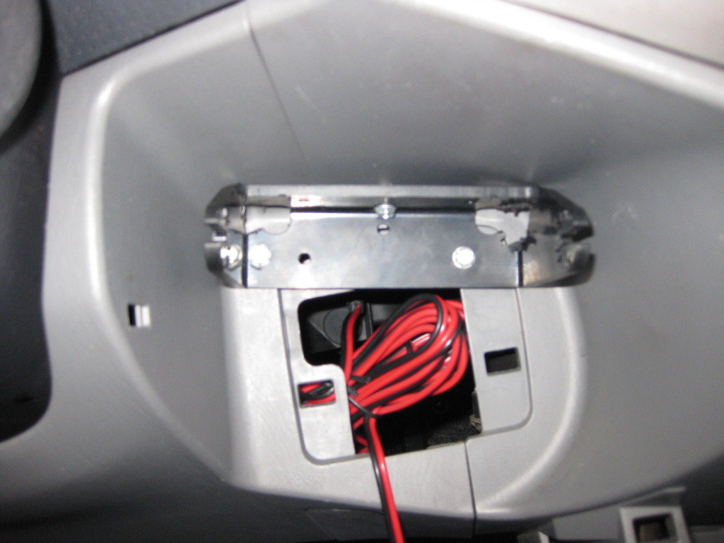

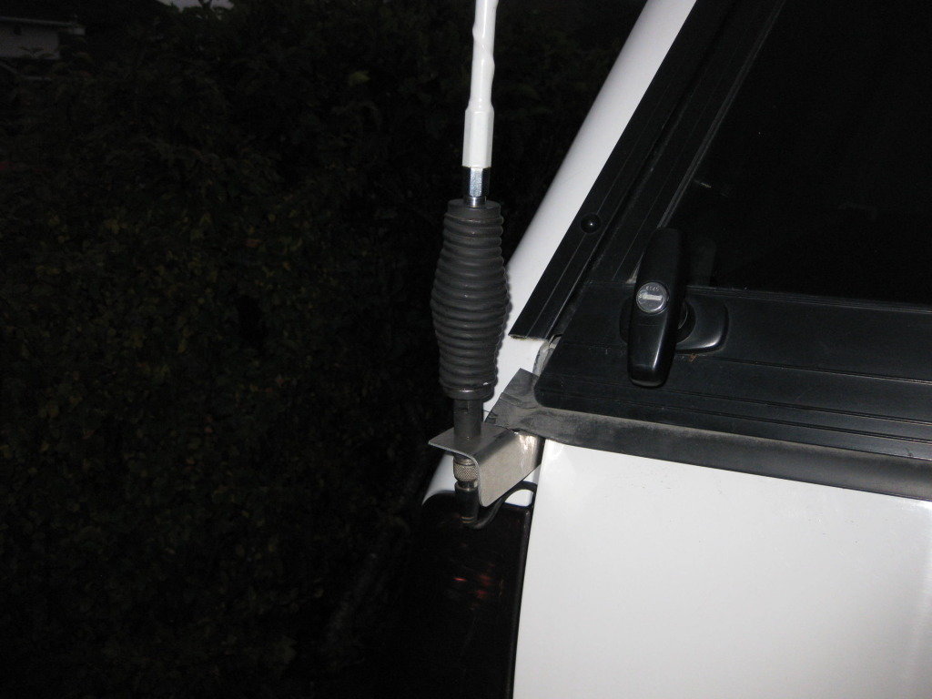

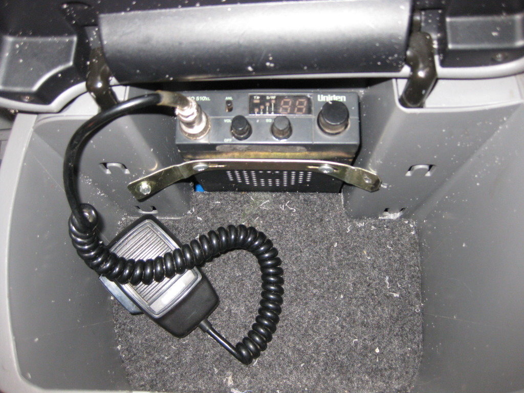

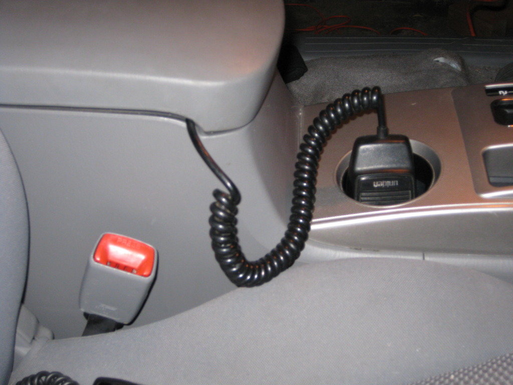

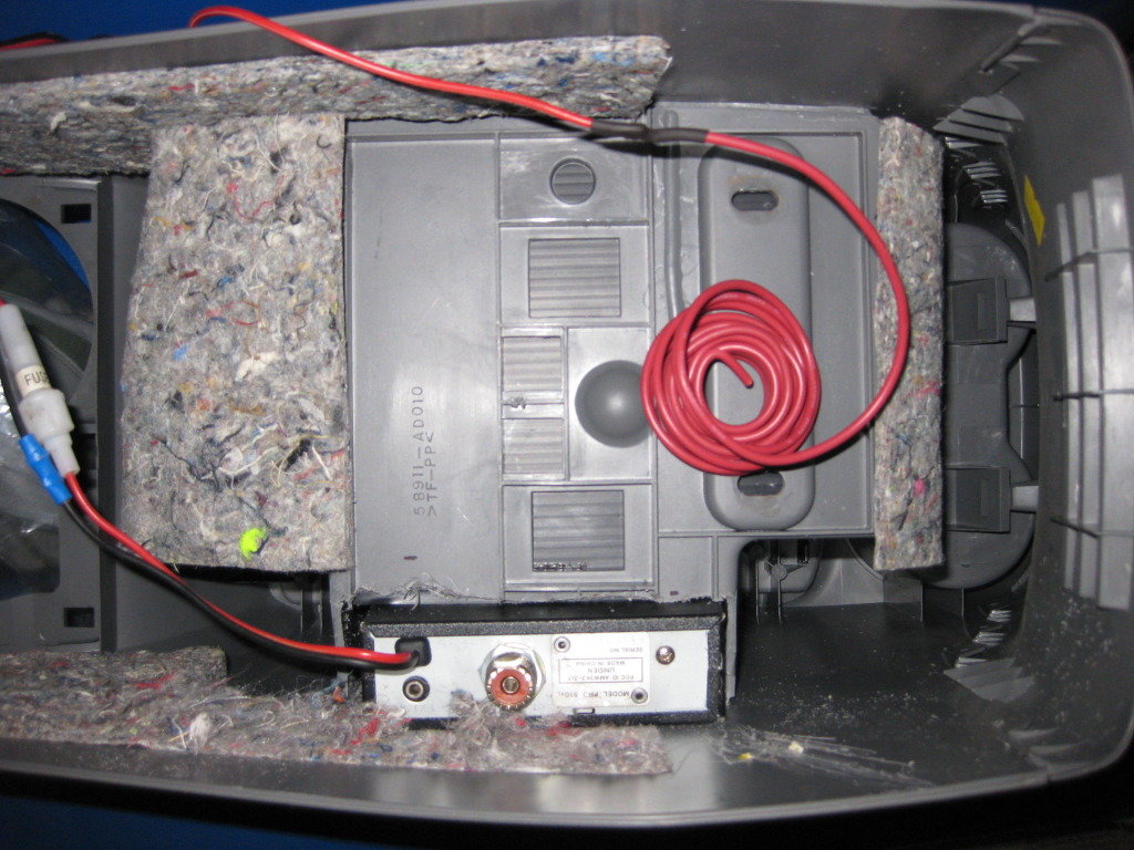

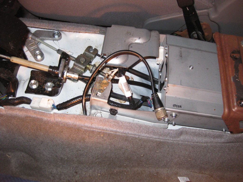

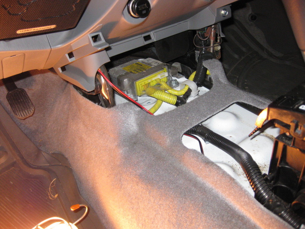

    so the icons will hopefully go in this weekend but i did install the cb and started my sleeping platform build
    took out the center console and ran the coax under the seat
    then cut a hole big enough to fit the cb through the bottom of the console
    then trimmed some of the bracket so it would fit where the change holder was and mounted the external speaker
    IMG_3976_zps8ac3219d_7bdf11b217c4976f51f364a2626f4be649dee527.jpg IMG_3977_zps68d23705_695ce07337e0650343fd4c94095bedd5ceb8655f.jpg ran the wire down the side
    IMG_3978_zps21c3b0a2_3a812882dacefdef8ca2d097dd8bff26fc836d82.jpg ran power and made a ground to a existing ground
    IMG_3982_zpsbf0fd6e3_f84dc68e9aab3343e716a7b5aa0f33fdda17a2b3.jpg put everything back together
    just using the cuphole as a mic holder
    made a bracket out of angle stainless steel i had laying around. painted it flat black after the test fit. and i rain the coax down the inside the frame and out of the left rear tail light
    IMG_3987_zps296b26f3_def5d0a88803e6b806bd19fd64e13ac755636a89.jpg all closed up clears everything perfectly

    Looks like shit...
    Just kiddingman. Looks great! I like the external speaker location, if I didn't have a manual I would've mounted it there

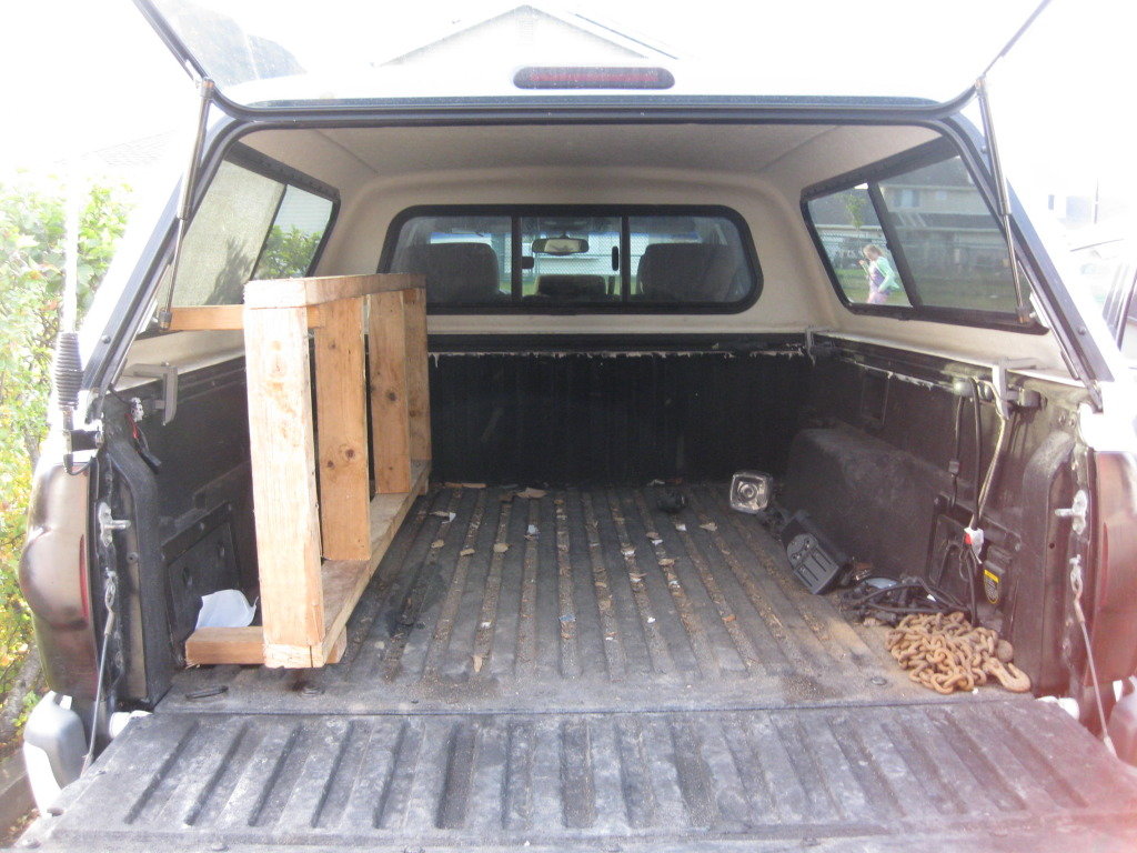

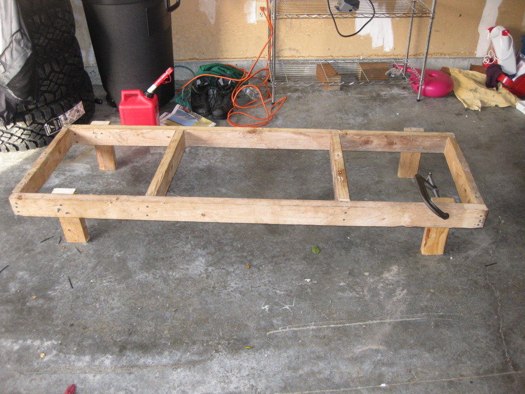

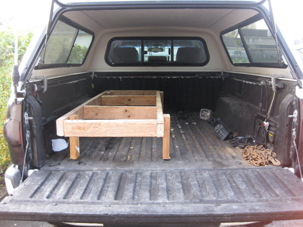

    so i wasnt able to get the platform to hinge like i wanted to but it will be small enough to slide in on its side so i can fit all the decoys, ice chests and gear for hunting.
    IMG_3990_zpsc69b8dec_0aa4ec39f51af11f09ccddf6b9032efad43a5c17.jpg its 6 feet long by 26in wide
    IMG_3992_zps2028c576_d2a50044945a78e76810501c8f332033f9a9b1c5.jpg how it will be with all the gear in the back
    now just need to go to the dump or the wood hobbyshop and get some plywood for free. oh and ya all the 2 x 4s we sources from the dump for free. this only cost me $5 for the screws.

    did u ever tune it when u had it?
  18. Sep 19, 2012 at 9:22 PM
    #158
    CayucosTacoma
    CayucosTacoma Just think outside the Yota
    Mar 9, 2012
    #74580
    5,597
    San Luis Obispo/San Jose
    2004 Double Cab 4x4
    Specs in the Build Thread
    Was my buddies.he got good receptiok but a new swr tune couldn't hurt
