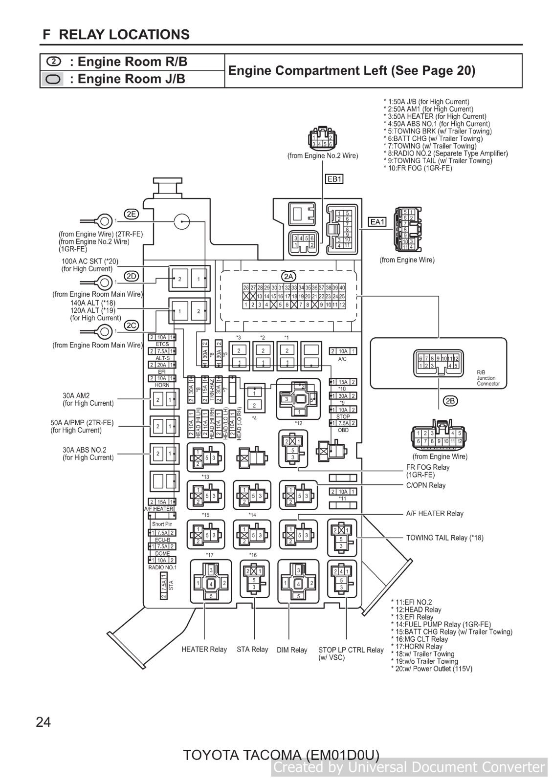

    The MG CLT relay should have power on pins 2 and 5 when the ignition switch is on, the A/C amplifier grounds pin 1 to turn it on.
    You can momentarily jump pins 3 and 5 of the relay to see if the clutch engages.
    Also check the wiring between the lock sensor and A/C amplifier.
    The sensor signal itself can only be effectively checked with an oscilloscope.
