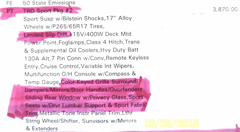

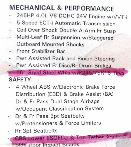

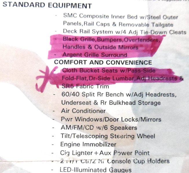

    Found original sticker, here is original info on 2006 TRD Sport #2 Package... thats my original sticker.
    plus...
    The Sport is targeted more towards improved road performance, while the Off-Road is more geared towards the off-road enthusiast. Both are available in 2WD or 4WD, with rear electronic locking differential. The TRD Sport package comes in two levels.
    The first level has a color-matched grille, color-matched front/rear bumpers, color-matched door handles, color-matched mirrors, Bilstein shocks/struts, TRD interior, hood with scoop, A/C inverter in the bed, bed rails with cleats, stainless steel exhaust tip and 17" wheels.
    The second level includes the above and also adds a towing package, oil and transmission coolers, heavy-duty high output alternator, and an aluminum skid plate. The 2005 to 2008 model years came with a mechanical true limited slip locking differential. The 2009 model year onwards has an open differential with a brake assisted "automatic limited slip" rear differential, similar to a VSC system...
    But, I have to ad, that almost all of that stuff listed has been upgraded :)
