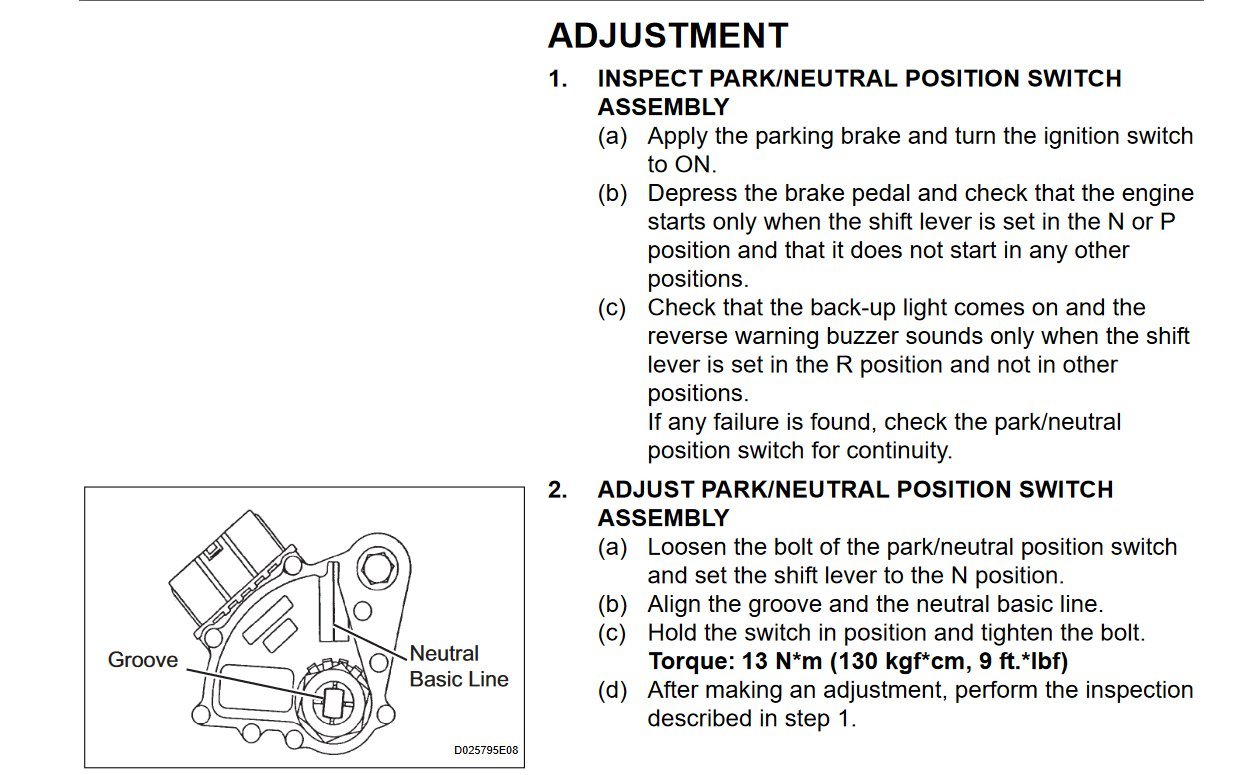

    Does the Neutral Safety Switch indicate properly when you move it through the gear positions. It must be adjusted properly to work.

    Yes I did. everything you mention I did. All the gears register correctly on the dash board.

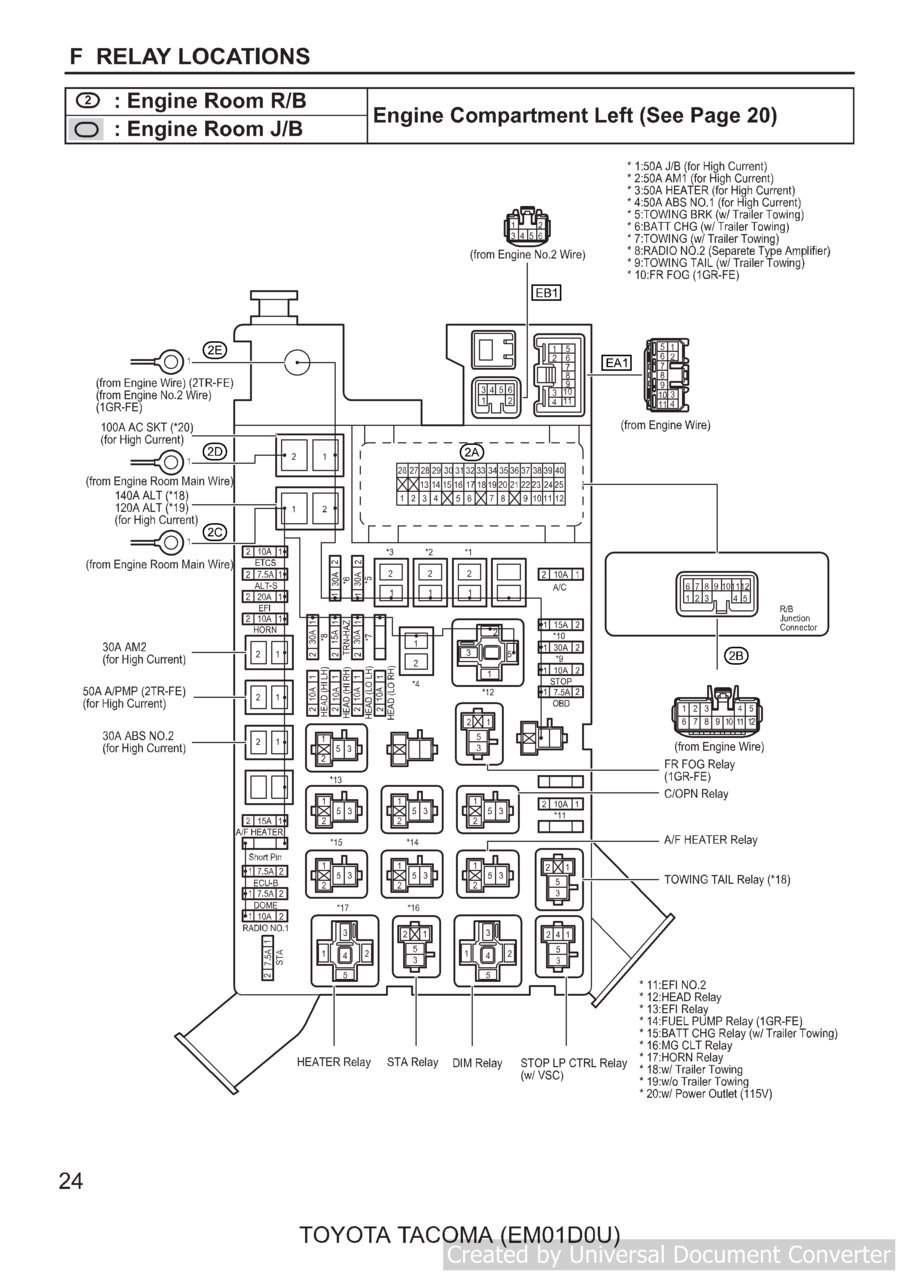

    You need to check the relay pins with a test light.
    Test light connected to battery negative it should light on Pins 1 & 5 with the key in the crank position.
    Test light connected to battery positive it should light on Pins 2 & 3 at all times.

    Dm93, Thank you for the schematic it will help a great deal. I will try what you mention and report back.
