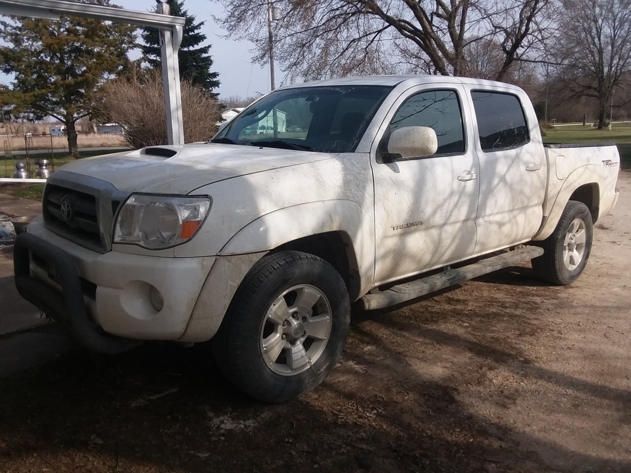

    Hey y'all, I just bought my dream Taco a few months back. High mileage but always been dealer maintained etc.
    I'm a off road kind of gal.... took it mudding in the quarry today and it performed well until I went to turn while in 4hi. Loud popping noises! Is it my axle? Doesn't do it in 2x.. thanks for the input!

    How much were you turning? And you were on mud? Most likely axle bind. Turning too hard and the wheels caught traction

    @NYCTaco52 Was turning pretty hard and tight and yes, in the mud. My mechanic has it now. This past week he's put in new axles and wheel bearings. Told me not to turn so sharp
