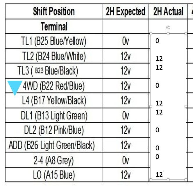

    Your issue seems to be here

    Still trying to figure out how the TL switch are in 2WD position. Yet the 4WD detection switch is not correct. Gear slippage would have to occur. That is if the shift rod is in the 4WD position. Either the transfer case is in 2WD or we have internal issues with the actuator or a failed 4WD detection switch.

    Correct, it will not unlock the ADD until it sees the transfer case shift (4WD go to 12v).
    We know the actuator moved and compressed the wait spring because TL1 TL2 and TL3 are correct for 2wd but the shift fork in the transfer hasn't physically moved according to the 4WD switch.

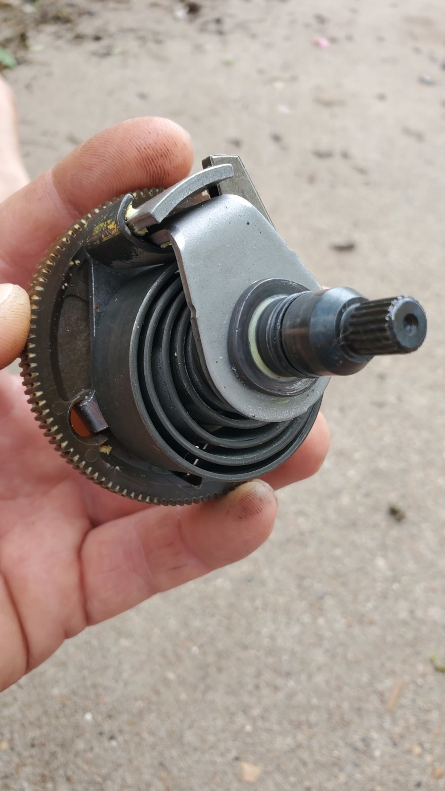

    Just for reference this is the wait spring mechanism I'm referring to.

    So, I pulled the cover off and the damn spring mechanism came out too, along with some fluid. I was able to get it back in and manually moved to what I thought was 2wd. Ta-da, back in 2wd. I switched it to 4wd, good. Then, I moved out of 2wd...good! The freaking gasket cracked so I'll need to get another.

    Plastic gears compress that big spring. LOL
    Must be some good plastic.....
    So far, we haven't seen gear teeth failure.
    Anyways, it makes sense now.
    The spring stores energy to move the rod once the rod is in the "correct" position to move. (AKA - not in a bind)

    Not sure what would have caused it to stick, it's nothing more than a gear that moves a rack which moves the forks in the transfer case.

    It's not a super stout spring but it does have some tension behind it.
    I can't say that I've ever seen anyone that had a stripped gear so aparently it works.
