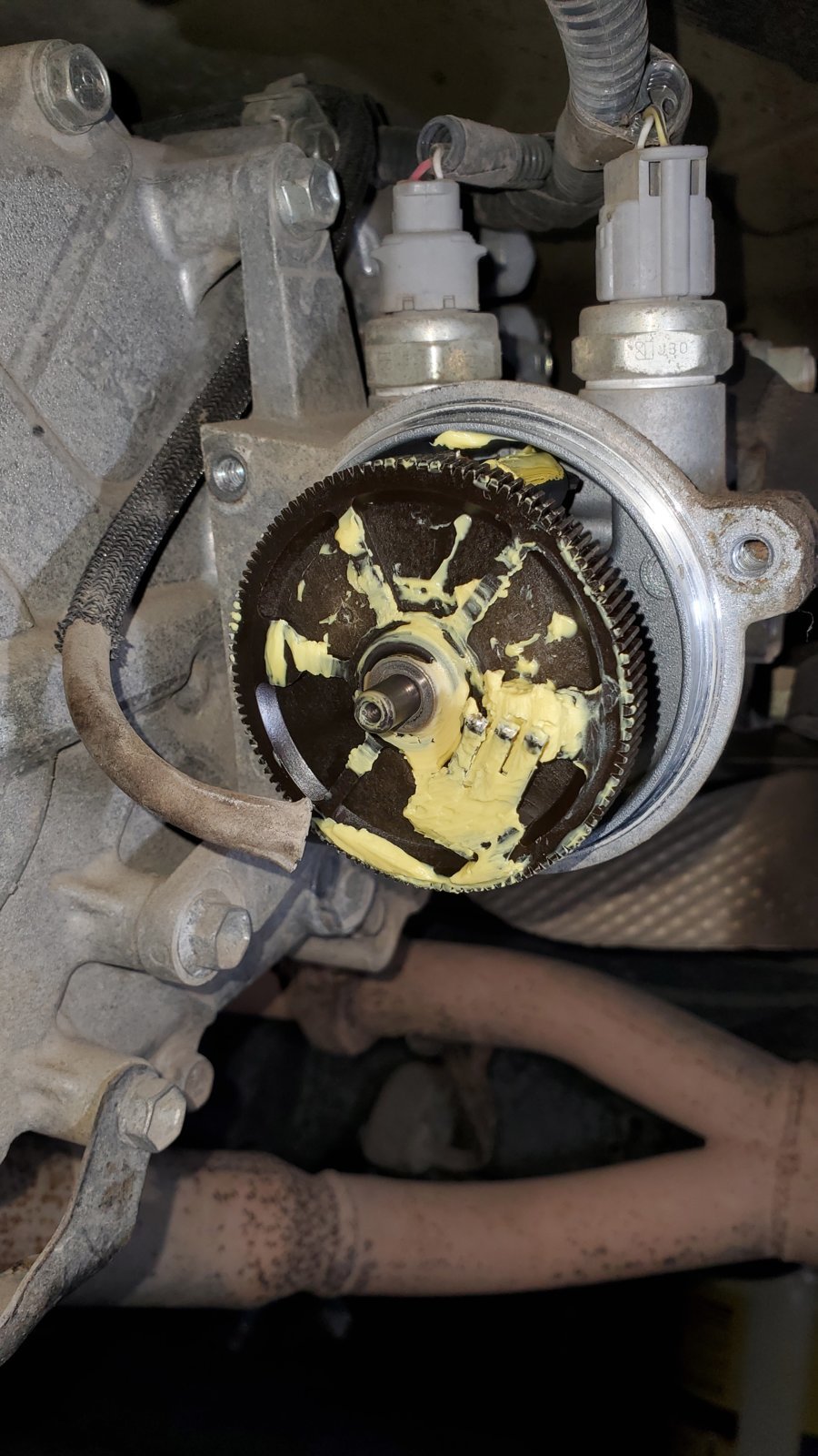

    Sadly my fix was short lived. I took the cover off again to put on the gasket when I attempted to put the gear back in I couldn't seem to line it up properly. Anyways, it's 2wd, but I cannot engage 4wd! I'll post my voltage readouts tomorrow morning. I spent damn near 3 hours trying to match it up properly. Time for a beer!

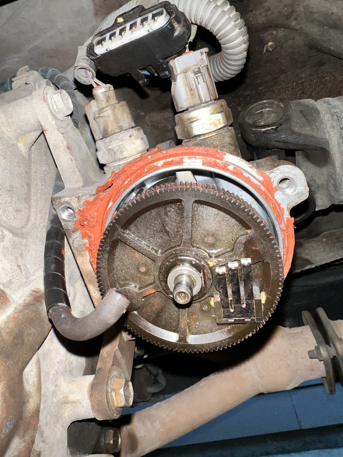

    I have a picture of where it needs to be in 2wd, leme see if I can find it.

    This is where it should be in 2wd (gear turned fully counterclockwise).

    Thanks, I'll check it this morn. What's the yellow paste all over the gear, lithium grease?

    2006 Tacoma Off Road
    is this correct??

    Whatever grease Toyota uses.
    The angle is a bit different but it looks like it may need to be a tooth or 2 more clockwise. Also make sure the contacts are good, they look like they may be bent back a bit in the picture.
