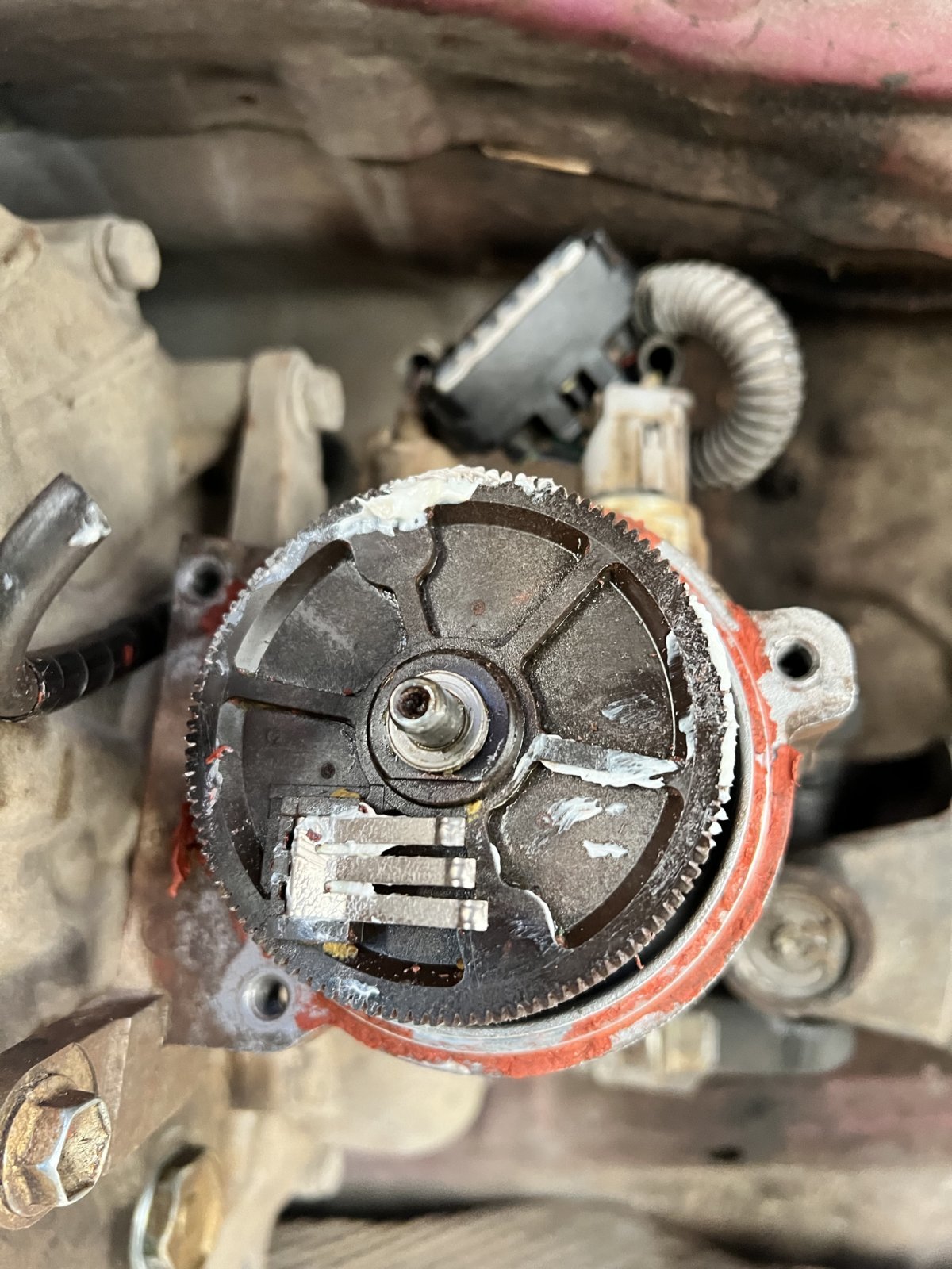

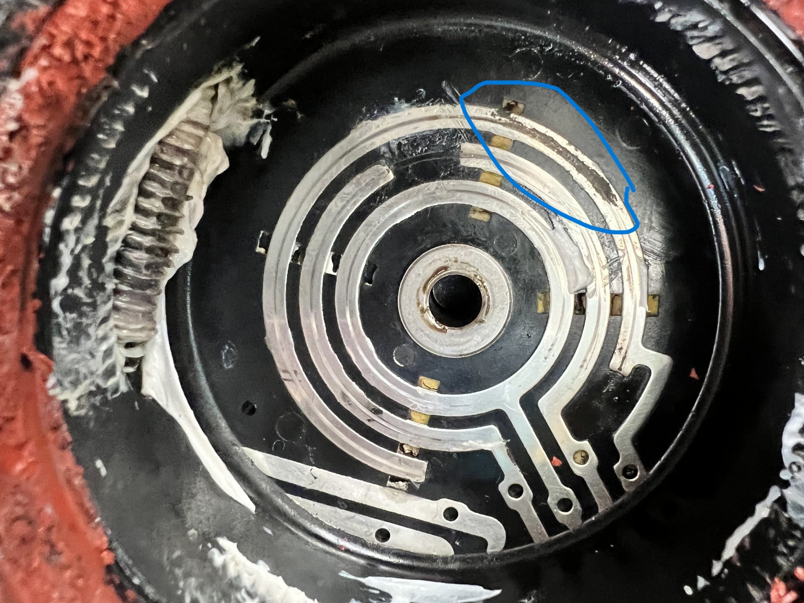

    I'd be this is your issue, will that clean up?

    I'll have to see if it'll polish out. Almost looks like it's been scraped.

    Looks like rust.

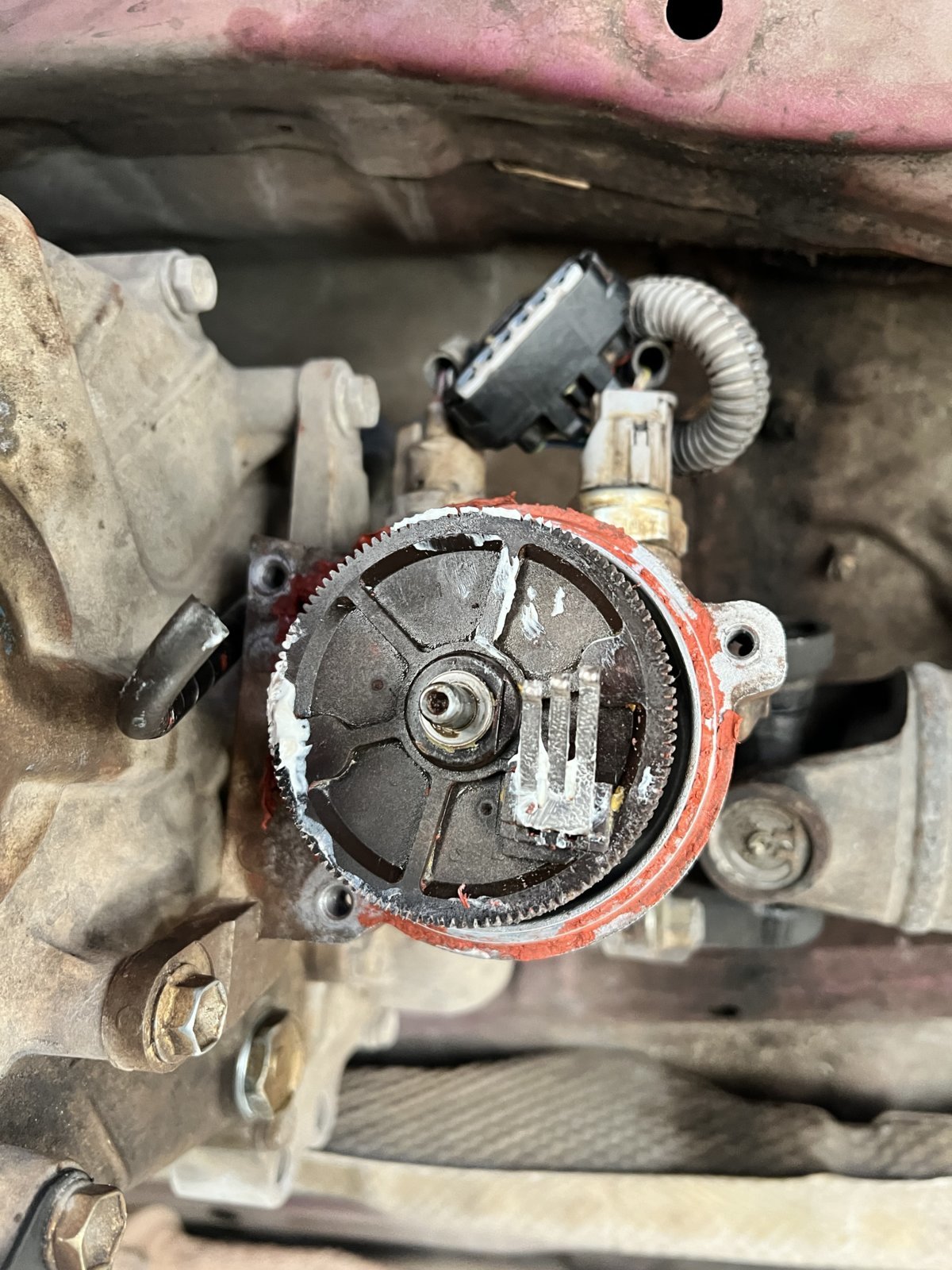

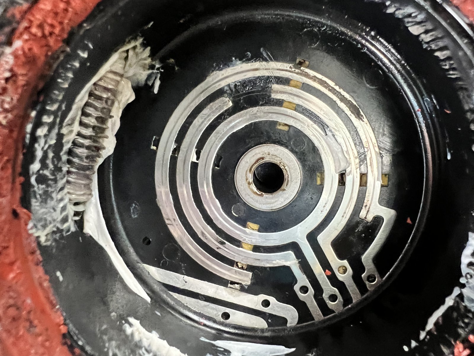

    I think you posted this pic in another thread
    That thing looks worse than mine!

    Yea the original image came from this thread, he replaced the actuator.
    Stuck in H4 | Tacoma World

    That makes sense why our TL1 and TL2 voltages were right, it was losing connection at that point on the contact plate so the 4wd ECU was stopping the actuator there because it thought it was in the 2wd position.

    Dm93, you magnificent bastard! I think that did it!!! Ima drive it for a bit and if this fixes it I'll redo the gasket.

    I should have asked you for a picture of the contact plate sooner but I wasn't thinking.
    Anyway glad it's working.
    That would only apply to shifting in and out of 4L which seems to work fine.
    It looks like we found the issue though, rust on the contact plate.[/QUOTE]
