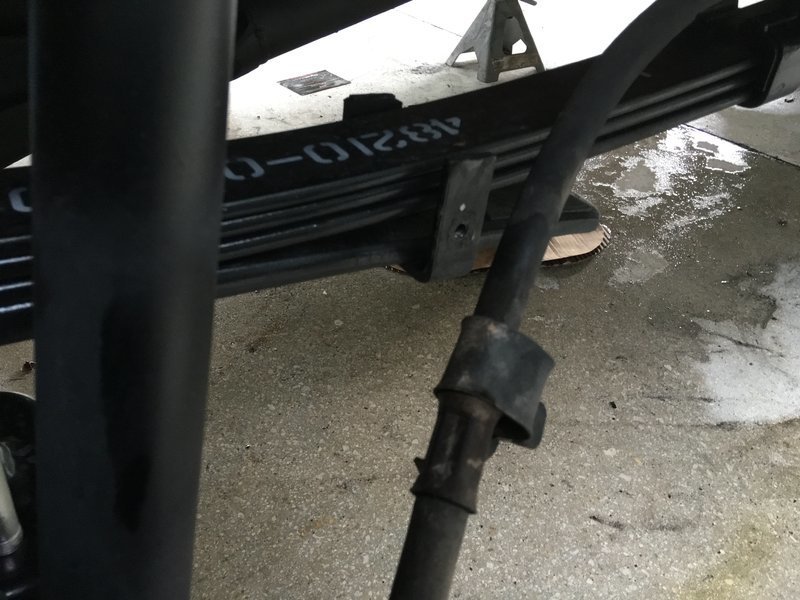

    I just had my OE leaf springs replaced yesterday due to the recall. All is good with the dealership recall and installation, but I also just received my AALs in the mail and I'm wondering a few things:
    1) It seems like the new leafies have extra shackles/retainers about 12" from the center pin. I am virtually certain the AAL is gunna overlap those. Is there any problem with trimming those off and just leaving the outside shackles/retainers? Or should I plan on replacing the inner ones? (do they even make such an animal - aftermarket retainers?)

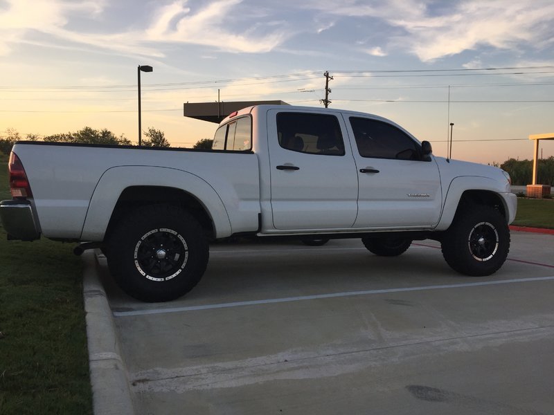

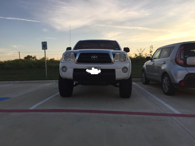

    Here's a quick pic. Not real accurate sitting on a slope. The rear seems to be sagging a little bit since I had the recall work done. I'm thinking I'm going to have to add a 1 inch block in the rear to level it back out .IMG_5005.jpgIMG_5006.jpg IMG_5007.jpg

    It's hard to know what mine will look like on stock alloy rims. I assume your aftermarket rims have some built in backspacing (or whatever the right term is) that pushes them outboard a little bit. Your 285's are right at the maximum distance I'd want to push out my tires/rims. I might be happy with 265's in your situation - just to give you my perspective on the look I'm going for. Thanks for the response!
    I don't really see the back-end sag you speak of in these pics, but I in real life it might be more obvious. I haven't put on my lift yet. I have a 3" planned up front and a 2-3" lift planned in the back. We'll see what that ends up being after the install and if I end up with some butt droop. LOL Now to save up some pennies for my BFG KO2's!

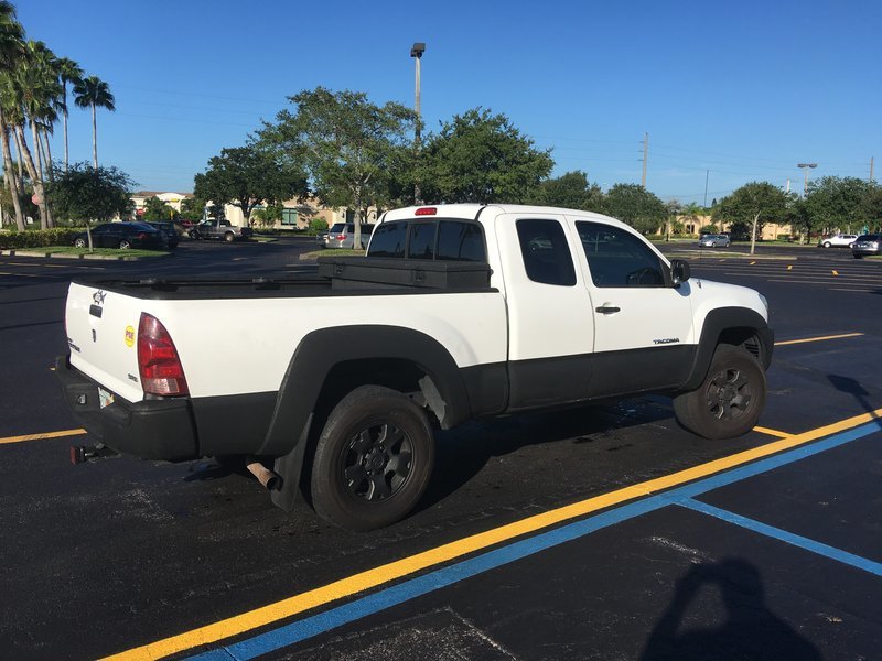

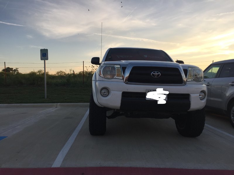

    My "before" picture. I don't have the "after" yet since I've not installed the lift and tires. Will do that in a few months.

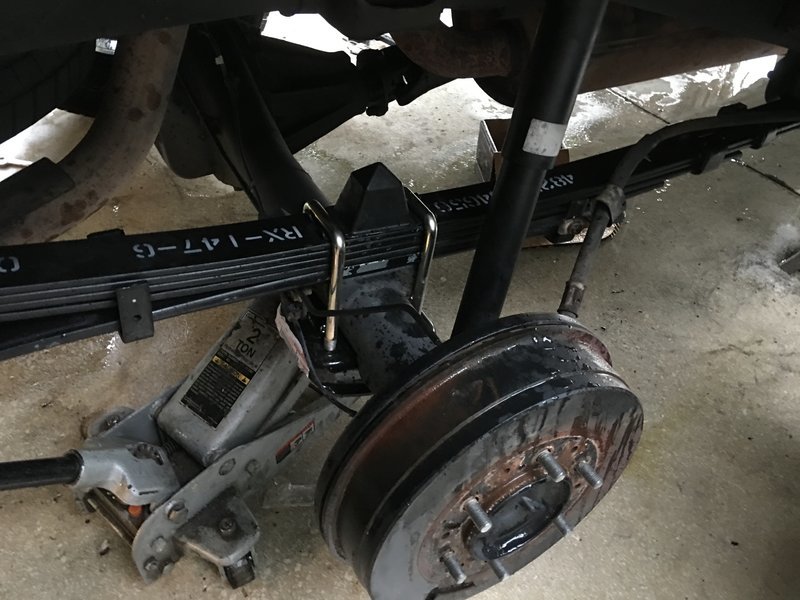

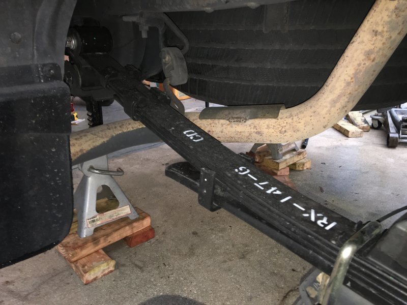

    Well, got them installed with very little cussing. Here are some pics of the stock (recall) leaf springs prior to install:

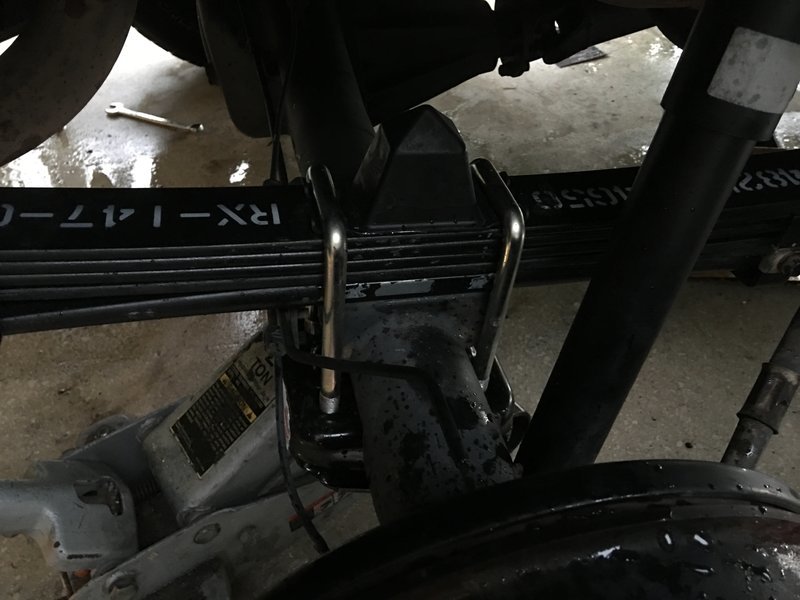

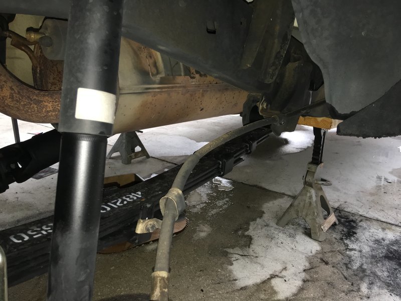

    Here's a shot after I disconnected the e-brake retainer.

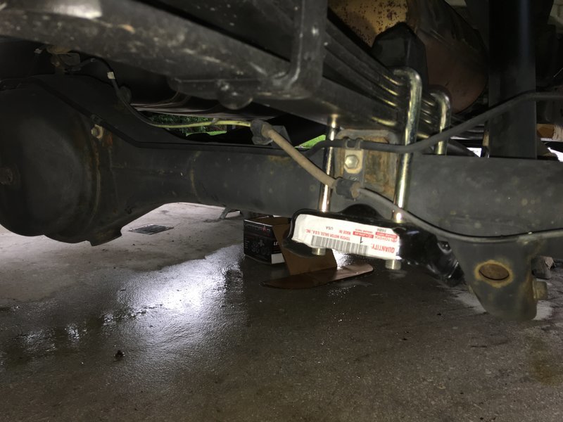

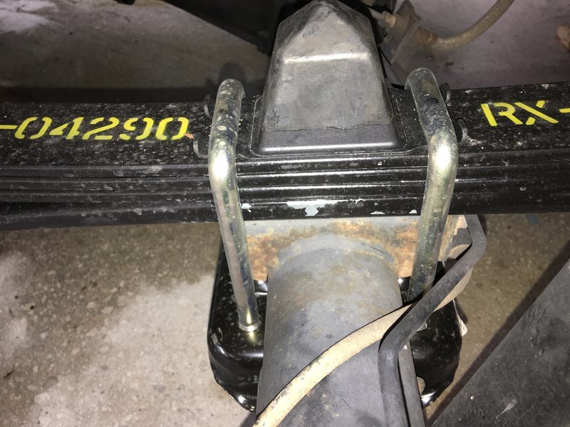

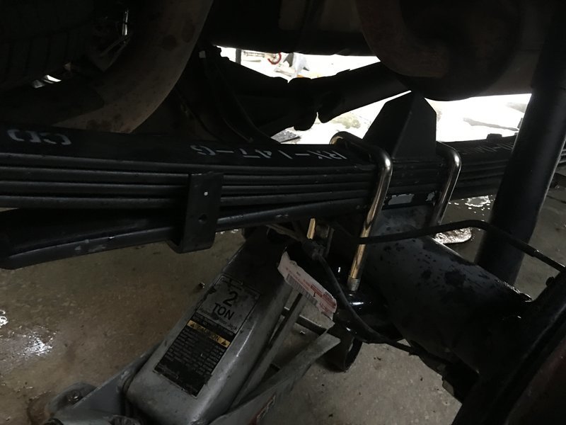

    Here's a shot of the leaf pack prior to the AAL - uncompressed. Watch that those shims don't slide out of place or you'll be fighting to get the center bolt in.

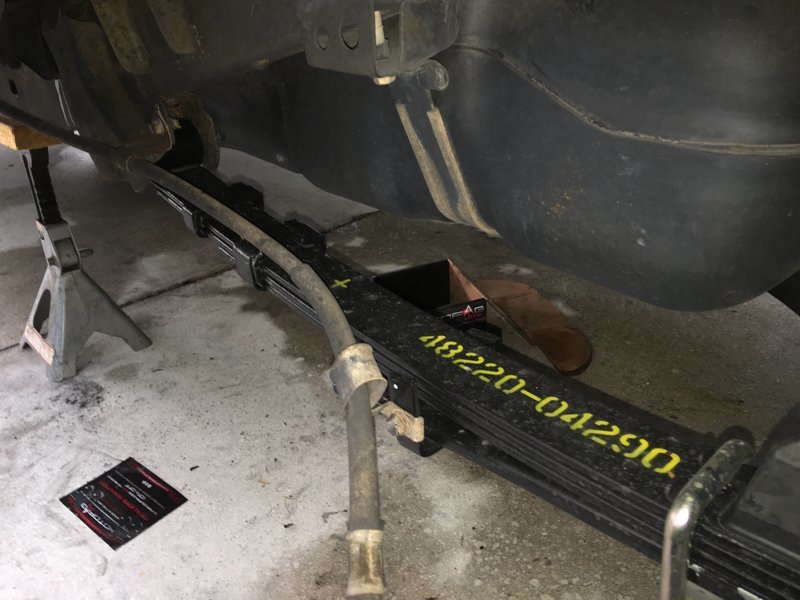

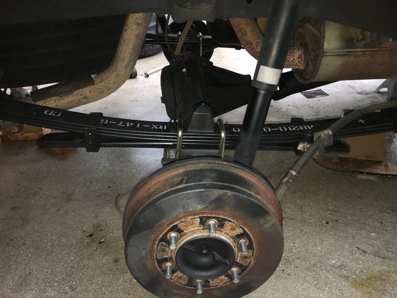

    And here are a few shots of it done.
