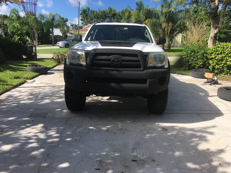

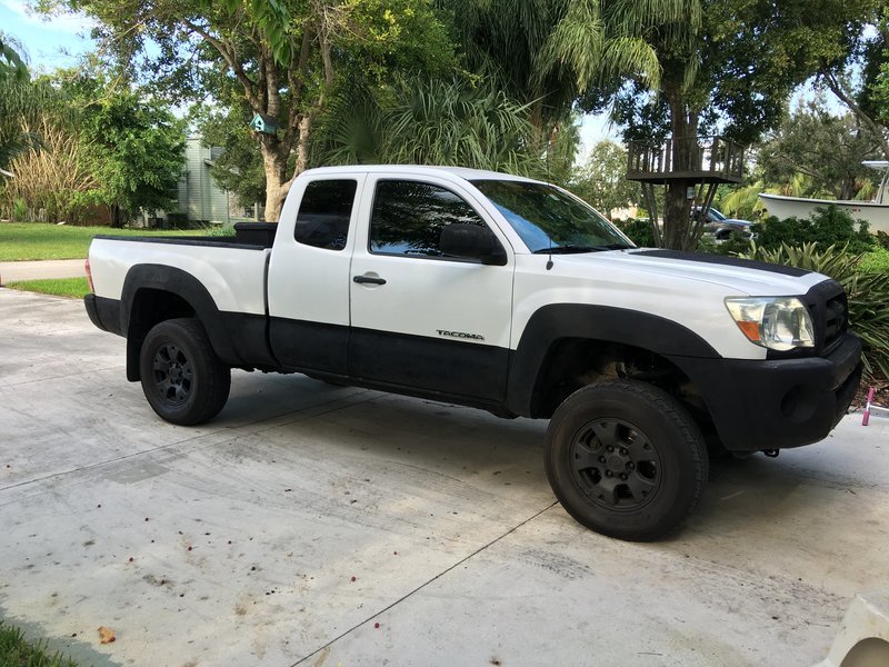

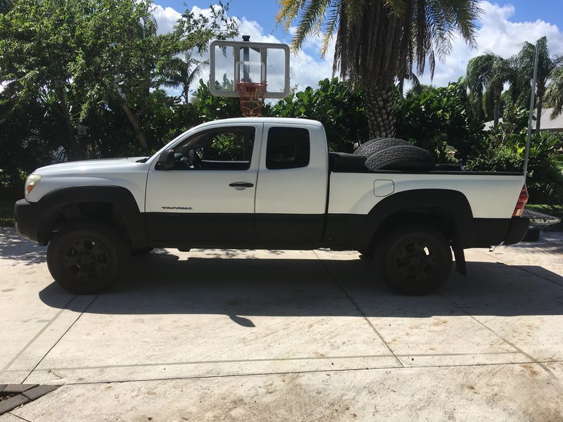

    The "before" pic in the parking lot. The "after" in the driveway. Was starting to get dark-ish so the lighting sucked. Guess it helps hide the "training-wheels" look my stock alloys and stock tires give! Ha! I got about 2.5-2.75" lift outta the spacers and the AAL. Not bad. Now to save a few more pennies so I can stuff some meat in those wheel wells!

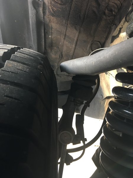

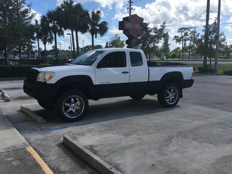

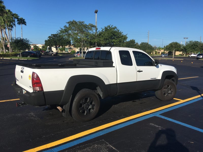

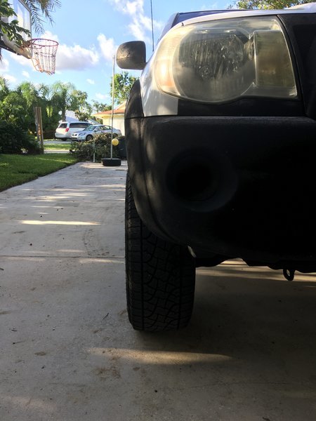

    Well a buddy had some 20's (275/55/20) from a project that just happened to fit my bolt pattern. I threw those on for a test fit and to my surprise they fit like a glove. Here are some before/after pics. One of my stock UCA clearance. The only place I think I might be rubbing is the skid plate on my passenger side. Maybe I bent it out because I was lazy and didn't want to remove it when I did my sway bar relocate spacers...or maybe not. LOL I feel like my truck is settling after the rear AALs which seems to be more noticeable now after the wheel/tire change. Not sure why it seem more noticeable, but it does. I guess a 1-1.5" block will do me up if I get too annoyed.
    BEFORE:
    AFTER:
    BEFORE:
    AFTER:
    I've got about 3/4" or so of space. Won't be able to put bigger tires unless I do the UCA upgrade.
    Nice profile after the new tires/rims. I like the "flush" look.
