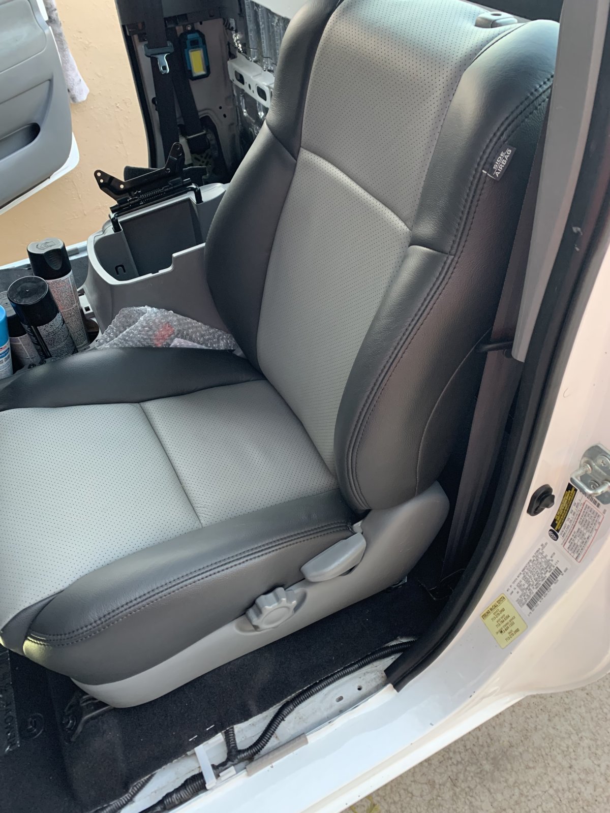

    I also purchased a “Mostly Cosmetically Neglected” 05 reg. cab 5 lug w/ a stick sight unseen. Lucky the old owner changed the oil (Thank Toyota for Maintenance lights) and did radiator flushes because of the plastic hose underneath the intake manifold! I’ve purchased new Enkei’s & Toyo rubber, everything new but a used radiator from our 07 w/ 36k miles and the heater core. Anything that has antifreeze flowing through it is being replaced. New Viking C/O Front & adjustable rear shocks, front StopTech’s (worth every cent), ball joints, PS bellows & hoses added a small cooler & inline magnetic trans filter, Gates belt, 3.58 gear w/ TrueTrec (from 07) LCE header w/ 304 exhaust system, 02 sensors, & high flow cat, will install a new clutch & U-joints soon, Yada Yada Yada..
    New OE painted grill & door handles, head & taillights, having it repainted, tore out the old carpet & bench seat to install OE 12+ carpet and katzkin sport buckets (cheaper than OE cloth covers) re-webbed the seatbelts & new buckle’s w/ latches, installed cruise, intermittent wipers, leather wheel, small stereo & alarm, Yada Yada Yada…
    Yeah I may have more in it than it’s worth but I know it will last me until I can’t push in a clutch any longer, plus it’s a HELL of a lot cheaper than buying a new Taco! OP if you’re looking for any of my old parts like carpet let me know you can have them for shipping. Oh, and if you are going with larger rubber I highly suggest a different rear gear. 3.58 or 3.73 can be found for cheap. As long as the 8.4 3rd member hasn’t had water in it they should last a lifetime. Here’s the drivers seat installed…

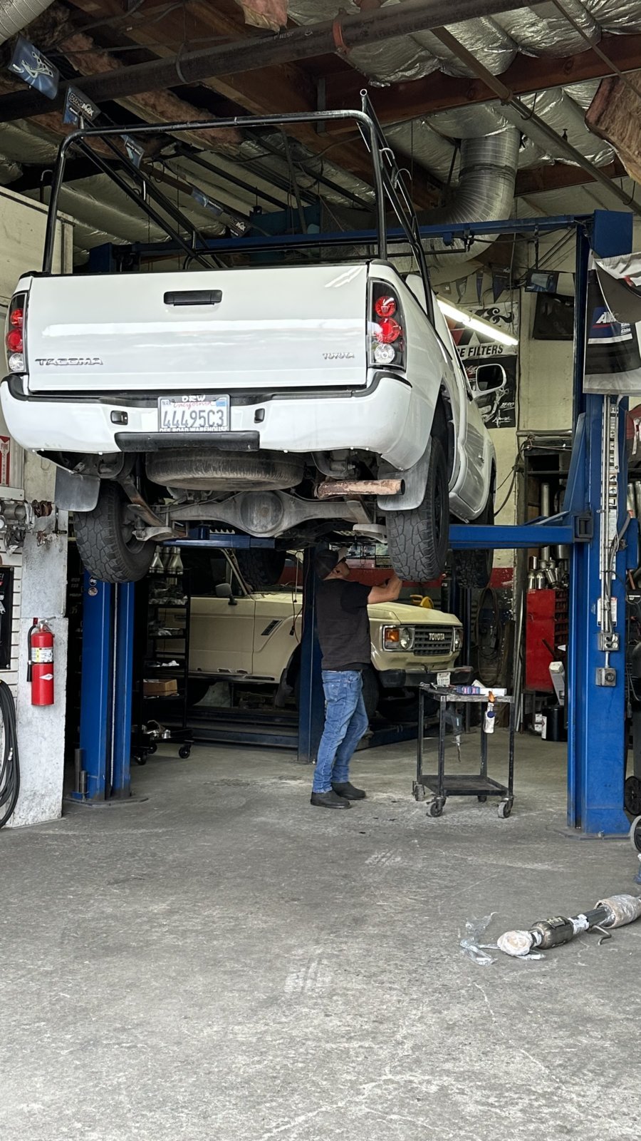

    Getting a Cat Replacement done now.
    waiting for other parts I will install myself and then the lift kit/bigger wheels and tires/shocks and some exterior love like headlights and taillights

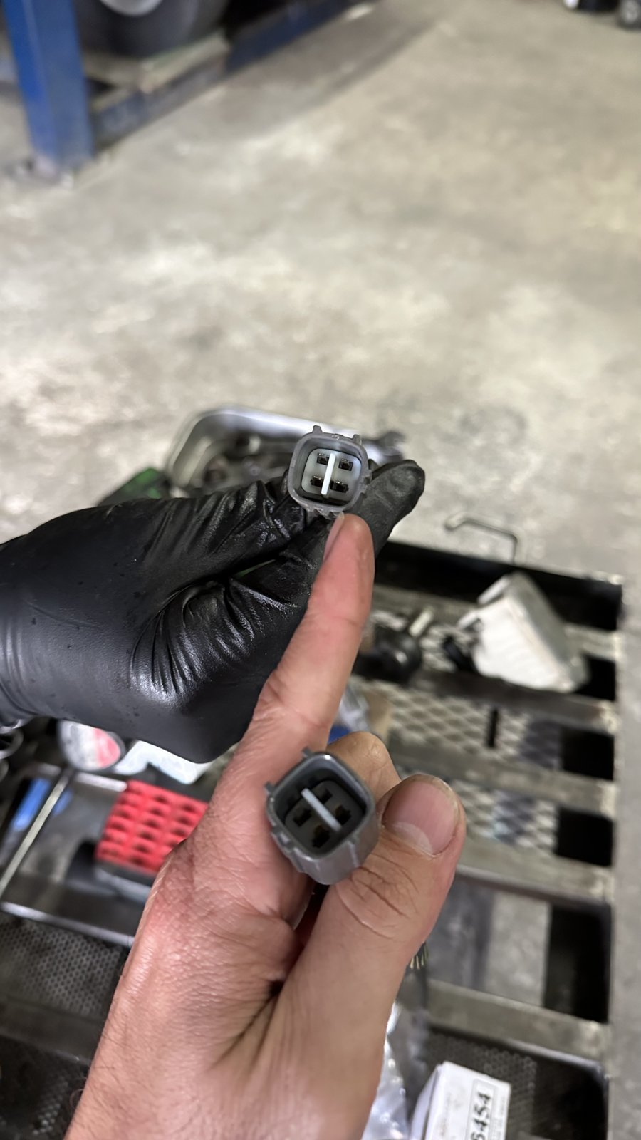

    Got the wrong 02 sensor, got a new one right away from Oreillys delivered to the site and got the new cat on there.

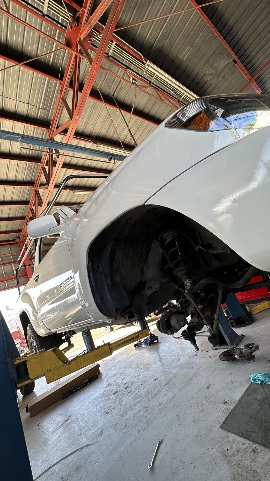

    Getting worked on

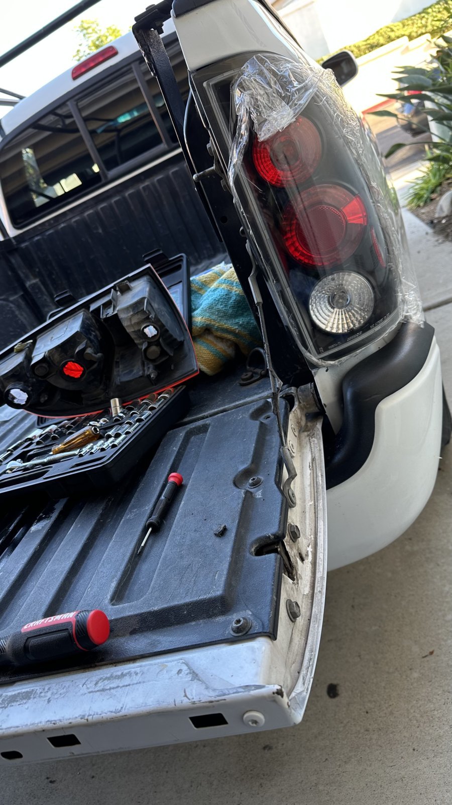

    Doing the taillights/headlights/hood struts myselfIMG_5160.jpgIMG_5453.jpg
