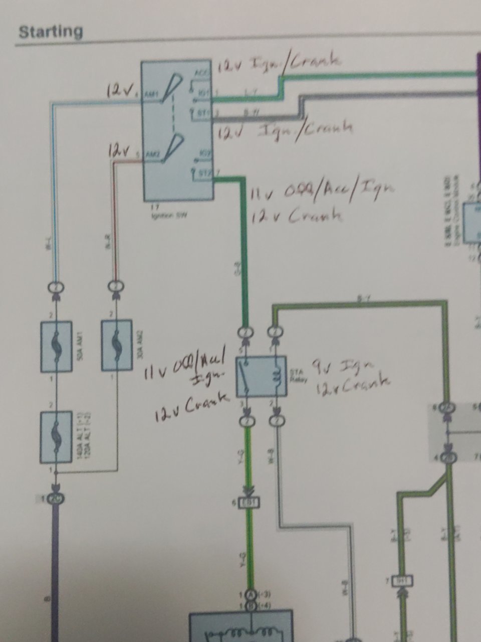

    Peeled the dash open and started unwrapping the loom. There is some discrepancy with the instructions Crimestopper sent. Changes in color scheme... Lacking instructions for 4 pole relay... It was 5+ years since I installed it. The solder joint on the #3 B/W wire looks good.
    I decided to check voltages that energize the starter relay again. 7v ignition ON... 10v START. Shouldn't be any voltage ignition only. Just Start. If Yes? I believe the ignition switch may be the problem. Is it supposed to wiggle?

    Pin 3 of the ignition switch should only have battery voltage with the key in the crank position, it shouldn't have any voltage in the run position. If it has voltage in the run position either the switch is bad or something is backfeeding the circuit.

    I'm no expert, but if the switch is off certain posts should not be showing voltage.
    This still doesn't explain where the 9v is coming from on pin 1 to energize the starter relay. I should probably find that first.
    The accompanying pic shows voltages at pins. (same results with & without remote connected)

    Something is backfeeding the circuits, you say it's the same with the remote start disconnected.
    The next suspect area would be one of the junction blocks, has the truck ever had water get inside the interior that you know of?

    I still suspect something with the remote start since it appears you have a backfeed on both legs of the starter relay but you say you have eliminated it.
    You could unplug connector PB behind the glovebox and see if the backfeed goes away before messing with the engine room box.

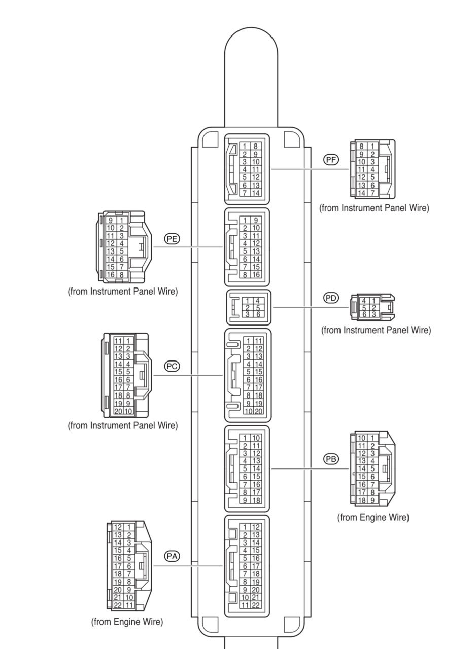

    When I took the glove box out I decided to call it a day. Which one of the dozen plugs is the PB plug?

    It's the 2nd one down on the white junction box left of the PCM, I have a picture with them labeled on my PC I'll post it when I get in the house.
