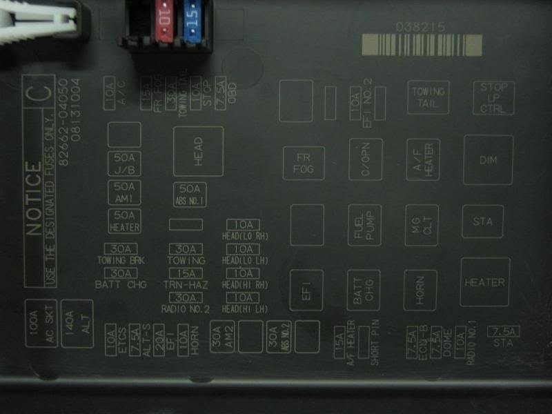

    Could be the compressor going out. Another issue that has happened in the past is people having the relay fail. You can try swapping the relay to see if that fixes it. If not, the compressor/clutch is failing/failed. Try swapping the "TOWING TAIL" and the "MG CLT" relays in the engine bay panel.

    I will be trying to swap relays first. Ill post the results in a few days, got lots of things going on right now, thanks again
