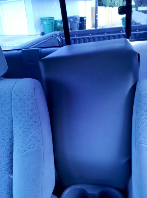

    The build:
    I had a sub laying around (pretty cheap from high school, but it works) and thats what i designed my box around, i needed at least 1.25 cb/ft of air. The sub is a Infinity Reference 1252w This is actually hard to accomplish with the little space in the truck. For the box, i wanted a down firing sub, so it would not be visible from outside the truck. To make the box i decided to use 3/4" MDF.
    i managed to "upholster" it myself, using 1/2" foam underneath, then wrapping the box with a vinyl material i found at a fabric store by my house. I know it does not look the best but it works for now.. And installed into the truck for a test fit, adding the 1/2" foam made the box grow taller than i expected so as you can see in the picture its 1/2" above the rear wall of the truck.

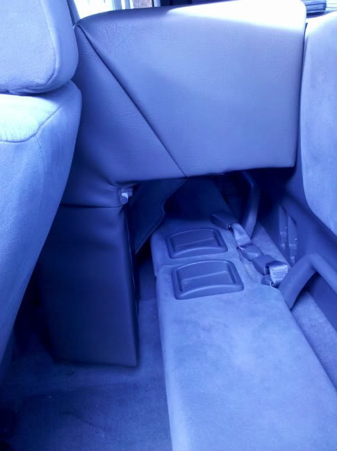

    I also mentioned i wanted to be able to access the storage below the rear seats, and i can open the seat and access the storage :)

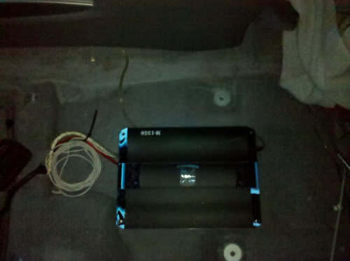

    So following that i needed to mount my amp, and install my headunit, after searing for a place for the amp i found that under the seat would be my best option, here is a pic of that while the install was still in progress ( i was running out of daylight and it was about 39 degrees outside).

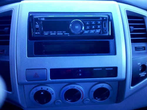

    My headunit with dash kit from Crutchfield, is actually a nice kit, one complaint is that during shipping, the plastic tab that holds the head-unit in place broke off on the right side, on both of the dash kits i received, but it doesnt affect the install really, it is held in place by the cover plate that looks EXACTLY like the stock head unit surrounding. This kit has built in bluetooth, which is the selling feature for me, but this had me thinking where do i put the mic? I actually found the perfect place for it, since i do not have an automatic garage door opener, i used a stock hole in the compartment and mounted it there. Even with with the compartment closed the mic works well.

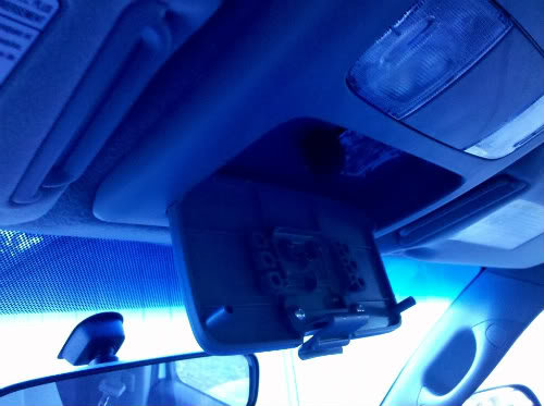

    some better pictures added, not from a cell phone camera...and i snuck in two new ones, one of the boost control knob, and one of the slick placement of my +12V wire, and my ground, i thought it was pretty slick, especially since i had only 2.5' total length to ground my amp, i just thought it was easily used, i know its easy for thieves to spot but it will have to do till i get more cable.
