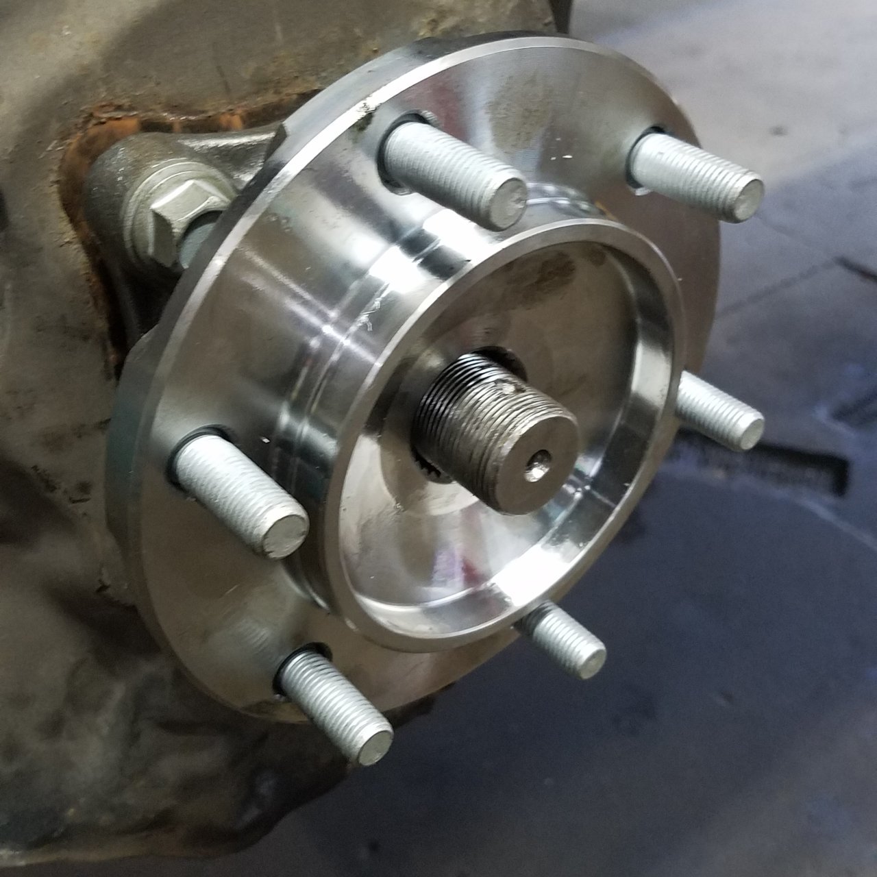

    New wheel bearing on the driverside was much needed.

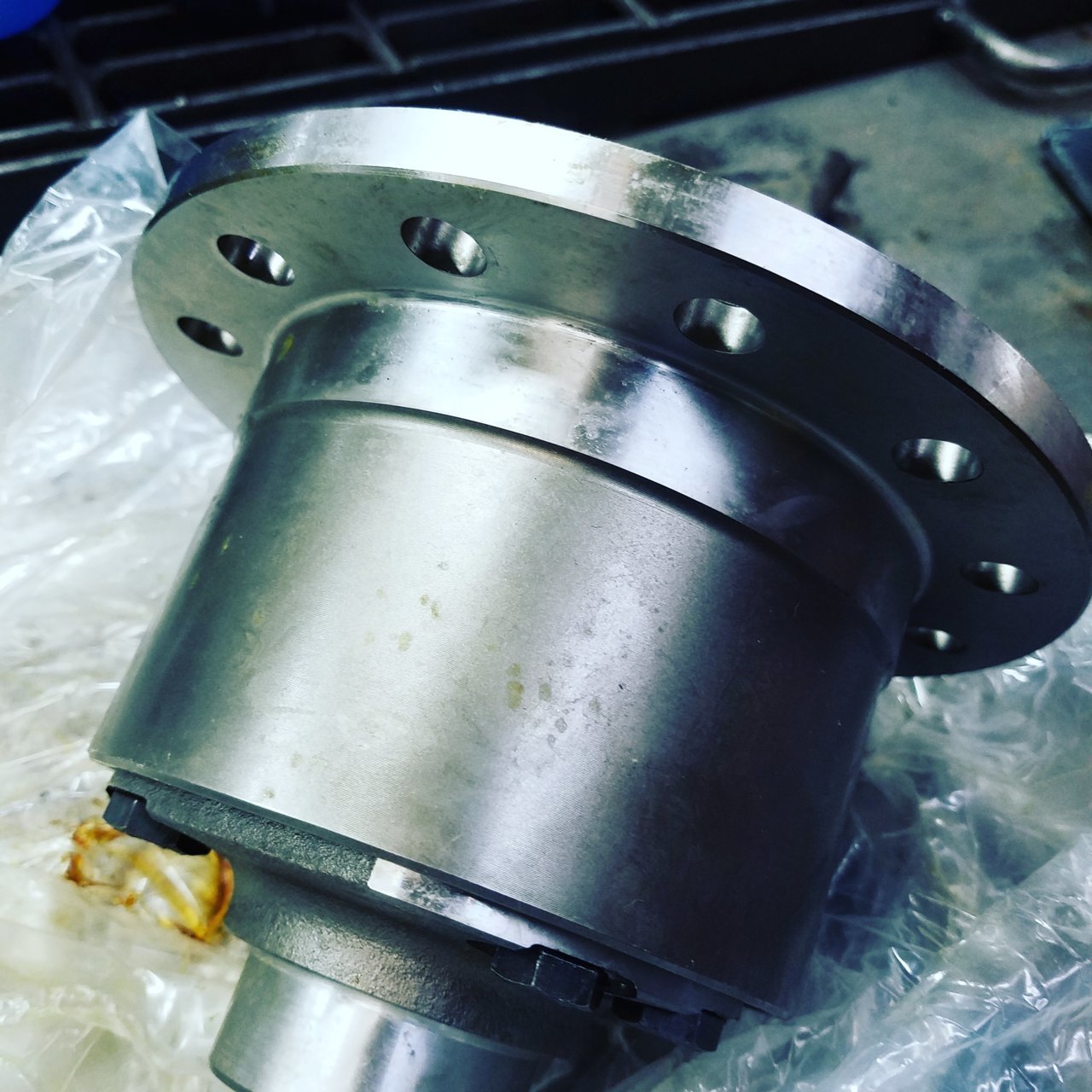

    Detriot TruTrac installing with Yukon 4.88 gears coming soon. Just ordered up my ECSG bushing as well.

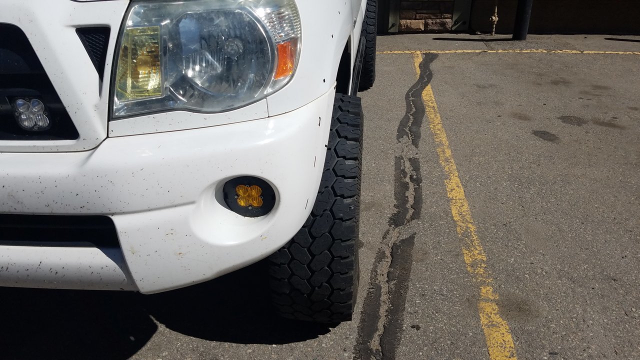

    Playing around with some 37" 13.50s at work this winter.. bahaha
    noted: This was before I took the flares off. Anybody cut higher than the holes?

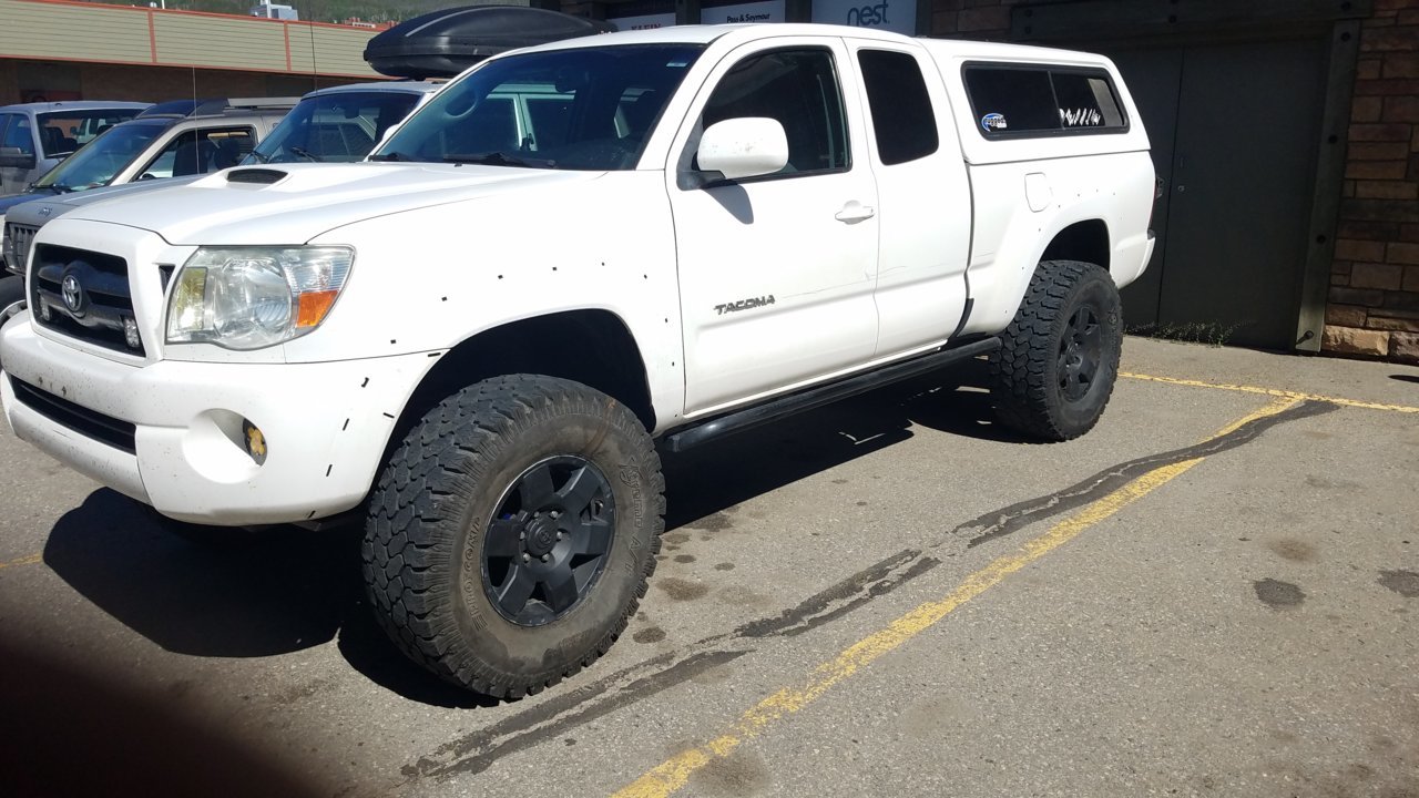

    Finally found a deal on some FJ Cruiser 17" wheels. We have tons of take off tires from our deep pocket customers so I grabbed a set of 35x12.50

    I'm going to swap them out for a set of TOYO MT if possible, I will be purchasing some KO2 tires in this size if I'm going to keep driving it winter/summer.

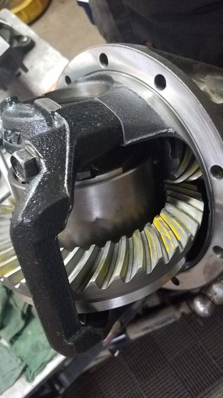

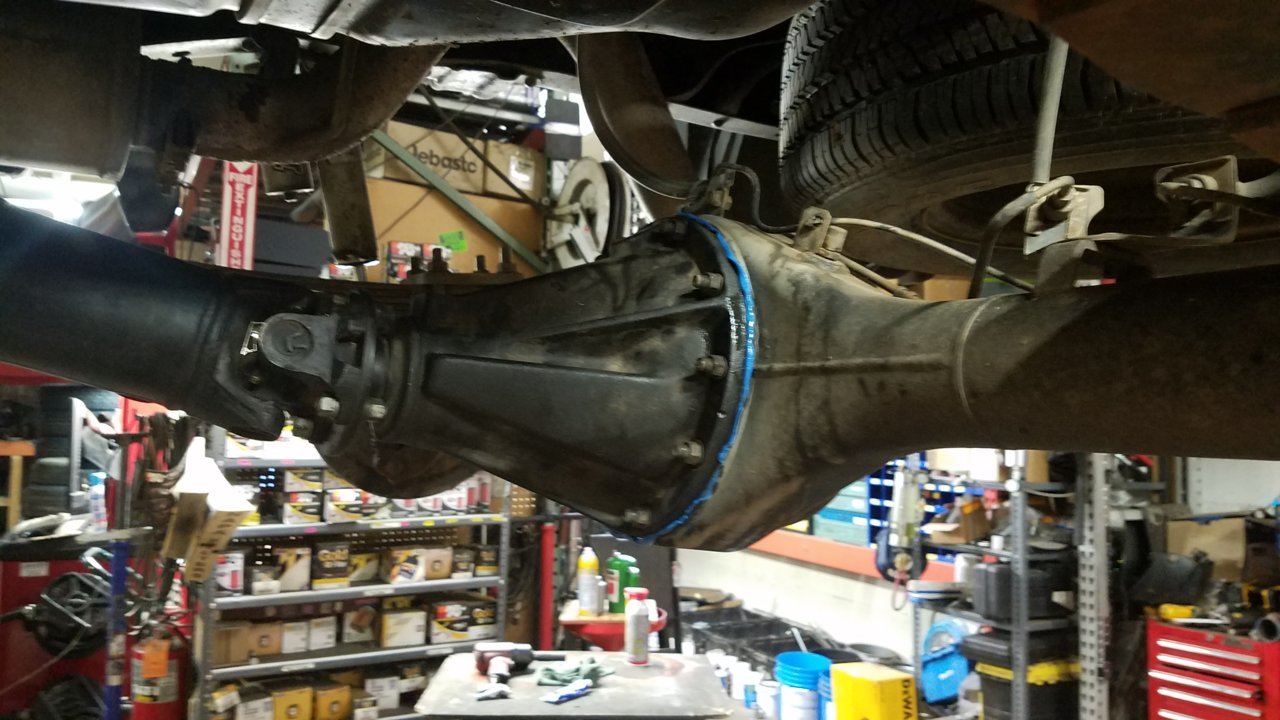

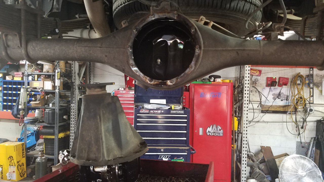

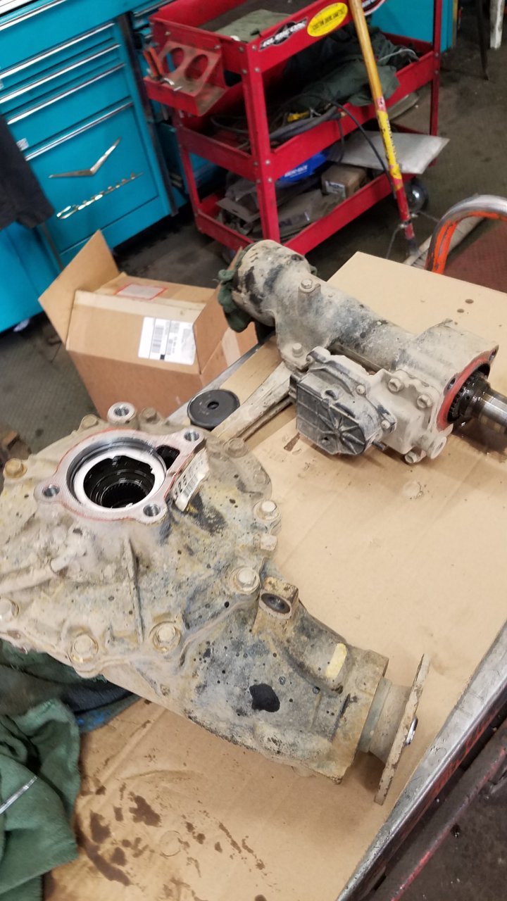

    Finally got started on my YUKON 4.88 gears and rear TruTrac locker! Yeeehawwww
  9. Jul 19, 2019 at 8:25 PM
    #29
    ToyotaRoamer86
    ToyotaRoamer86 [OP] Well-Known Member
    Jun 20, 2017
    #221993
    520
    Brandon
    Frisco, CO
    2007 Tacoma TRD Sport

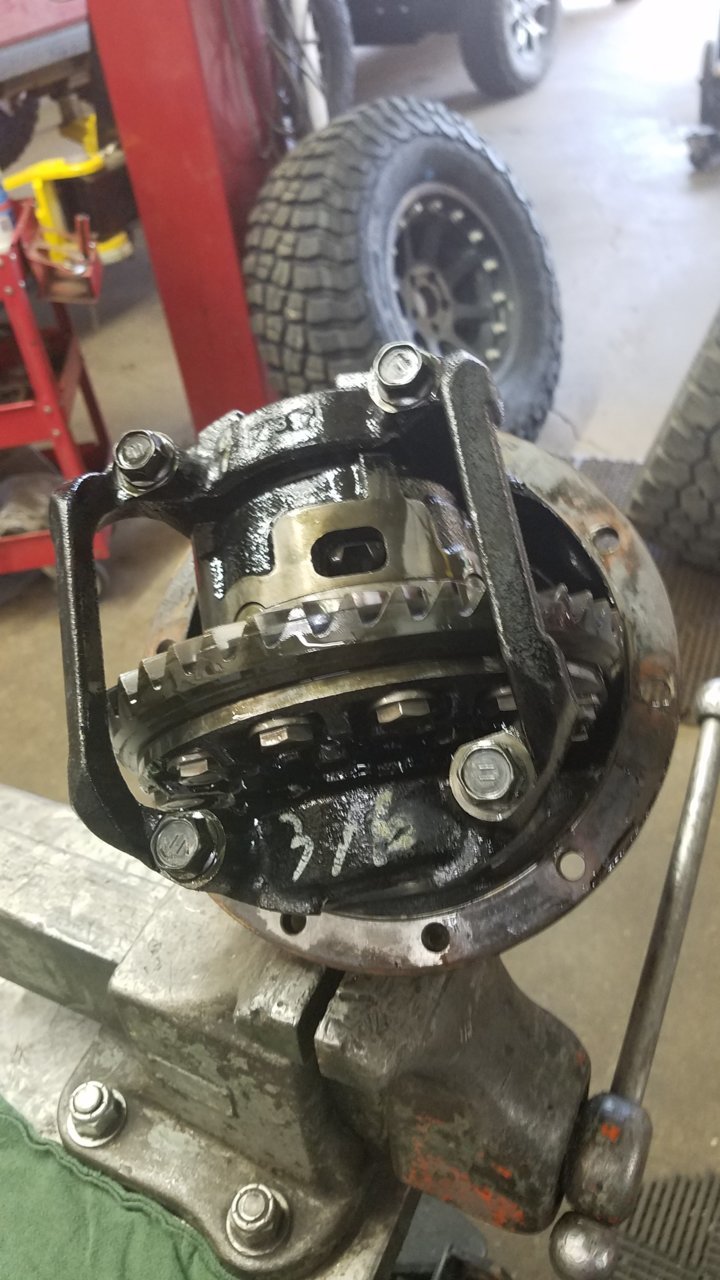

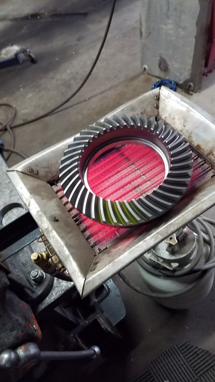

    Started at around 7pm after we finally got the shop all closed up. Quick disassembly with a weird, "Where are all my set up shims?" moment. Ended up with a great pattern and now shims other than 2 for the pinion on the crush sleeve. Pretty amazing to the fact we ran patterns twice and it was perfect!

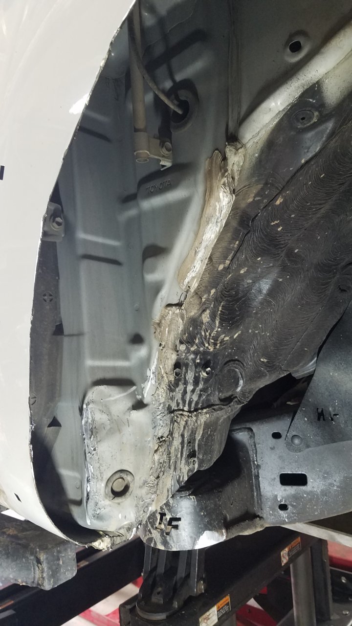

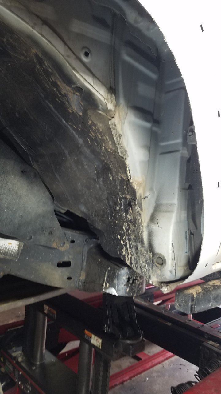

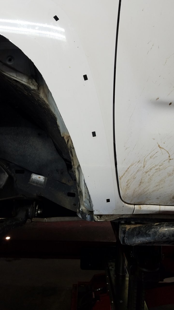

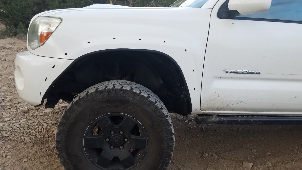

    Finally got around to trimming the front fenders today before this weekends adventure into HOLY CROSS here in Colorado. First time to do it in my Tacoma. Pretty excited for sure!
  15. Jul 27, 2019 at 8:50 PM
    #35
    ToyotaRoamer86
    Jun 20, 2017
    #221993
    520
    Brandon
    Frisco, CO
    I will be posting more of the cutting/trimming as I can get them uploaded. They was about a 5 hour process or forking, marking, cutting, pounding, reforking, recutting and more pounding!

    I did spray the now UNLINED inner fenders with Bed Coating spray paint to help with the ugly factor and keep a clean look. So close to getting the factory flare back on after I trim the rear a little bit. They almost didn't need it other than possibly GRABBING the bolt heads from the current inner liners on the rear.

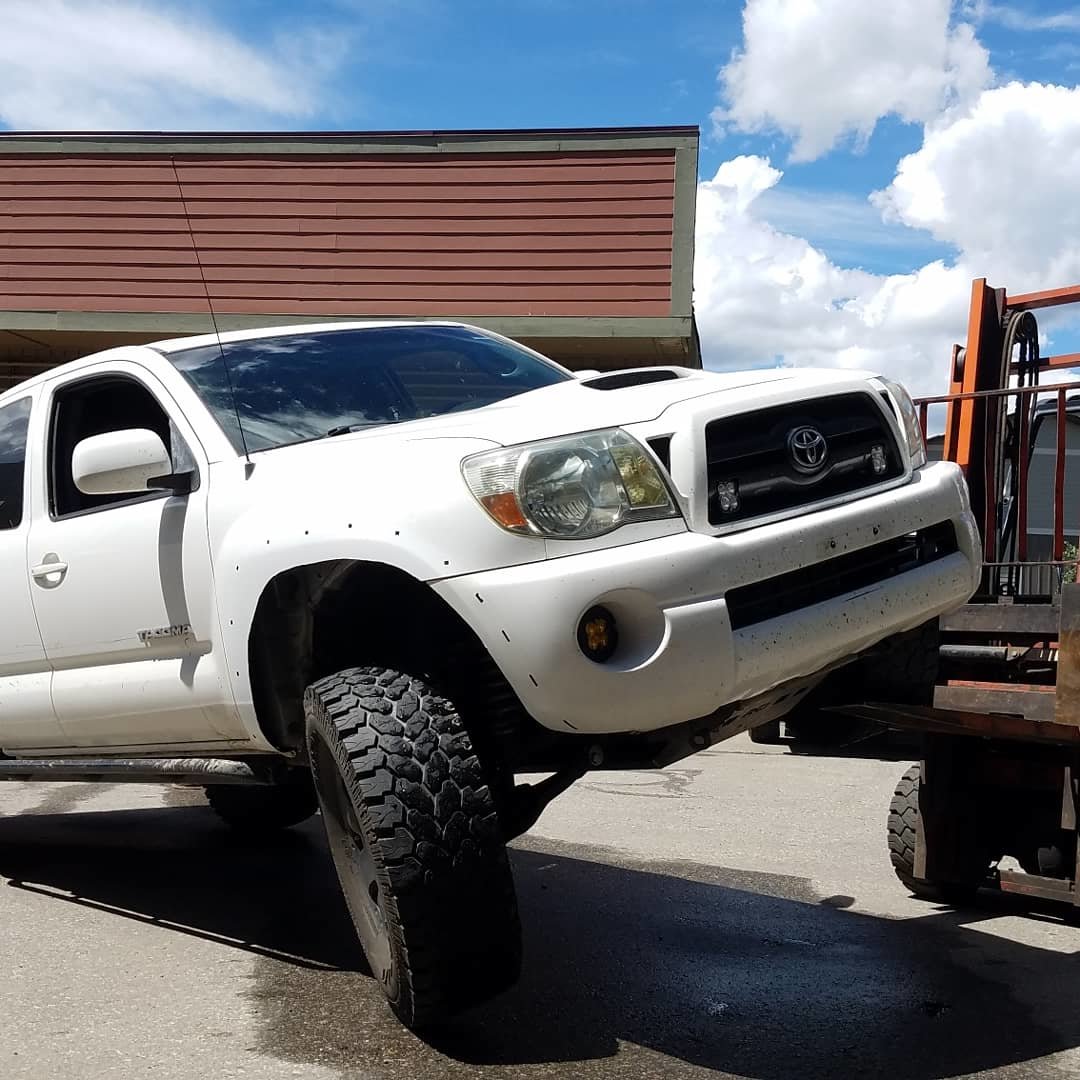

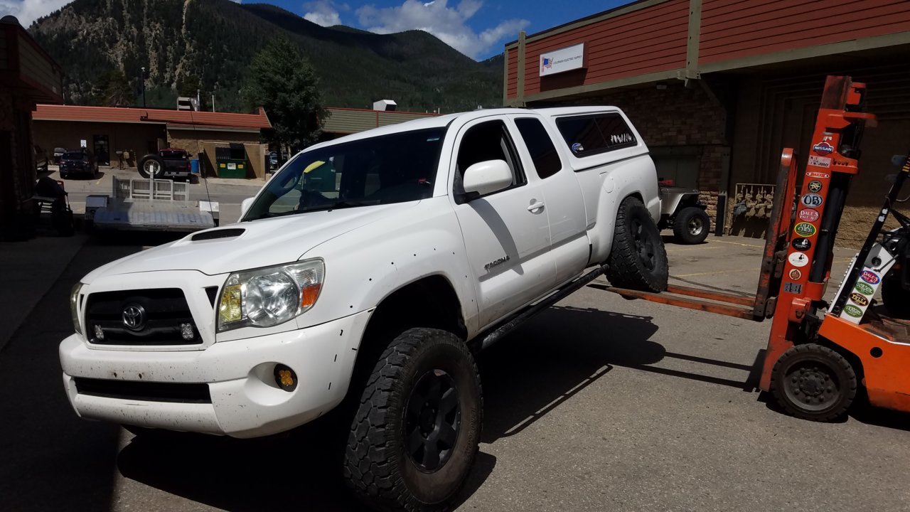

    It was very nice to be able to use the forklift and mark all the places it was rubbing. Of course this is no measure for the real world testing it was about to receive.

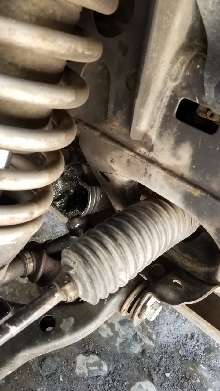

    Well damn, my passenger side axle seal is leaking. I'm pretty sure it has been since we did the re-gear
