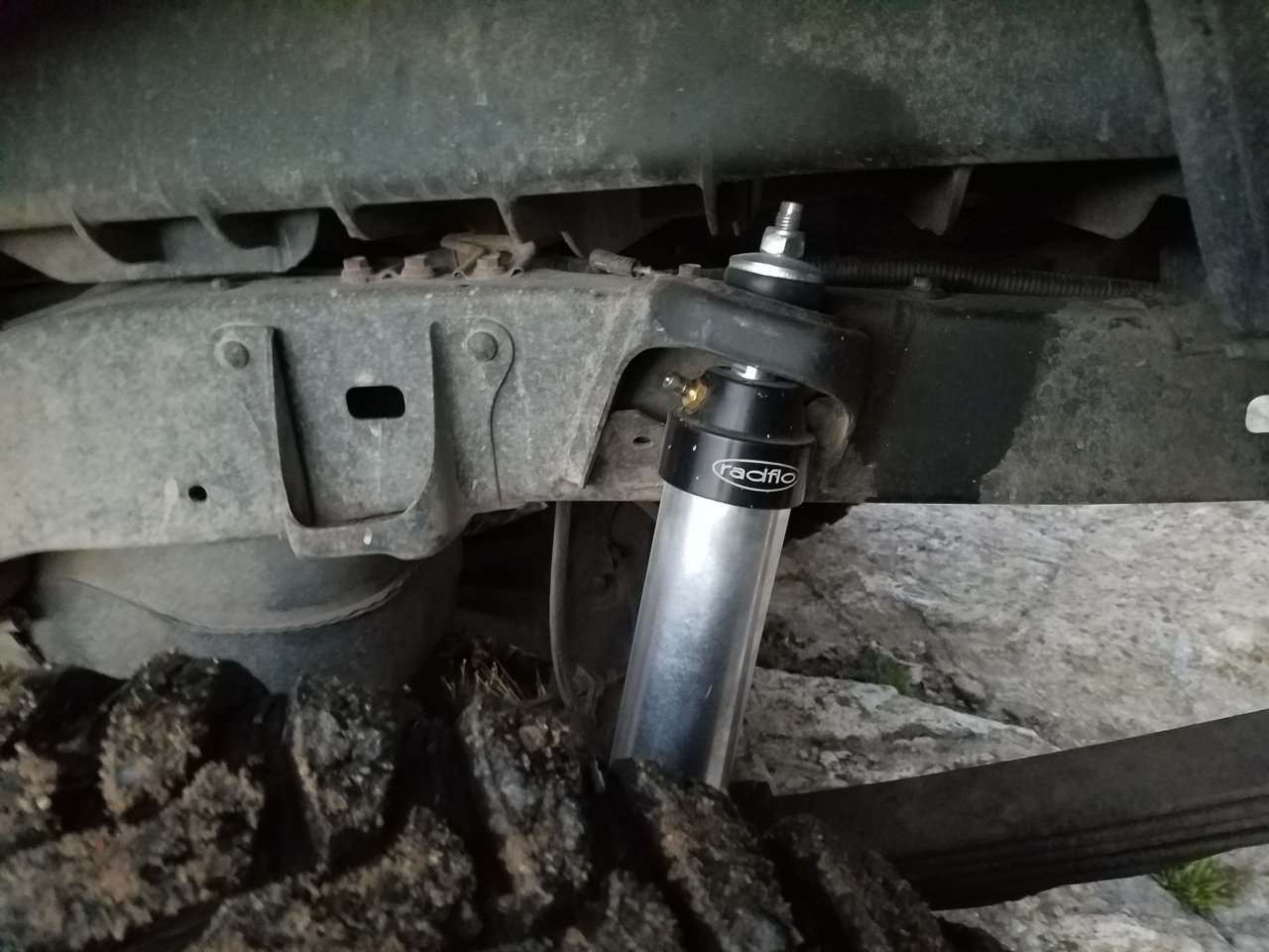

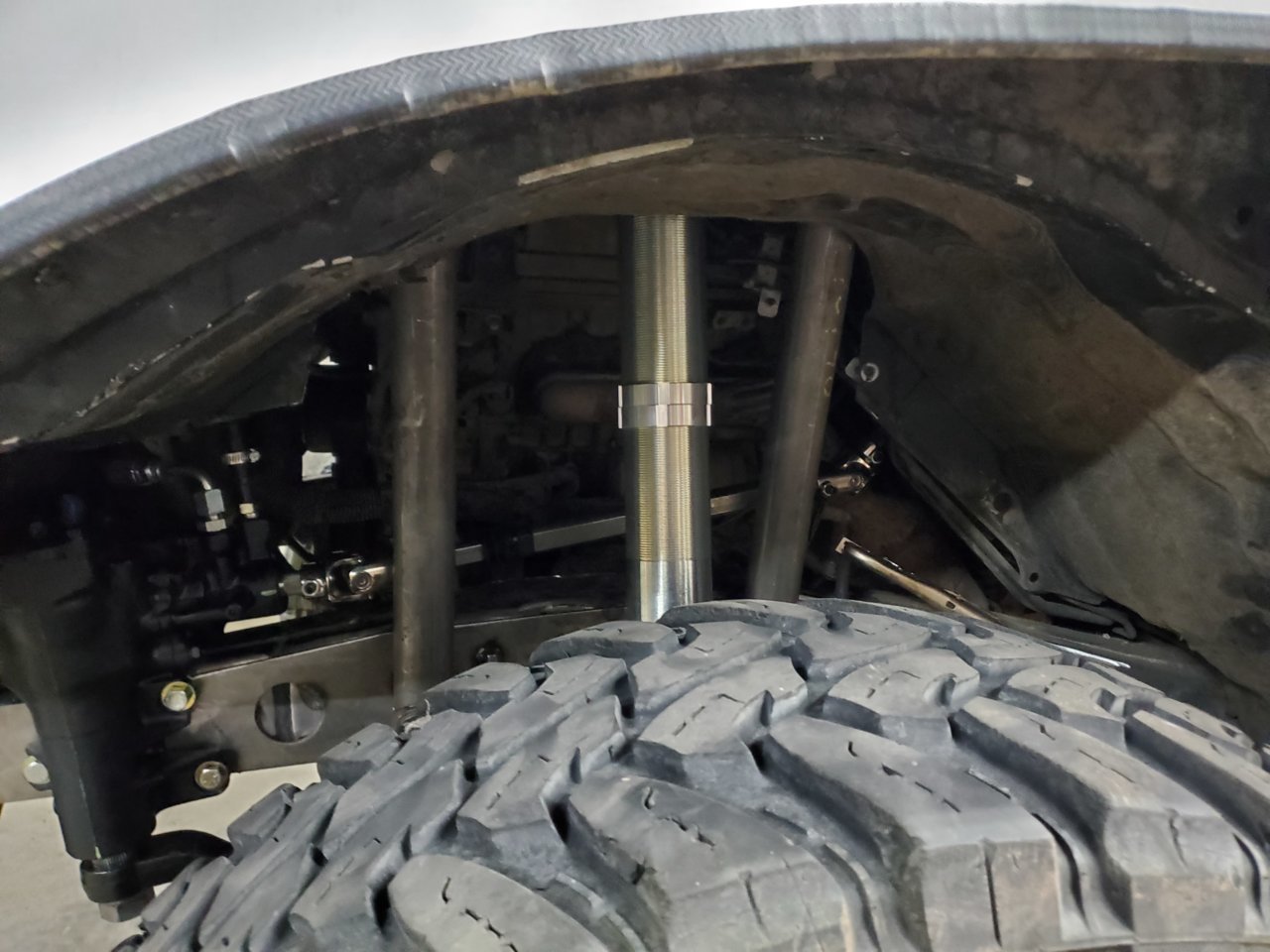

    Also the sprung weight handled by the 14" Radflo coilovers 175/250 rates

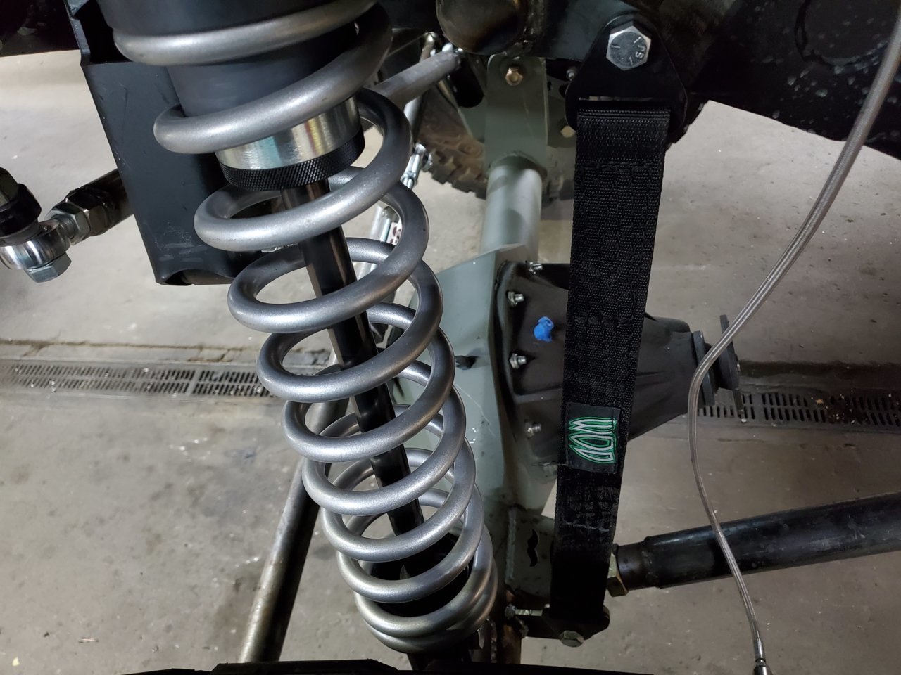

    520
    Brandon
    Frisco, CO
    2007 Tacoma TRD Sport

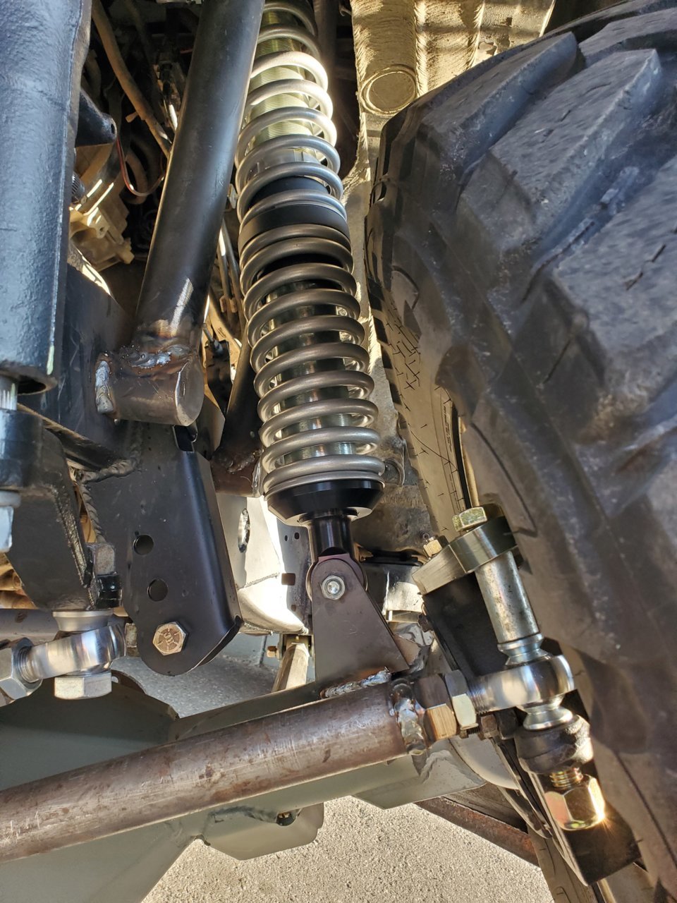

    Rear radflo 2.5 install and doing a great job!

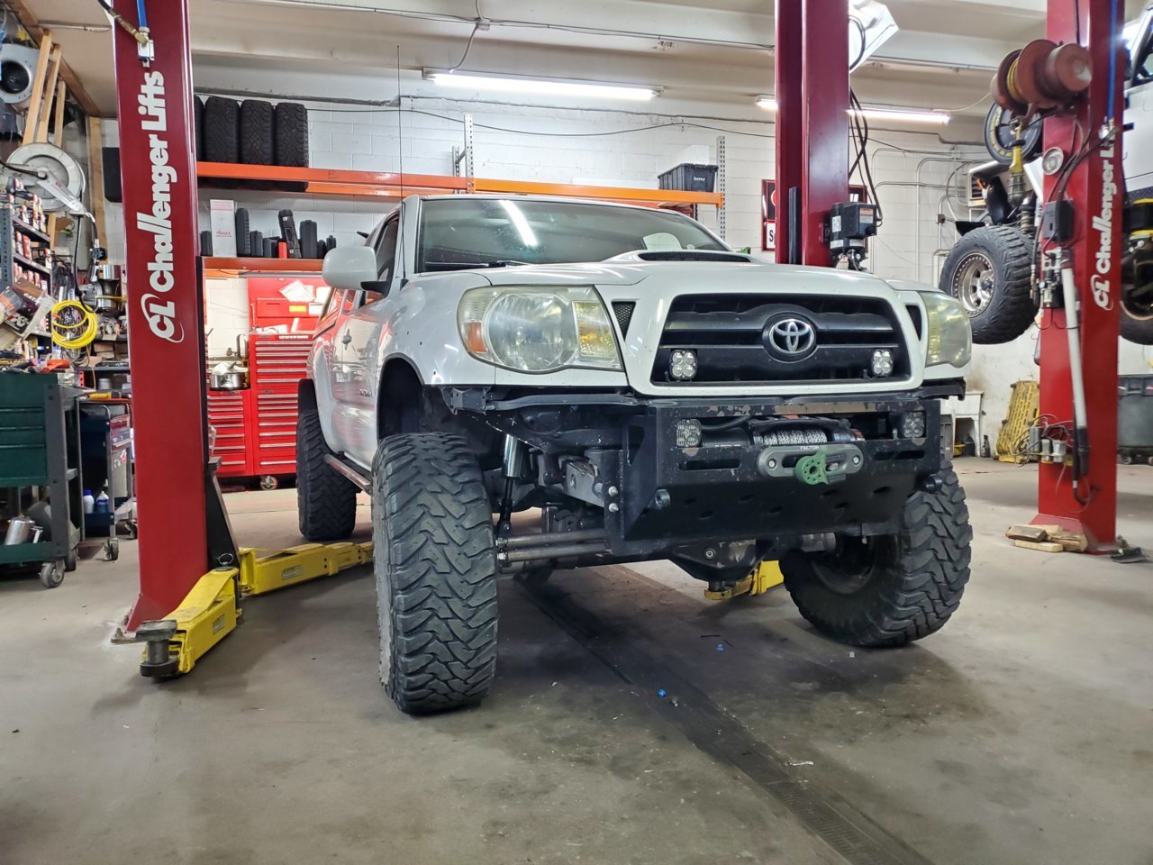

    Brandon
    Frisco, CO
    Finally after a very long weekend!

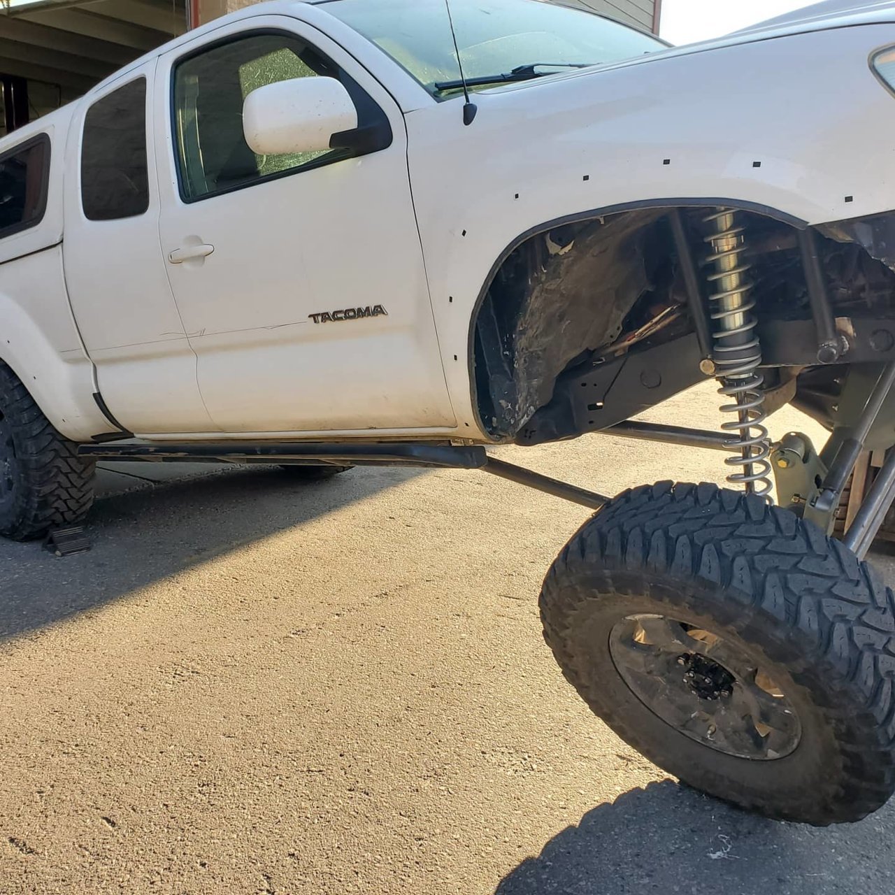

    Got it on the bumpstops, I really need air bumps to get any lower. Kind of sucks but till over the top excited for sure!

    520
    Brandon
    Frisco, CO

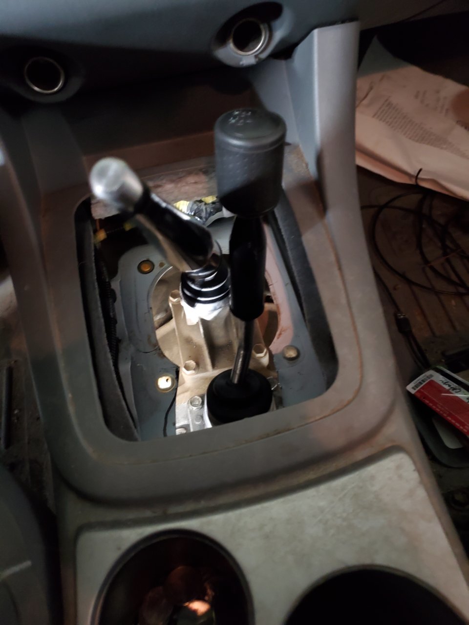

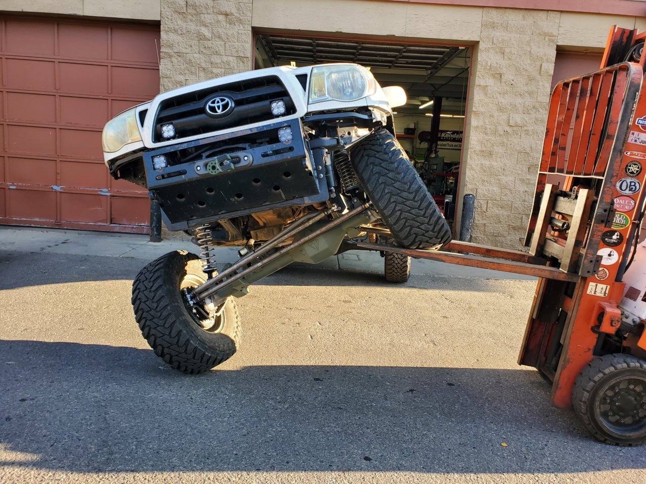

    Welp! Conversion is 80% done..

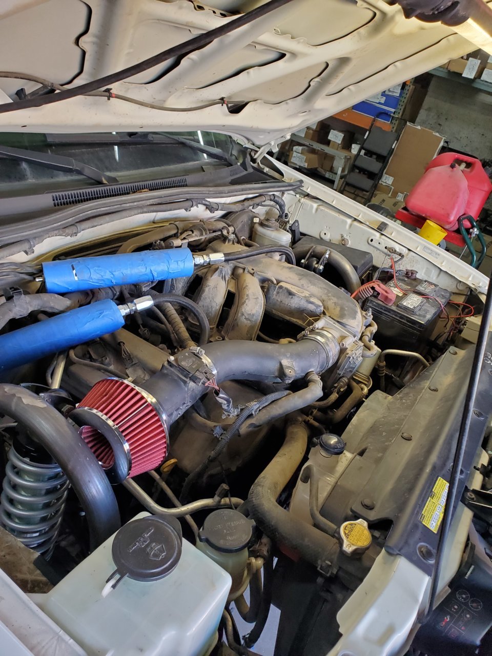

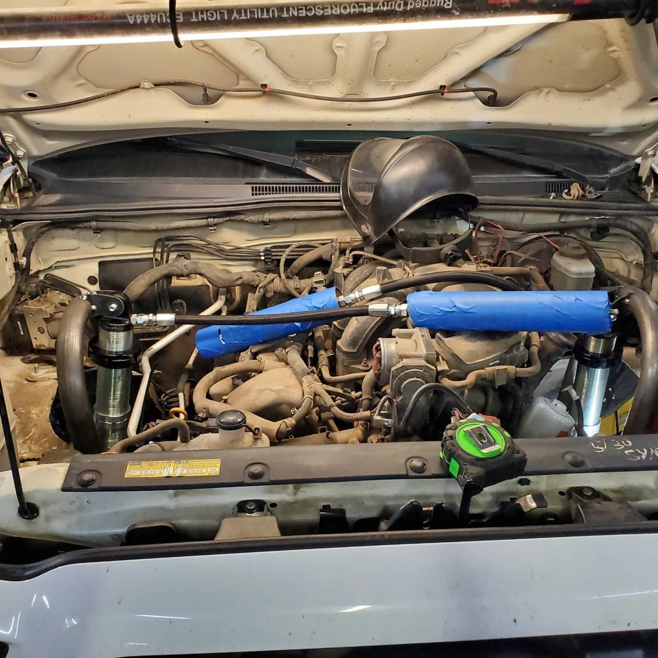

    ToyotaRoamer86 [OP] Well-Known Member
    Jun 20, 2017
    #221993
    520
    Brandon
    Frisco, CO

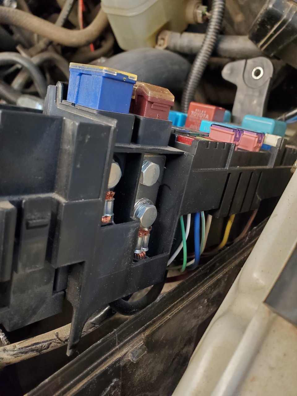

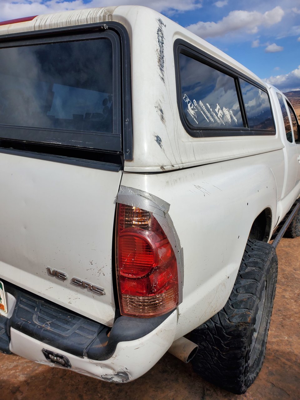

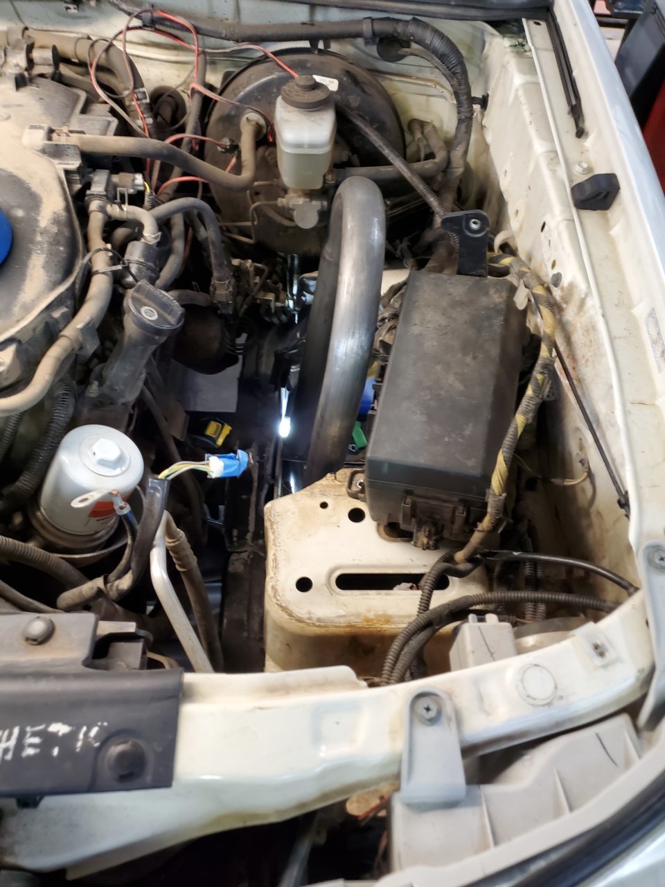

    Sorry for no updates, Been hustling to get the truck done for a company moab trip. The fuse panel had to be reconfigured. Also I had to lengrhen the alternator power cable, also all the wiring from the intake area had to be lengthen. Thanks to a good co-worker it was done in a day. Choped up my knfilters tube and swappd for a cheap spectre for the time being. Im so glad I didn't have to move the battery and all that craziness.

    Jun 20, 2017
    #221993
    520
    Brandon
    Frisco, CO

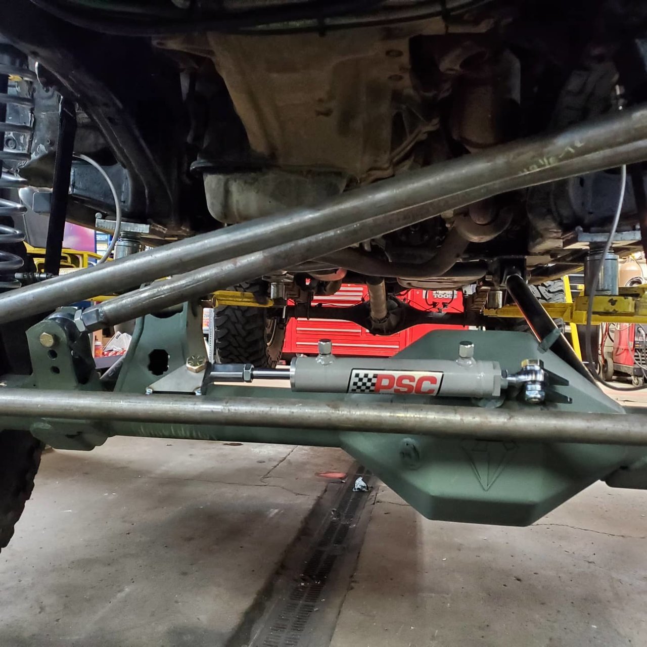

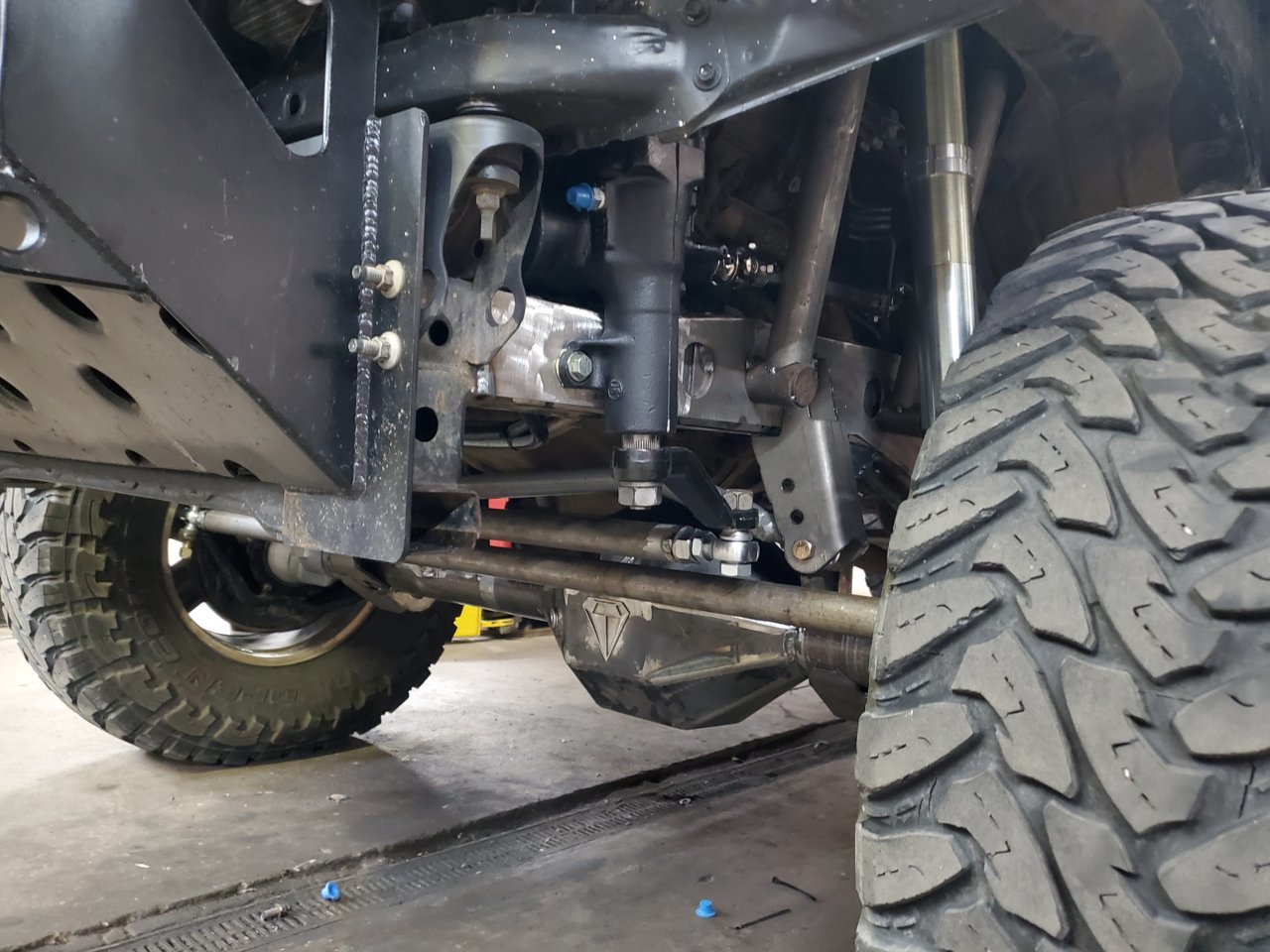

    Have the PSC (project) and steering linkage brace done. Oh yeah! Limiting straps are in place. The new Ruffstuff DOM track bar bushing came in. Their kits are 2" wide, just order a custom size.. not sure why they don't sell them as a standard offering. Swapped from heim/heim as well. To keep the bar from thrusting and taking out my oil pan.
    The green is primer..
    T.Barn and slander like this.

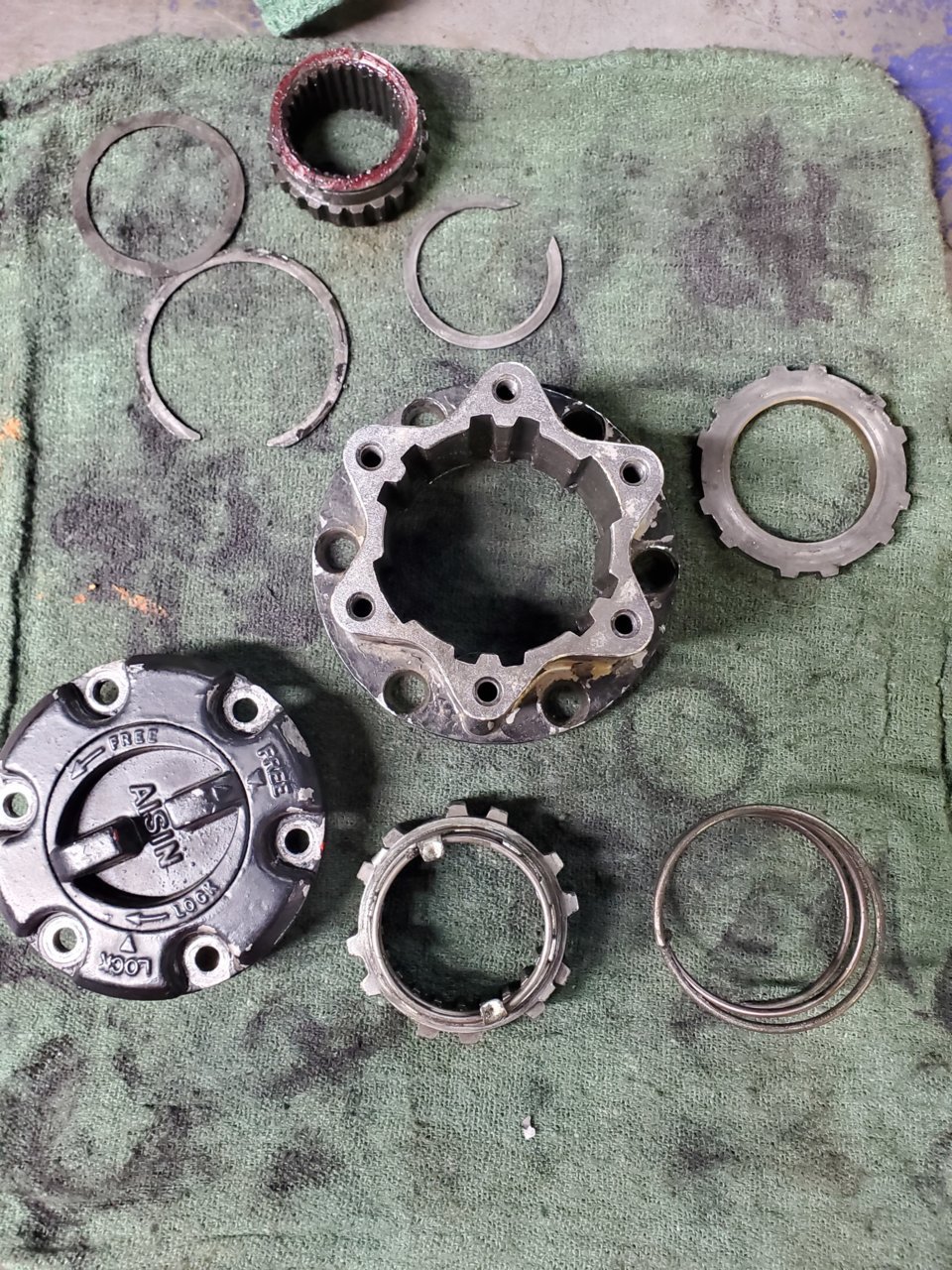

    Jun 20, 2017
    #221993
    520
    Brandon
    Frisco, CO

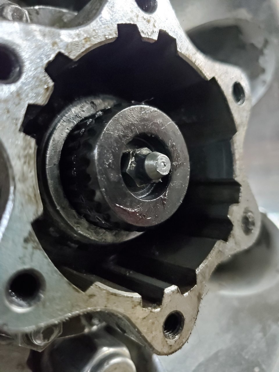

    So I pulled apart my hubs to see why they wont engage.. work great on the bench, bolted in.. locked in place.. Any ideas?

    Nice build!! I think I had that locking problem but forgot how I fixed it.

    520
    Brandon
    Frisco, CO
    The zerk is too long, the hub just locked in place when you tighten the 10mm bolts.

    Loosened up the transfer case bushing bolts a little bit and should help. I have a new double-jointed BORGENSEN to install and move my support down, will work pretty well! Also, my truck will be back under the knife for the internal frame mounted bump stops and engine cross brace for the reservoirs.

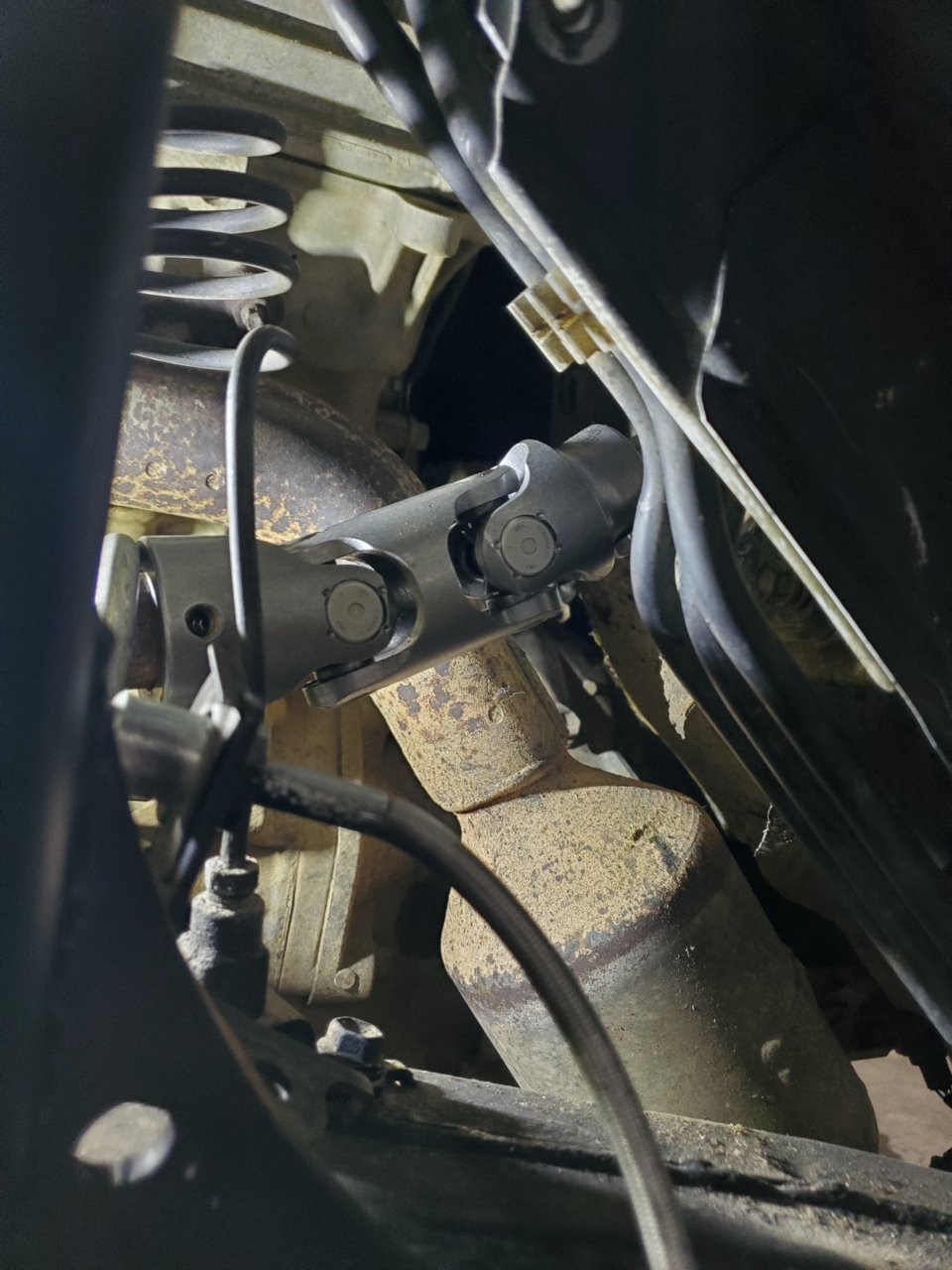

    Welp, Went back to the drawing board on the steering and chopped up the joint at the spline for the column. Back to a single joint and no eyelet. Everything is working perfect.
