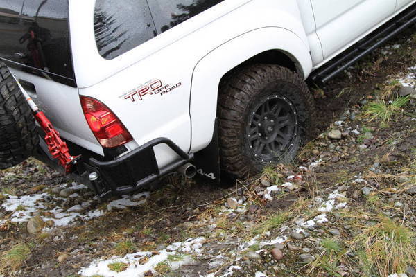

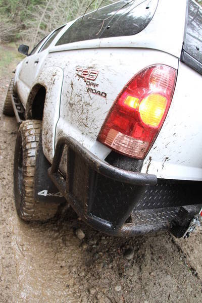

    Next, I surfed around and found Jeff at Badland Bumpers who is squaring me away with sick bumpers! I called up Jeff and asked about a swing away rear bumper and rock sliders. His product is solid and I was lucky enough to provide him with a 2nd Gen Taco to build his jig for a front basher bumper. We're working out the finishing touches (and when I say we, I mean Jeff and his crew), but for now I have the prototype 05+ front basher bumper. As you can see in my crappy night time pics that it is awesome! Of course we had to dress them up with some new lights.
    [​IMG][​IMG]

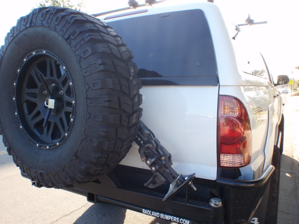

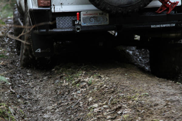

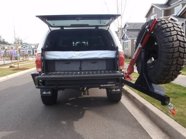

    The rear bumper is just what I was looking for. This is the hunter model, it supports a hi-lift jack as well as the swing away tire mount. It has a locking pin to ensure it stays open when you want it to be. Good sheet metal protection is afforded by the wrap around styling and the damn thing is bullet proof. A 2 inch receiver is integrated also!
    The project will continue as I wire up the lights, Jeff completes the front bumper design/installation, and maybe I will purchase a winch. This should keep me wheelin' for a while until I can save up some more cash. I'll update you all when I can! Let's see if I can get the pics up on this thing??

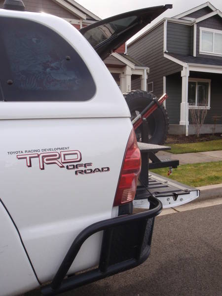

    Pics of the Armor Additions! Here's Jeff's shop and out front of my house in PNW. Nice fresh snow!

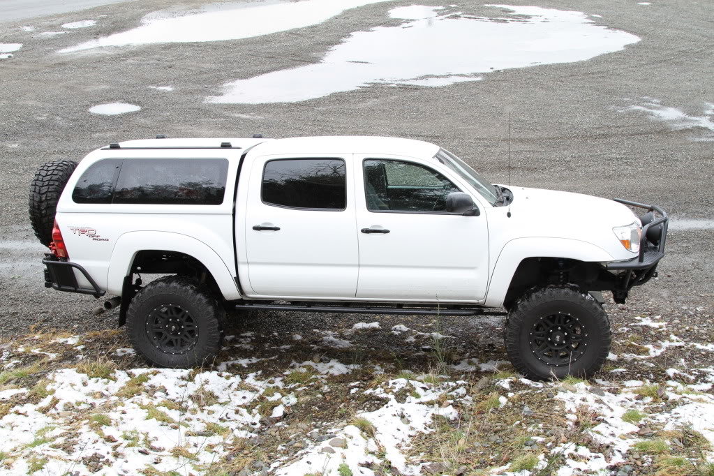

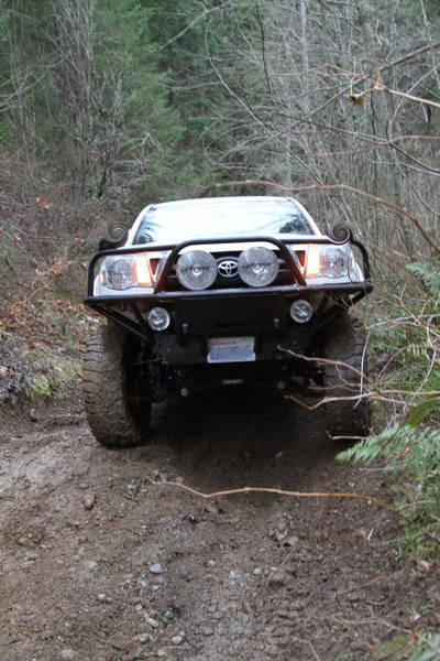

    Went out today to get some photos with my buddy. Let me know what you think?

    I paid $850 for mine plus black powder coat totaling $1000. This is for the Hunter, the swing away tire mount. It's bulletproof, and I love it!

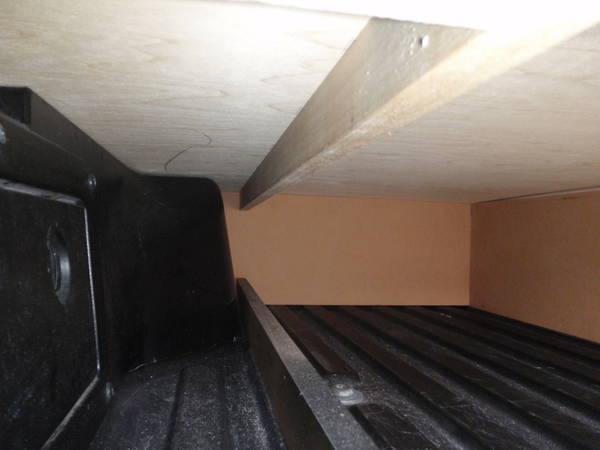

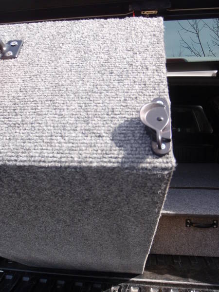

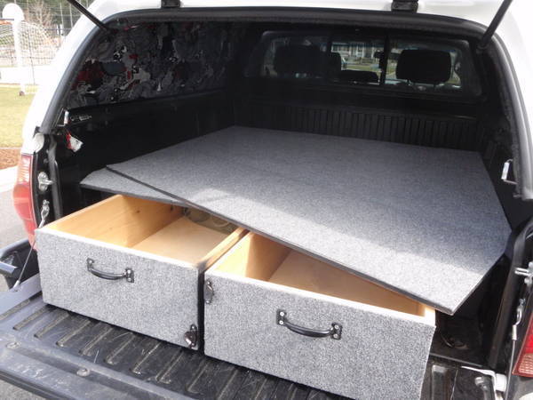

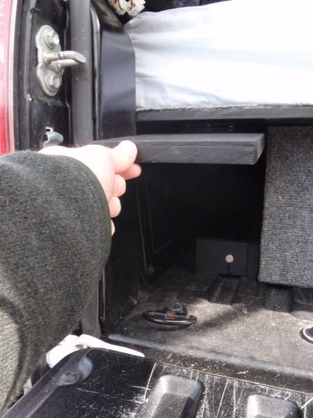

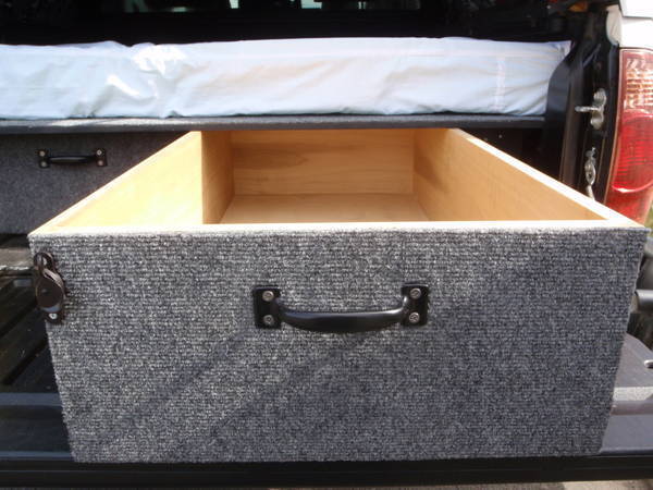

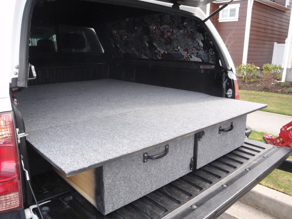

    I took some pictures of my platform/canopy to show how I built the EXPEDITION part of it. I have to thank www.bajataco.com for most of the concept. But getting the inspiration was the easy part.
    The concept is to be able to pack up as much stuff in an organized fashion and still be able to sleep with relative comfort and ease.
    I chose wood for the cost, easy medium, and weight. I am not planning on doing a lot of fording yet, so the water damage is not a big concern. I did seal all the wood to increase longevity.
    Sleeping pads are made out of high density foam with a cotton cover, cut to shape. There are 3 x pieces that stack for storage and provide me and the wife with 75" x 48" of sleeping room. We get 75" by using the extension platform that is placed on top of the open drawers.

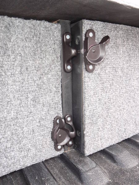

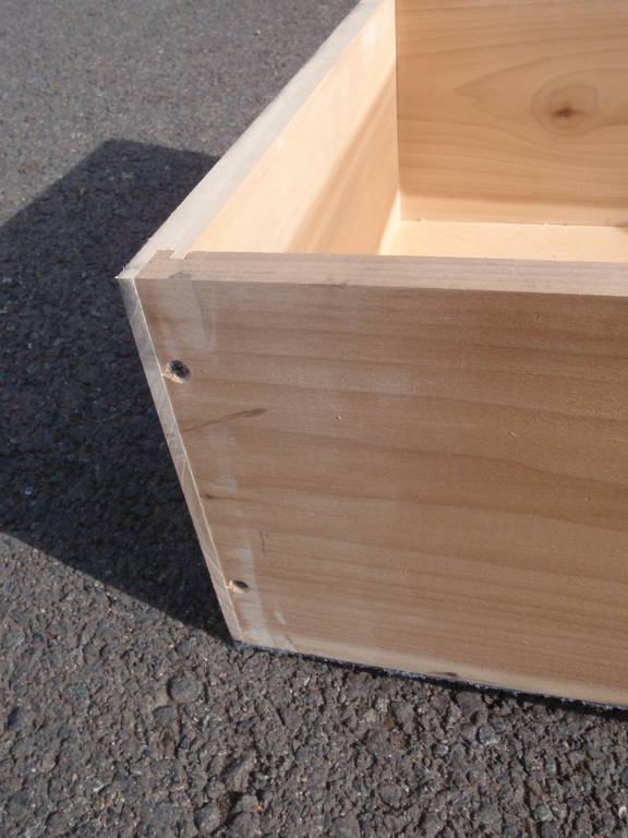

    The drawers were the start point of the design. I wanted enough space to store food, tools, recovery gear, clothes, and / or 3-4 adult Umpa Lumpas (because they're blue, in case you were wondering!). They are 40 x 20 x 10.5" and are made of poplar. They have carpeting on the bottom for sliding, snugness, and sound dampening. I used just basic handles and then I figured out to use window latches to keep them locked inside. Notice the drawers aren't snug against the tailgate.

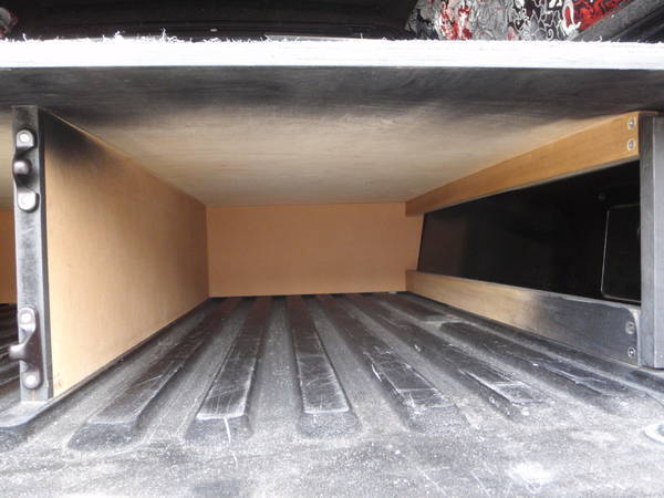

    Forward of the main drawers are additional storage. This is to limit the weight of the main drawers and also to help prioritize the load.
    Once we built the drawers, we built the frame for the platform that is basically a "+". The drawers are on either side of a centerline. The centerline goes to the cab and is fitted to another piece that is parallel with the cab end of the bed. We used poplar for the drawers, rails, and cross members, and MDFB for the centerline. DO NOT USE MDFB (medium density fiber board). We talked ourselves into it and it has no qualities worthy of this project.
    We mounted the platform frame to platforms above the tops of the wheel wells (the squared flats on top of the wheel). We through bolted the platforms on to the wheel well/bed and then attached the platform top to them. The centerline board is through bolted on the bottom of the bed. Then we put side rails on the bed for the drawers, and did the same to the bottom of the platform top.
    We got it all put together and then carpeted the platform top and drawer faces and bottoms. The hardware was installed and then we were left with the two sides exposed. This was to leave access to the 110v plug on the passenger side and the storage compartment on the driver side. It looked bad so we added some swinging doors to provide access and aesthetics. Once completed, some black paint went up. I got some earth magnets and glued them in behind the doors and on the bottom rail to keep them from swinging up and down.

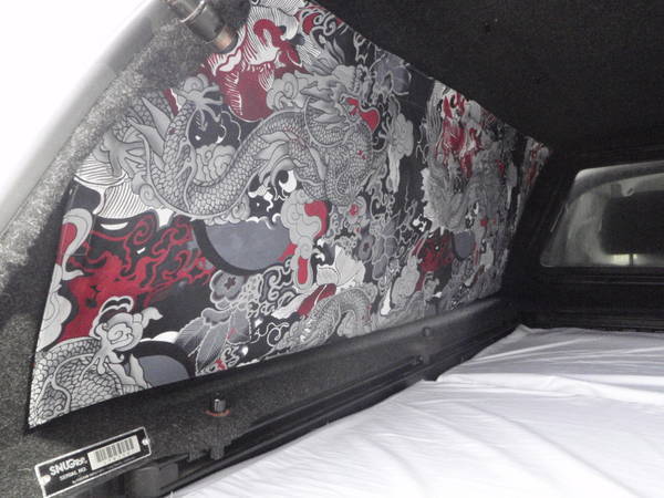

    Just to ensure the sleeping wasn't interfered with by the sun, and to maintain all associations with the stabbin' wagon, we added these sick asian themed curtains. Nice finishing touch I think! These two side curtains have become permanently velcroed up for ease, and there's a third curtain for the back window.
    Let me know what you guys think...

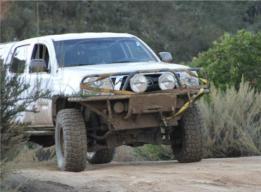

    Here's a picture of the new Badland Bumper's integrated fog light tabs that are welded on. The new bumper came out awesome, I am very pleased with it. Call up Jeff and order one up.

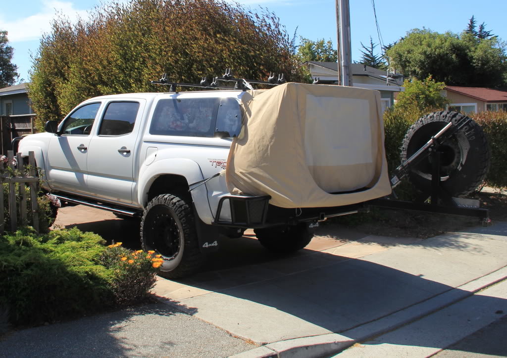

    Since I just moved down here, I'm always looking for some people to go wheelin' with in the Monterey, Ca Area. Drop me a PM.
    Planning a trip to Rubicon next summer. Insight, wisdom, comments???
