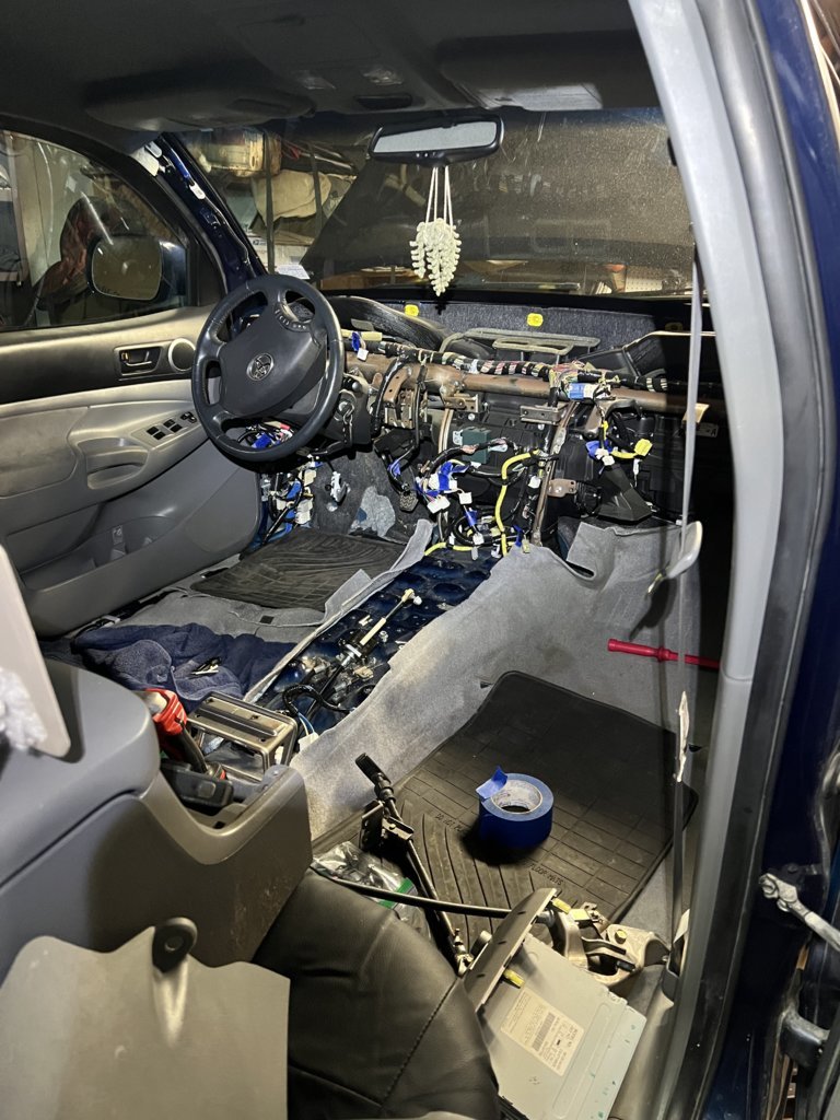

    Dash:
    1. Driver foot well
      • Everything on whole dash is pretty much 10mm, there is a couple 12s and 1 and those live on the airbag mounts and the steering accordingly.
      • Onto actual drivers footwell. first is pop off black footrest.
      • then undo side trim piece
      • one bottom right and other 10 undeneith plastic clip piece you can pop with screwdriver or your nail.
    2. Center
      • Use plastic trim piece to pop the A/C controls
      • After that bolts and connections for head unit
      • center vent piece around head unit pops out
    3. Passenger lower
      • pull out glovebox
      • same side trim as driver footwell
      • 10s for the bottom should be obvious after those
    4. Top dash
      • this is where it gets a little more tricky, take your time here, it does take a little force to get the dash off when all bolts are but you should be able to move dash up and down on clips in back when all bolts are off. There are a some more kinda hidden ones more so than the other parts of the dash. So be more cautious with this part
      • Id start with the airbags (MAKE SURE BATTERY BEEN DISCONNECTED FOR A WHILE BEFORE YOU START UNCLIPPING SHIT) there are 2 12s holding to crash bar. this is part that got me for a little while when I was trying to work through
      • there is a peep hole on passenger side blocked by plastic tab, pop that, then 10 underneith
      • Believe there is some connections around steering wheel or I happened to do them at the same time when I took apart and put together. But check there too
      • You do have to yank the dash to pop out of sockets but you can go from one side and sorta go one by one
    Probably an over simplification of the dash removal but oh well. Its not terrible but not good, so time and labeling help.

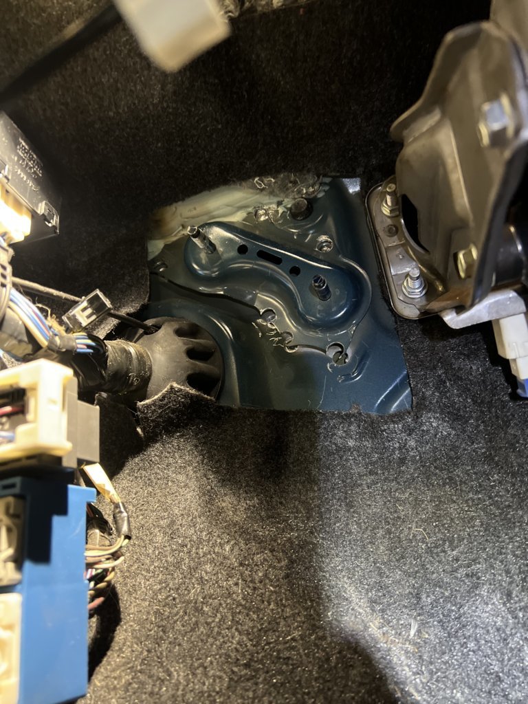

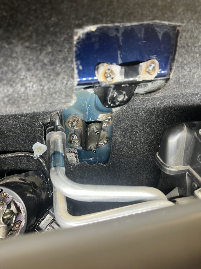

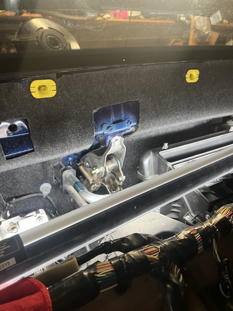

    Clutch pedal:
    1. Measure 1000x! I screwed up the clutch pedal because I changed how I wanted to do it mid way through and then had to change the welded mount which really didnt work
    2. Take your brake booster off. It makes it a ton easier and less scary with drilling and spot welds etc
    3. Take time with spot welds, I burned through one which was kinda a bummer. Had never used that bit before so little weird but if you put a good punch in and take time it works incredibly well
    4. Something I didnt do till after to work on the ac that I would recommend that would make it easier and get some good maitence why you take everything apart is pull center air box, and move crash bar full out of way. Will open a ton of space and make your life so much easier with welding. really wish I had done this. Its only a couple bolts more and the peace of mind trying to weld in a much easier space would have been so much better. Definitely would do this if i were to do it again. Photo below to show the difference.
    5. Clutch pedal mounting
      • I started thinking I was going to riv nut the firewall for the mounts and then switched to stealing the OEM bracket, which I then had to switch the top mount that I used and ya, Ill show the photo. One piece i am disappointed with in the swap. Photo below will be obvious why. Burned holes and then impossible to patch for my skill set
      • Also good to note, a dremel with a sand/grind bit is clutch for this, pedal I didnt prep right either b/c I didnt have one yet and boy it made it soooo much better. Get one, don't consider otherwise
      • Id start with fire wall studs (not way I did it, and why I think it gave me problems) makes it a lot easier for top mount and the firewall is pretty obvious where they go. I also included photo below of oem mount, so if you need to make one, it makes sense. There are indentations where the hoses and studs are supposed to go so it makes it easy
      • This is one of scarier parts of swap with drilling and welding but is actually pretty straight forward. Its not bad if you take it chill and avoid panicking that your car is totally apart and you dont know what the hell you are doing and you have to put back together and you could fuck it all up very easily and your doing this all because some dude had to come up with this crazy invention that is super impressive but it just negates having to use a clutch and is pretty dumb honestly. If you avoid thinking about that not bad.

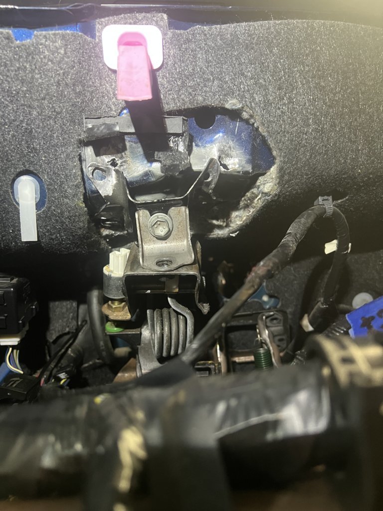

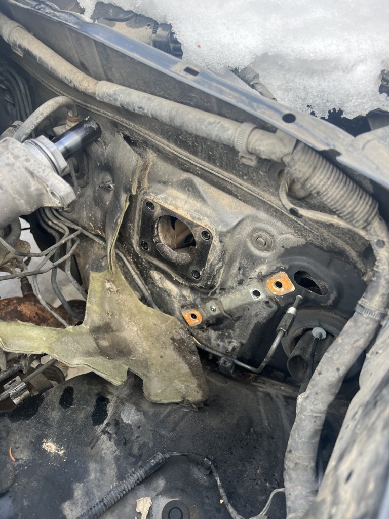

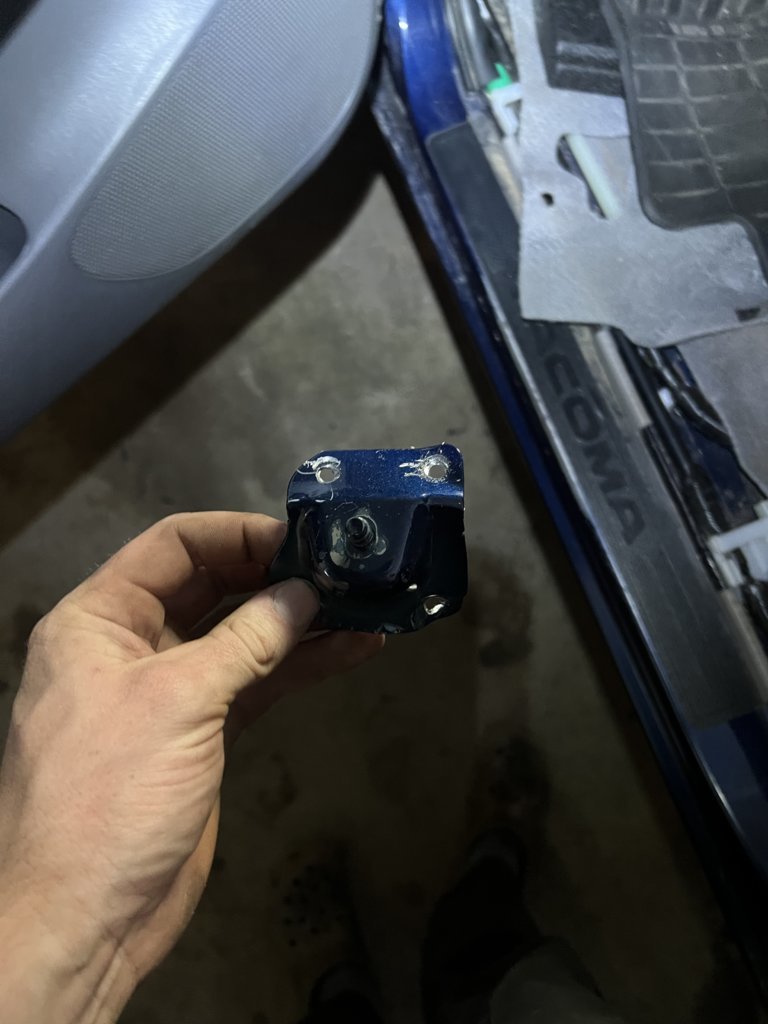

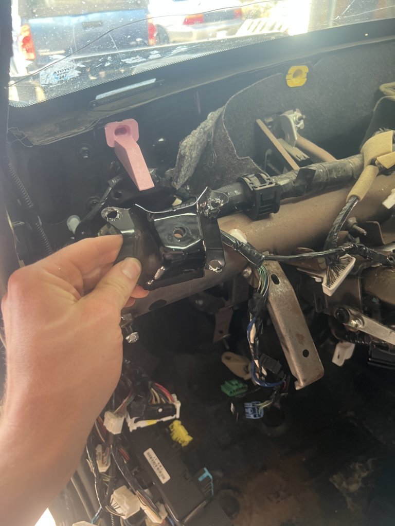

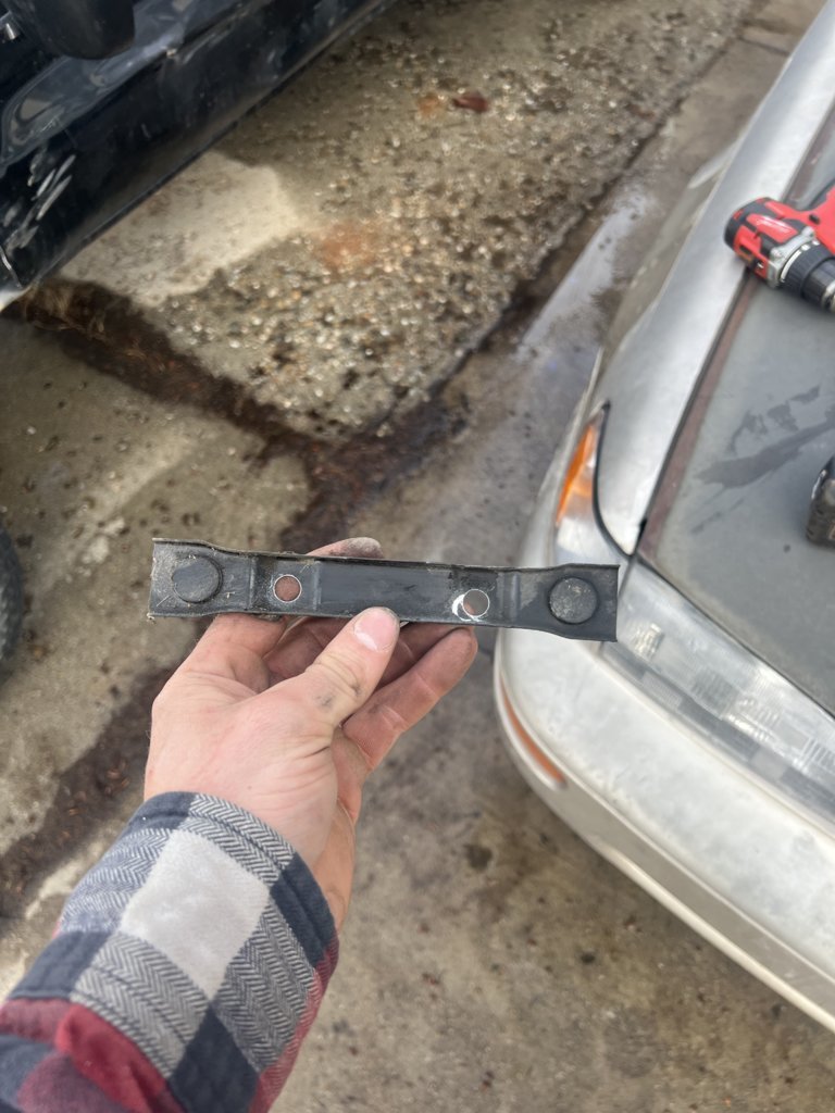

    Ebrake:
    learned a lot from the clutch pedal so this part went quite a bit smoother. Dremel and more prep helped. Had I moved crash bar all the way out of the way, would have made so much easier too. Crash bar seems intimidating but its honestly not that many more steps. especially considering, if you are changing ecu too, which you SHOULD, its basically the bolts againgst the doors and one under the windshield wiper screen thing. And then the air unit you just have to disconnect from lines at that point (reminder to drain lol thats kinda important)
    1. Very similar to clutch pedal process and if you remove crash bar and air box to do this. Routing the ebrake line will be easy as hell too. So one more plug, pull that stuff, makes life so much better.
    2. Included photos of the brackets. There are some indentations on fire wall but harder to follow than the clutch pedal. Crash bar has the mounts for ebrake, so while that is on I would recommend mocking that up and then mount. But once airbox and crash bar are out/moved, its very easy to move crash bar back and forth into place.
    Some of the photos of old ebrake mounts are in clutch post above. I dont believe you can reuse anything, maybe the foot top ebrake stud for the clutch but I didnt try.
