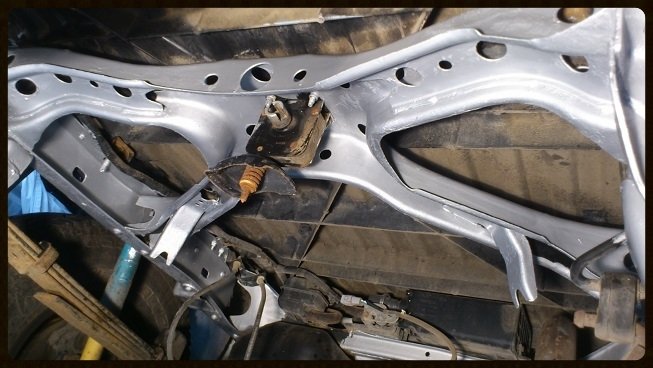

    Currently working on the frame of the truck and prepping it for application of Rust Bullet, but Fluid Film is going on next.

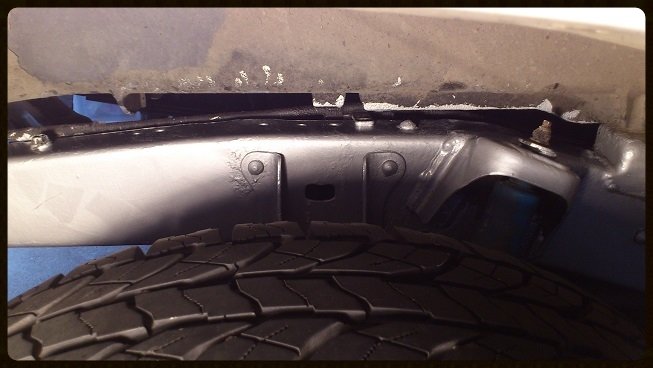

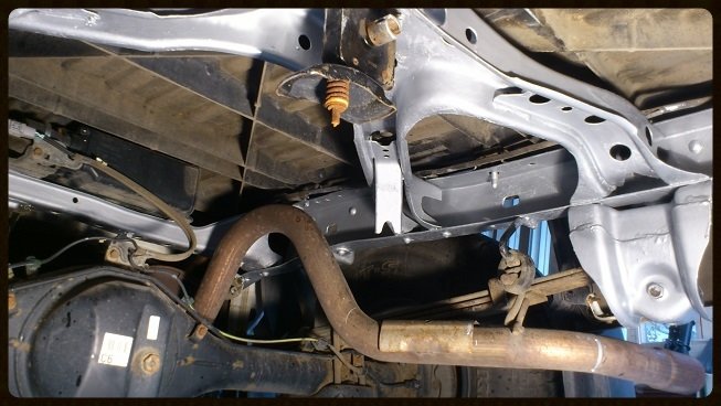

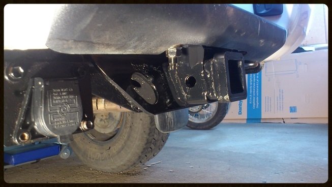

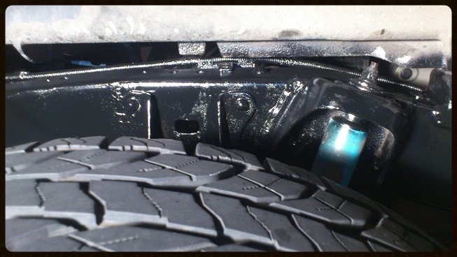

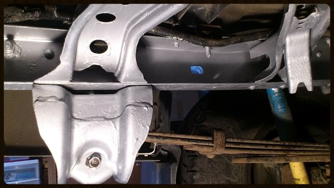

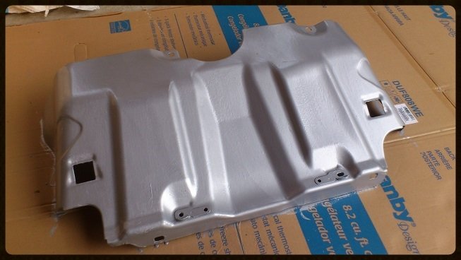

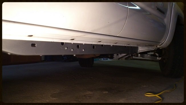

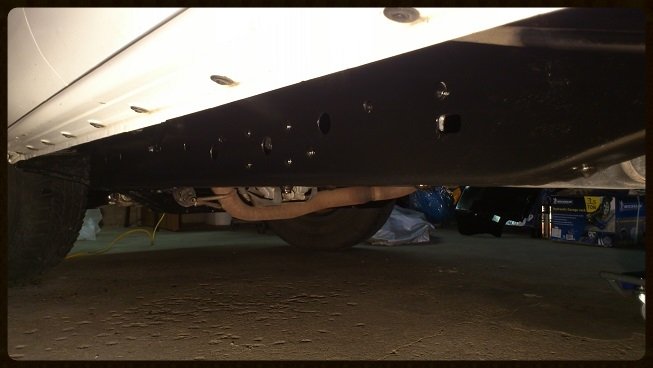

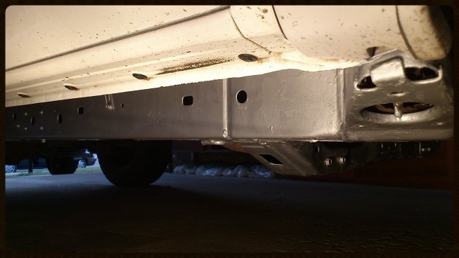

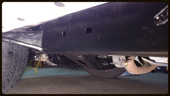

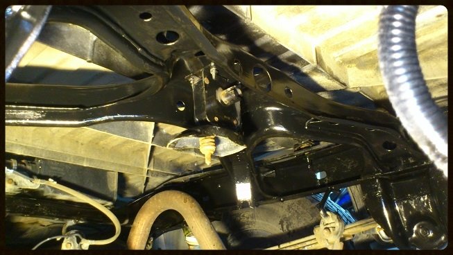

    Rust Bullet & Rust Check Rust Paint as top coat.
    Did not get a chance to brush on Rust Bullet BlackShell as top coat, but instead sprayed a few coats of Rust Check Rust paint. I needed a quick solution as the weather was deteriorating and BlackShell required 8-10 hours of drying time per coat. Fluid Film is going on next.

    Nice job kryten! You went whole hog on that frame, that must have taken quite a while. I sprayed on my FF and I finally feel I can take a sigh of relief that this job is finally put to rest.

    Yeah, I tried to cover as much as I could reach. Lot of it was still factory paint in great shape but I decided to just cover everything since I spent so much time under the truck already. Unfortunately, I was not only running out of time with good weather, but 1 quart and 1 pint of Rust Bullet did not seem to be quite enough. My second coat was kind of half-assed so I'm a bit disappointed there. Hopefully it will be good enough, especially since I applied top coat and fluid film is going on soon.
    So in summary, I wasted $70 of BlackShell, but at least I did not open it so I could still use it in the future. Spend 10x more time doing this whole ordeal than I planned to or wanted to and as a result ran out of good weather and time. Still, I'm happy that it is mostly done now and I'm sure it is better than not doing anything and letting the rust spread.
